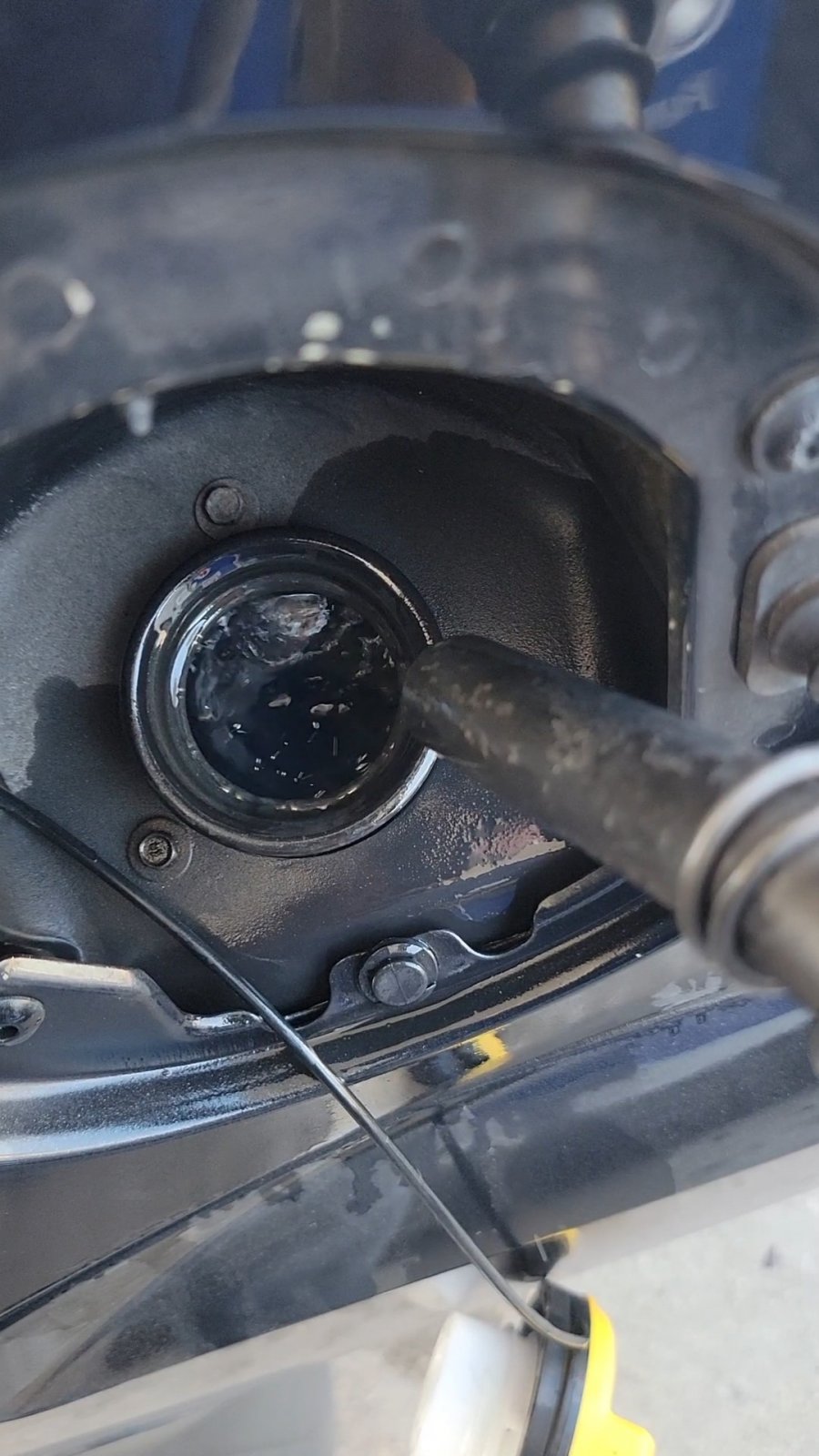

Folks i am having issues with filling at gas pump. To the point of gurgles at filler neck for 3 minutes. I recorded a video but can't upload it here so i did my best to provide a picture. Parts that have been replaced are gas cap, charcoal canister, vapor canister vent valve and purge solenoid. Any idea what could cause p0455 and issues filling up?

With all that replaced the lines on the tank could be plugged from the bad canister. You could also have a bad FLVV that is in the fuel tank which could also be the reason you can't fill the tank properly.

You covered everything, but the likely cause is residual carbon pellets in the tank & lines or a pinched vent line that may have been routed incorrectly after a recent, corresponding service.
You’re going to have to pull the tank if you haven’t yet. You’ll be able to blow out all the lines, wipe out the tank and replace the pump that’s likely getting clogged w/ pellets intermittently.

Yes, like @zbad55 and @petethepug said, likely problem with the lines being clogged. Would help to know what you are driving.
In so many threads about evap system problems, I see people replacing a part here and a part there and then in the end, the whole system is needed. I just bit the bullet on my rig and did the whole system at the same time. I was not having problems but knew eventually likely would and while I was doing all the other work in my build thread, I just threw money at it and did the whole shebang. Good luck. Perhaps just blowing the lines out will do the trick.

The vehicle in question is a 2012 Tahoe LS. To be honest it is driving me up the wall with this issue. No issues cranking or the like, just filling up and the check engine light with P0455.

OK The reason your are having the fill issues is because somewhere you have a blockage in the system. When you start filling the fuel tank in needs to evacuate the vapor/air in the system in order to put the fuel in. The way these systems work now is to push all the vapor into the vapor canister so as not to expel the vapors into the atmosphere. This is known as ORVR (Onboard Refueling Vapor Recovery) this is just a basic explanation as there is a lot more to it. The best thing you can do when you get it fixed is to not overfill your fuel tank, 3 clicks off at the pump then stop.

The others here are 100% right. You have charcoal pellets in the vapor lines and they need to be blown out with compressed air.
