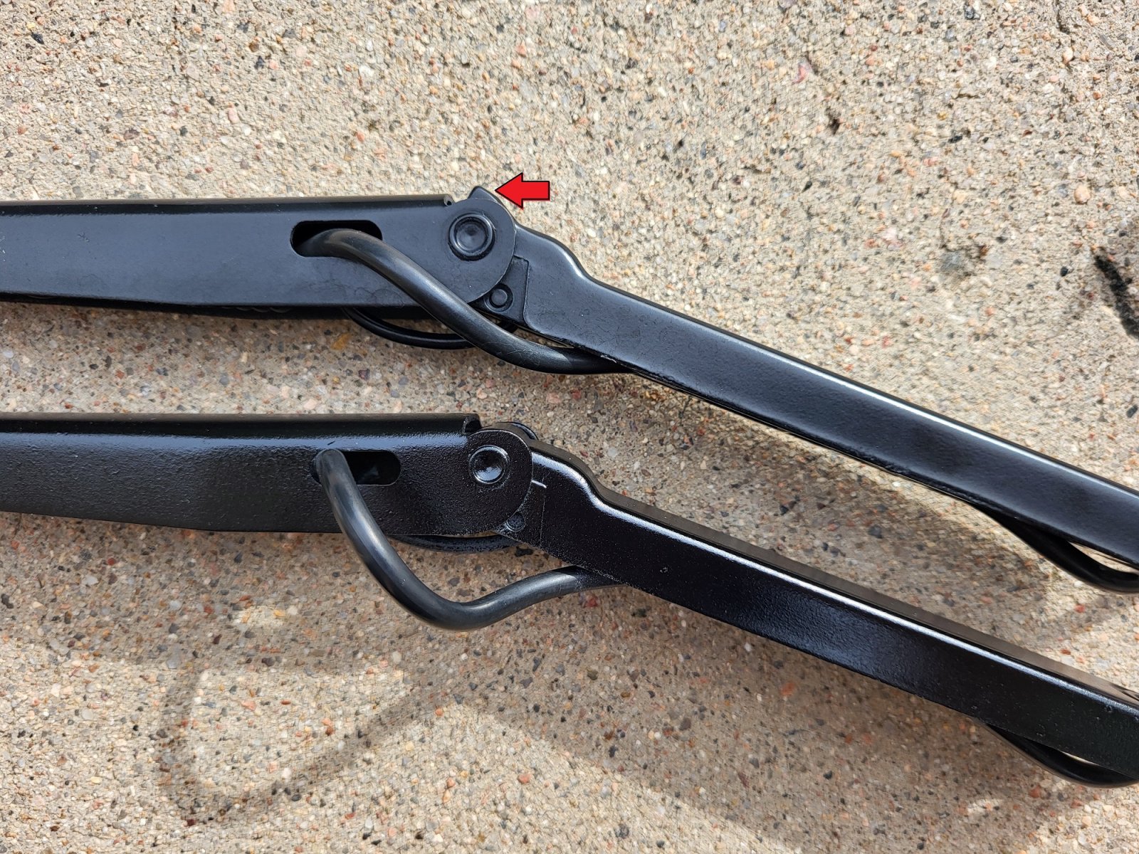

I painted the ones I got off a Upull Suburban, 2001 I think it was, and installed them this evening. Here's the difference between the older style and the new (2004 GM OE new on top; note the large hump that stops the arm from being able to get far above the windshield). I can't tell if the hump is solid and you could grind it off, or if that would leave a hole.
Other than that hump, there's no difference between the two. The driver's side had two squirters and the passenger side only one.
I'd bet they're solid. No 'hole'.
