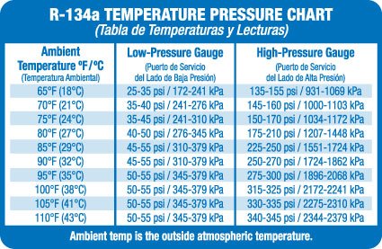

Not unusual for temp to rise while sitting at idle in that high of outside temps. Especially if the vehicle is sitting on Asphalt. Im not sure what a "little warmer" means on the a/c so I cant speculate. You should see atleast a 20 delta between the outside temp and the air coming from the vents temp(A/C). How do you know the refrigerant is full and no leaks? Do you have pressure readings?

As far as no leaks I was refrrring to the coolant from the reservoir, water pump, hoses, thermostat. I don’t have pressure readings. But yeah I was on asphalt and I guess the idling fan doesn’t push enough air on a hot day just sitting around for that long. I took a trip around the block at maybe 10-15 mph and that did it
