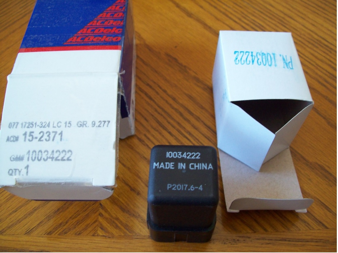

My experience with a fuel pump relay. Critical part, wanted the best, ordered the AC Delco part with the OE factory part number. What I got:

From what I searched that IS the OE factory part, sadly. Or at least it looks like it. Everything is made in China. They get an E for presentation for sure. Did the relay work okay?

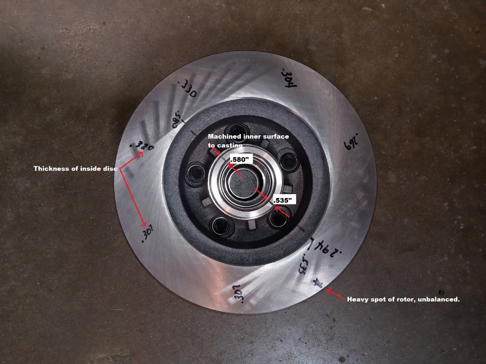

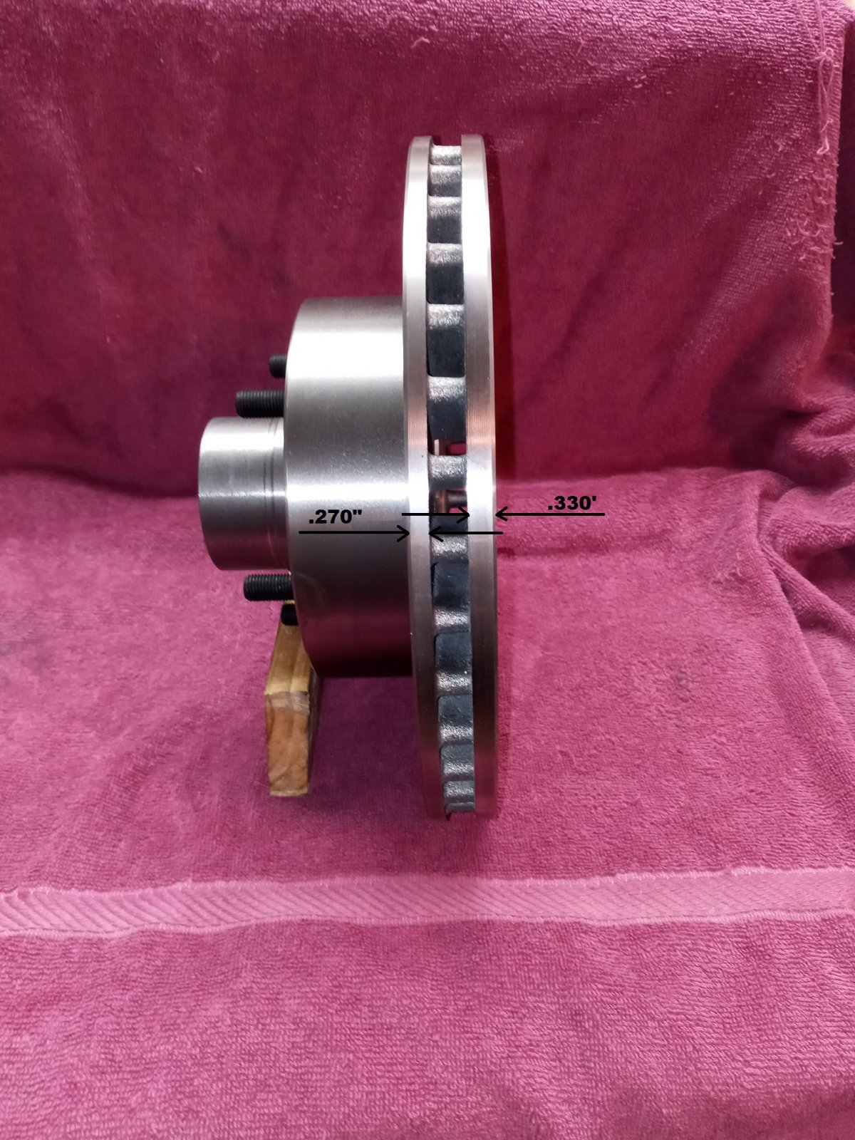

Did a complete brake job on my old truck last year. Pads, rotors, hoses, shoes, drums, hardware. Wanted good stuff and looking for low dust pads. Went with AC Delco for all parts. Wasn't impressed with these rotors:

there are lots knockoff autoparts out there especially ac delco, always try to purchase from a good source, dealer, well known store, etc

When you see how fast they slam these thru Lathes in factories with low paid labor etc, you'd understand the last thing they are worried about is balancing the machining to the raw casting. The machine is set to cut exactly the same thing over and over, and the casting can vary, be loaded in the chuck improperly, or the chuck could be full of chips and the part is not seating in the jaws. Plus, cast iron is some of the nastiest crap out there to machine both for operator and machine itself....

On the relay I would have liked to pop the cover off and check the size of the contactor pads, new vs old. Didn't want to risk cracking the plastic and killing any warranty if it didn't work for long. Is working ok at this point.
