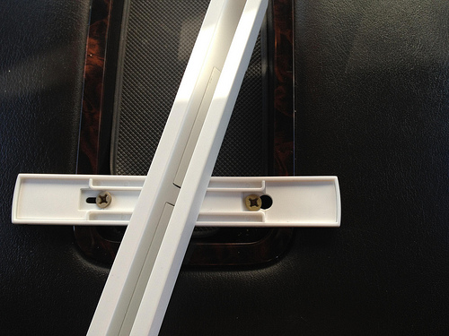

2. I then removed the rubber flap in the center of the console and also removed the two screws near the rear of the tray. I then placed the mount over the two screw holes. I grabbed two new screws that were longer and proceeded to fasten the mount to the center console. I had to go at a bit of an angle but the screws did grab nicely.

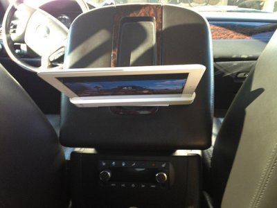

3. This is what it looks like after the screws have been fastened.

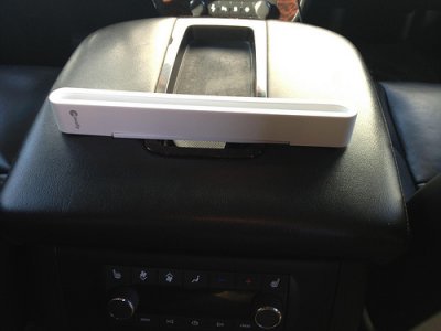

4. Here is the finished install

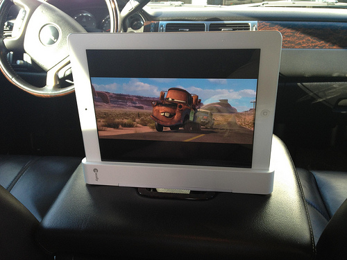

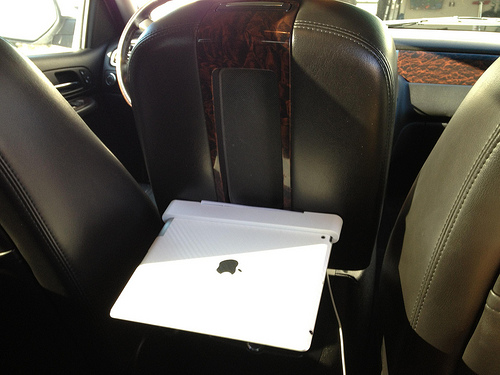

5. Since the mount is magnetic you can still open the center console and grab stuff and the iPad stays intact!
attachment.php
attachment.php
I just got back from a 1 hour long road trip with the kids and they loved it! It hardly moved when on bumpy roads. I was able to comfortably place my arm on the armrest without touching it (I am a big guy too). I plugged in the aux cable and had the kids plug in their headphones to the rear audio controls and they enjoyed watching the movie while my wife and I listened to XM radio up front.
