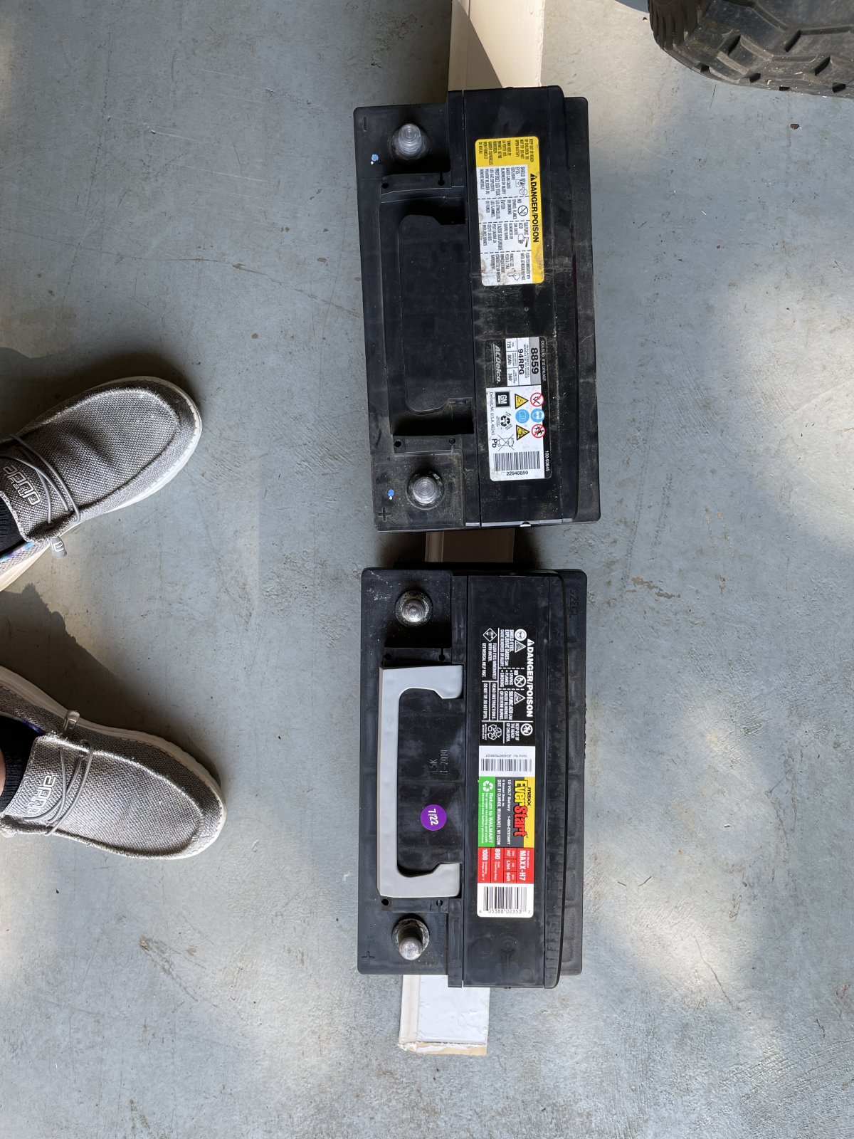

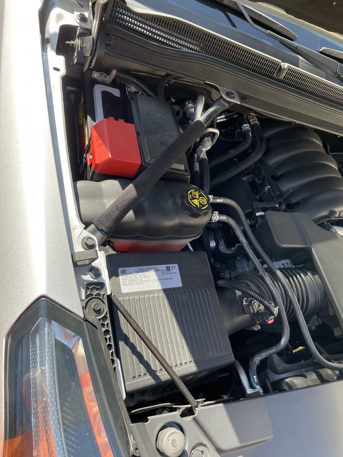

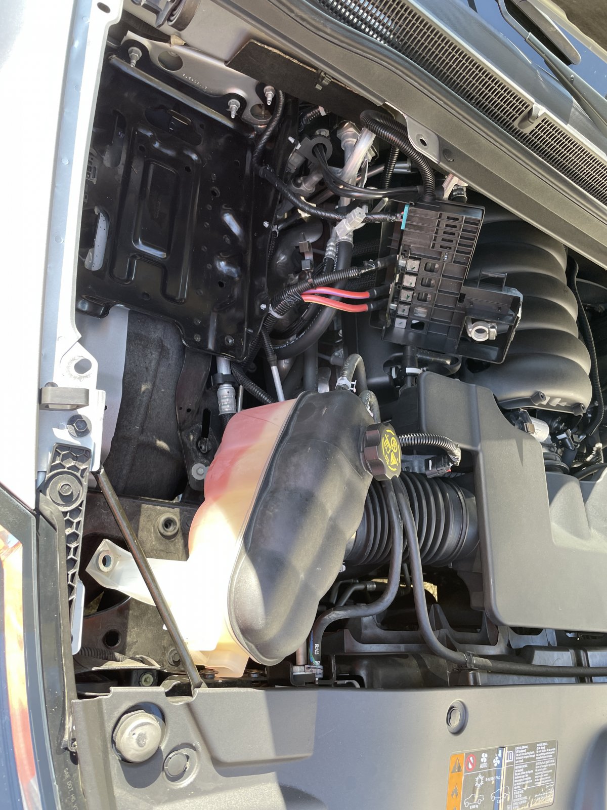

I replaced mine with Everstart maxx. Same exact battery as the ac delco I removed, just different sticker. Nothing needed reset. Like a few have mentioned, I read that these trucks aren't the best suited for agm batteries because the way the charging system works.
I had to take a lot more things apart than some but I got it done

Just had to replace the battery in the 2015 Yukon, went with the Duralast Gold, nothing needed to be reset. But I will say this, the original battery did not have the handle on it and it made it a real PIA to remove. The new battery with handle made it much easier and dropped right in, $211.00 Total
