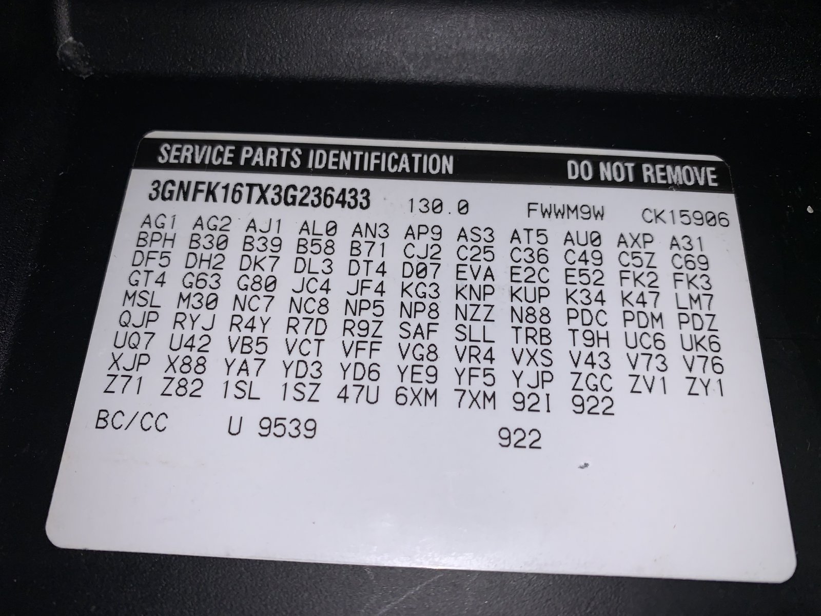

We recommend that you put all your rig(s) info in your signature so we all don’t have to guess at year, make, model, engine size, trans, rear axle locker…….etc. While you may have posted pertinent info in your first post, you may forget to do it again and the info is needed by us anyway. Makes it way easier on all members that attempt to help, to have that info right up front. It is also recommended that you take a pic of your RPO codes, on the inside cover of the glove box, and post that image in your signature. All this info will greatly help those that will try to help with a problem.

May be funny but it almost sounded like a coffee maker brewing with the windows up and was thinking maybe a blend door, then with windows down sounded more like a gravely grinding noise but just every once in a while and at the end of a long drive. It’s 4wd and GT4/G80 RPO for rear end. Just finishing service on rear diff and only normal amount of shaving dust on magnet for 148K miles, gears looked new to me an nothing floating in oil or metal chunks
