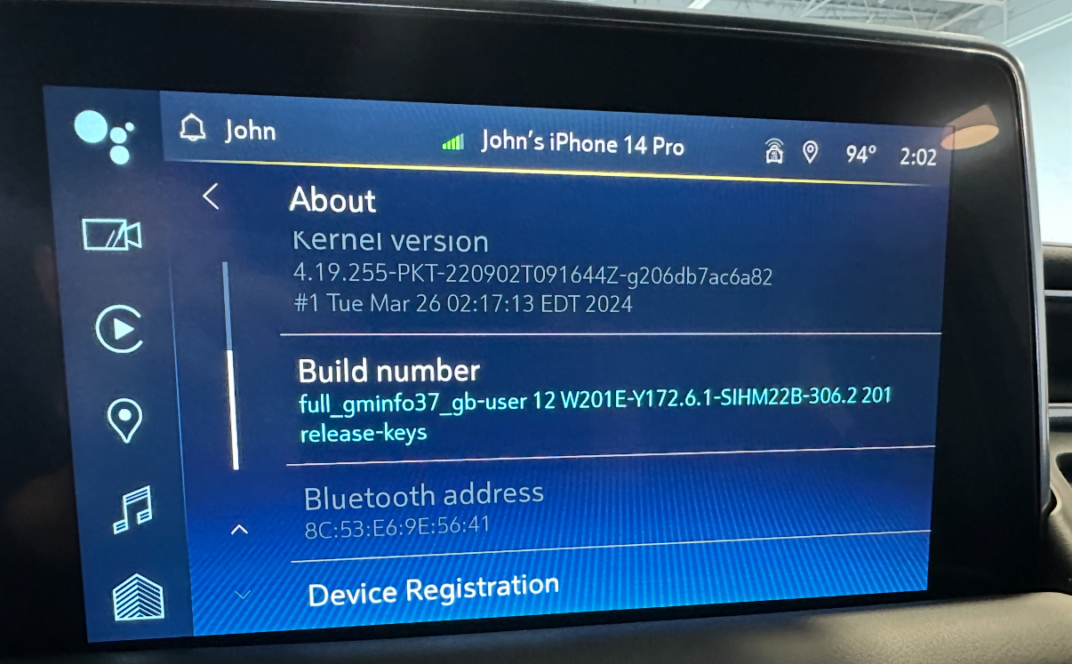

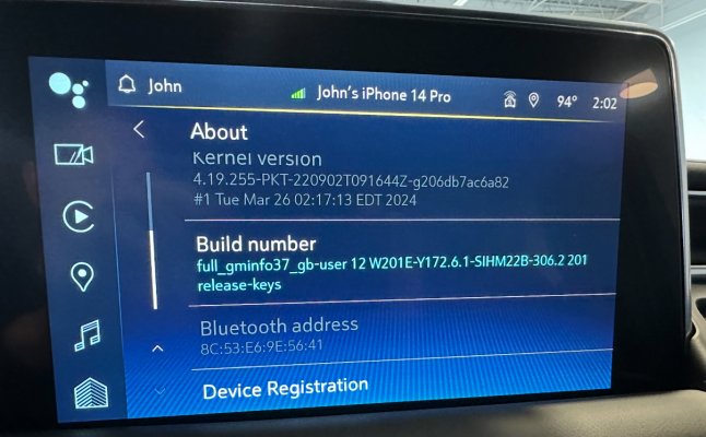

Hey perhaps I'm too late to this thread, but my 2023 Yukon Denali does this too (Radio cut-out). A while back at the Dealer, they did the Radio Serial update, however it still happens. Radio cuts out within the first 1-2 minutes, then appears fine for the rest of the day. I've had the radio on FM and/or Sirius -- same result.
On my Info screen, I'm unsure how to see the current version I'm on:
About:
Model & Hardware: gminfo37
Android Version: Android 12
Android SEcurity Patch Level: February 5, 2024 (Dealer visit for update was way later than that)
Previous Updates 85747470.mnf SIHM22B-00306.02
Importantant Update: N23-2411560
Check for Updates, found nothing.
What's next, or what can I do?

I’m not aware of anything else that you can do, other than keep getting the software updates at the dealership whenever they are available, and hope for the best. I believe Y172 is the latest, but I could be wrong on that.
