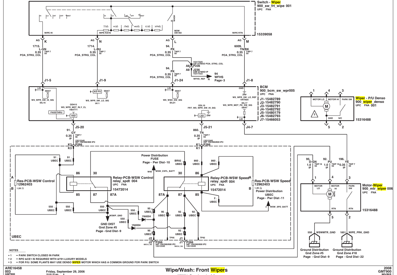

intermittent issue, windshield wiper stops working.
fastscirocco
Feb 21, 2019
78
75
Is there a computer module for this or is it a failing switch?

Relays on fusebox pcb.. Not saying that's the issue, but could be..
Yup, wouldn't hurt to swap some relays around to see if that is it. Or to check the blades on them for corrosion. That's how I found an intermittent crank issue that popped up on me back in January. I replaced it with a new one and knock on wood it's been fine since.

Unfortunately, I think these relays are likely soldered into the fusebox.

I believe I have found the cause of the many electrical gremlins I've experienced, tonight I found a very loose ground wire on the firewall. I cleaned the connection and tightened it. I will be doing over 5 hours of driving tomorrow and will report back afterwards. Background I had recently replaced the brake pedal position sensor and the wiper/turn signal stalk, and continued to have issues.
