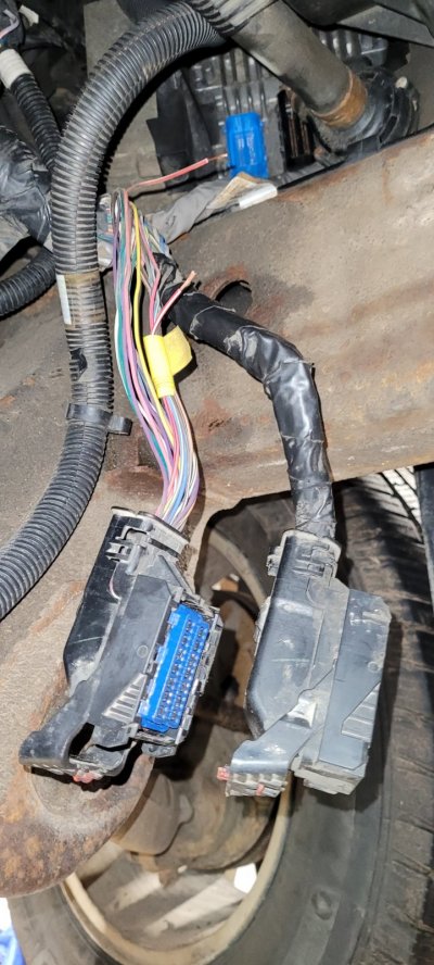

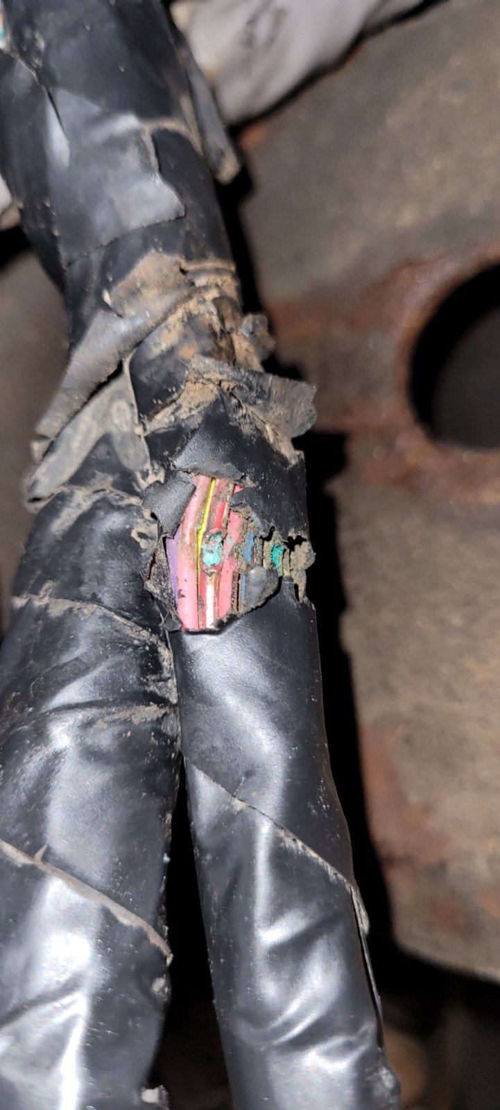

Same problem just fixed yesterday. Under the lower fuse box between the 12vbattery and the radiator is the ECM. connected to that is a blue multipin cable connector. Cable has 16 #22 wires in it. The cable routes straight down across the frame and into everywhere else. My frame had rubbed through the cable insulation and about 6 wires. The battery positive voltage wire (Red/Wht) was shorting to the frame. Several others were rusting out. I imagine if you did the ECM already You would have seen it but doesn't hurt to check.
Good Luck!!

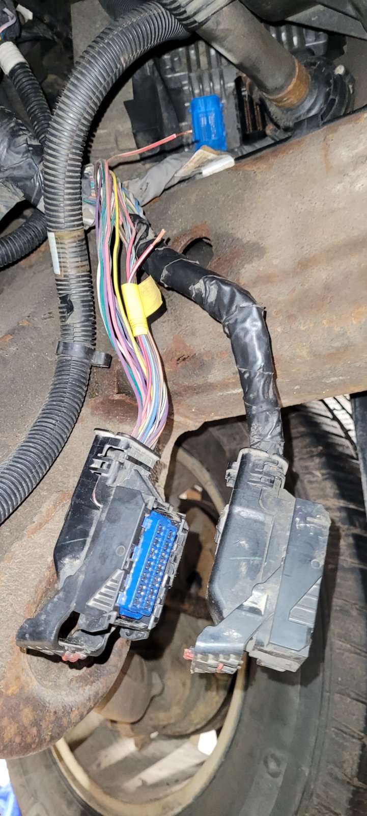

I had several different U-codes. Engine was shutting off randomly.
The wiring is accessed from underneath the 2009 tahoe hybrid. The hybrid stuff is all on passenger side of motor. Remove bunny thumper and it's on the driver side just behind radiator over frame
I fixed it with sealing butt splice connectors and wrapped the shit out of it with several different layers of electrical tape.
The pic shows where I isolated the rub through wires with a small piece of tape before sealing.

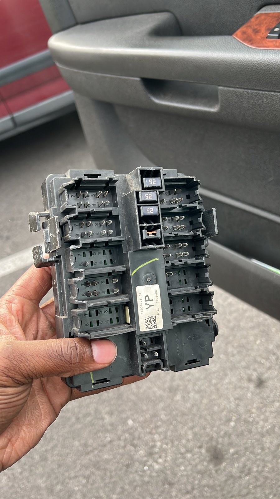

Has this box (near the drivers feet) known to intermittently act up? I have wiggle wires/tap the box and it went back to normal, I checked all wires and see no issues so I put dielectric grease on the connectors and re-connect but I’m eyeballing this box because it went back to normal when I wiggled/slapped this box (giggity)
Never had a problem with them or read about folks having trouble with them but anything can happen George. That's called the Body Wiring Harness Junction Block, 20813086.
It comes apart, so maybe a circuit needs resoldering inside?

I wouldn’t know what to do solder wise I did order one that might not get to me till Tuesday, it acted up again today on the way to work was fortunate to make it and it went back to normal. I watched this video which also makes me suspect the junction box more so watch it from the middle to the end part. I did get 98 ohms at one point, but I didn’t get a chance to remove the junction box like he did to 100% single it out before it went back to normal.
