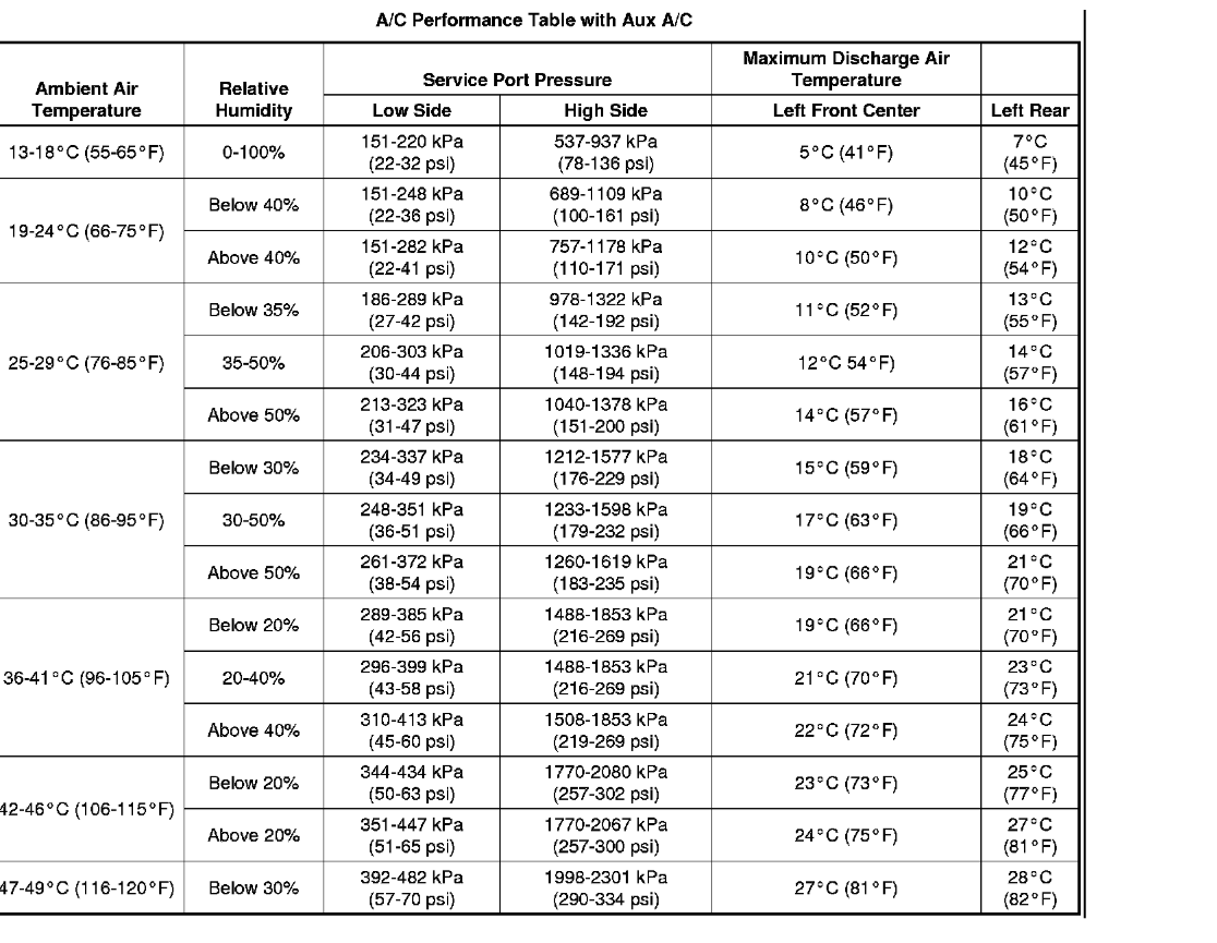

That low pressure reading sounds like anything but normal at 84 degrees ambient. Id expect to see 45psi or so at that ambient temp. It appears your system is low on charge. What does the pipes look and feel like coming off the evaporator and drier under the hood with system running? Have alot of frost or ice?
From the GM Service Manual.
Your pressures seem a bit odd. Which can cause all sorts of weird problems.
I agree with @rockola1971 I would verify your pressures and charge first.

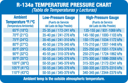

The low pressure cutoff switch actuates around 20PSI or so. OP isnt low enough for the low pressure cutoff to disable his compressor to protect the system. The system is blasting super cold air because the evaporator is running at below freezing temps and icing over. At 24.5 PSI the refrigerant is at 28 deg!
A system that is overcharged or undercharged will act similar because one or more sections will be either flooded or starved for refrigerant. The pressures wont be alike though.
