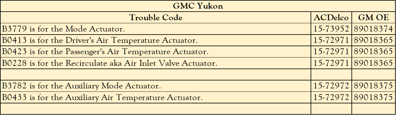

I can use your help again. Has the manual heater-a/c control head in the dash with rear defogger on it and has the CJ3 RPO code.
I am looking for the Genuine GM or AC Delco part numbers for that control module and the actuator that controls the hot/cold mode. VIN is 1GNEK13T45R142468.
Her a/c can be ice cold and while driving will go to warm, without touching temp controls. When I run it, I can change the temp controls and can hear a loud ratcheting noise as the actuator change positions and sounds like is behind the glove box area. I believe the actuator is failed/failing and the control head has problems because the system is full and when it turns warm, the a/c clutch is disengaged and jumping the low pressure cycling switch does not engage the clutch. The ratcheting noise has been going on for quite a while, even though the a/c would blow cold. Now the noise is still there and the signal is not even at the low pressure switch at the accumulator I tried crossing the connections and still no clutch engagement. The other actuator controls for the modes of blowing out of dash, floor, both or defrost, all work for the direction of flow. When those are operated there is no ratcheting noise.

@Fless, IIRC you laid out the locations of the actuators and what they were for, at least on the GMT800 series.
Mode door actuator is above the gas pedal.
D/S hot/cold actuator is center area above the transmission hump.
P/S hot cold actuator is under dash cover above the glove box and to the left of the heater core hump at top of HVAC box.
Recirc actuator is under dash cover and to the right and at the firewall area of the HVAC box.

Do you remember who did? I think I am right but would like to hear some confirmation.
21,321
30,318
Pretty sure this also applies to the 800s with CJ2.
I believe the CJ3 system uses some different part numbers.
