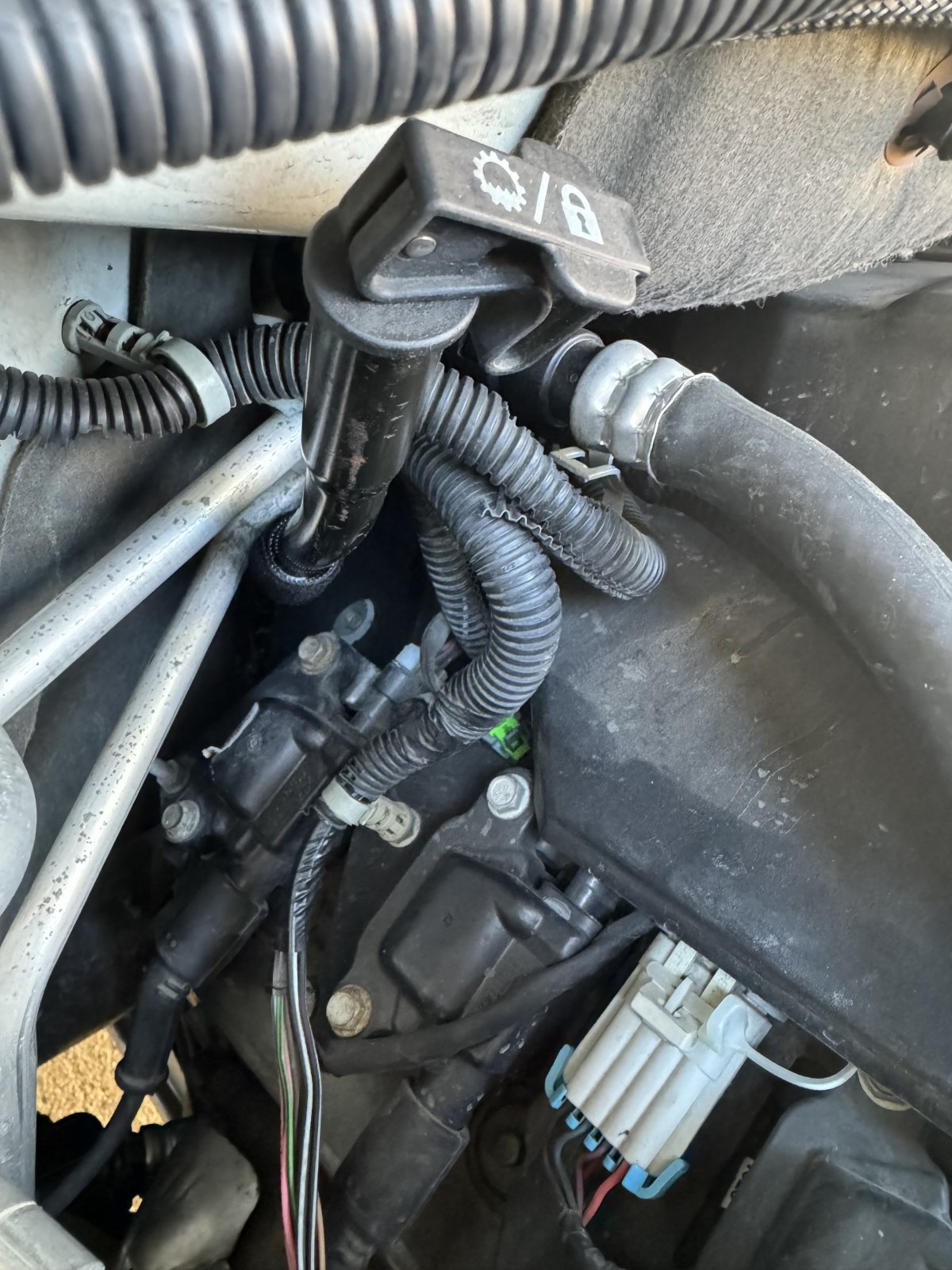

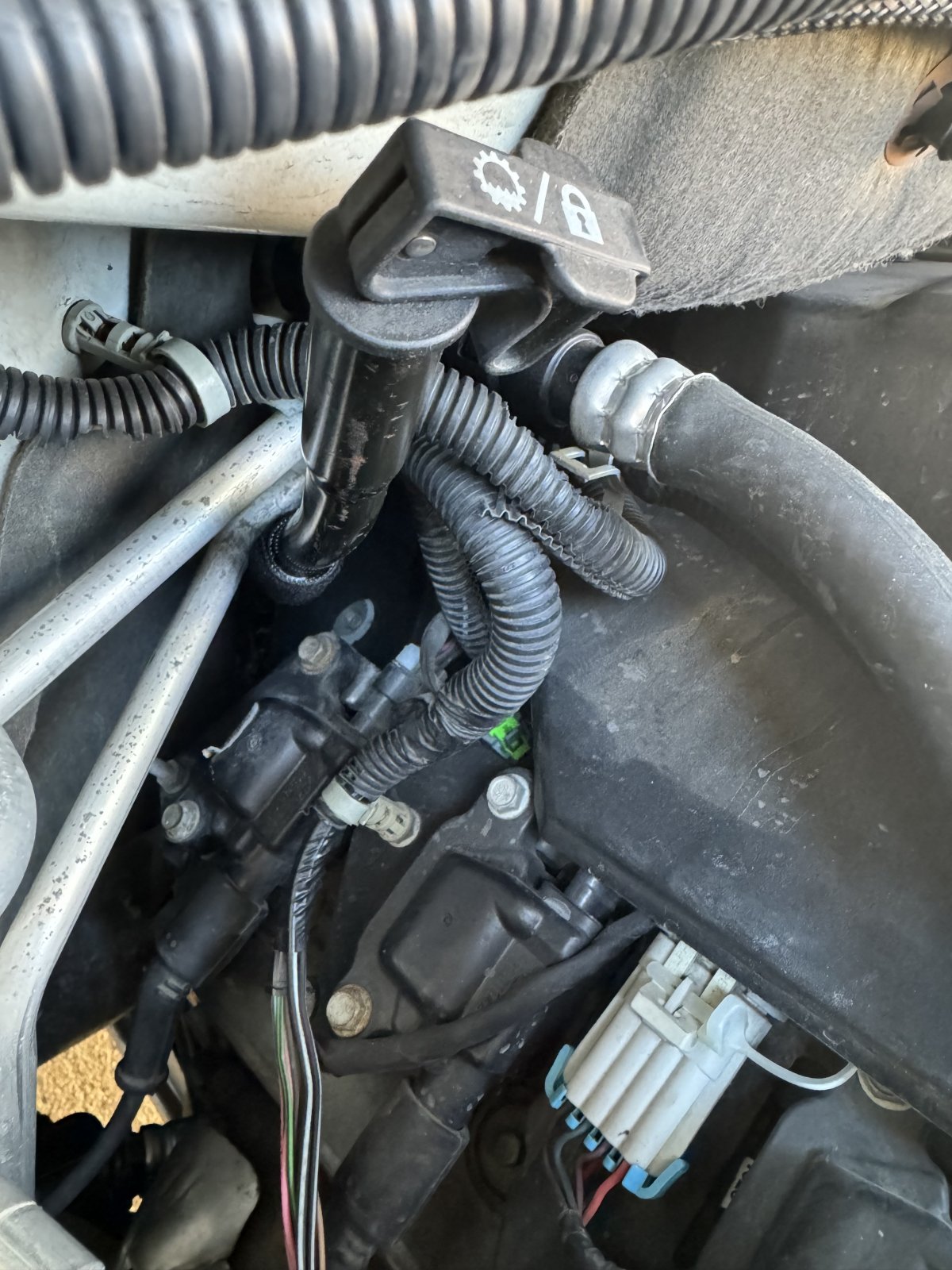

Are you sure it’s IN the dash? I just fixed a rattle that sounded like the dash but it was the transmission dip stick tube rattling against a rear hvac tube. I wrapped a 1” wide piece of Velcro around it and it was fixed. See it stuck in between?
