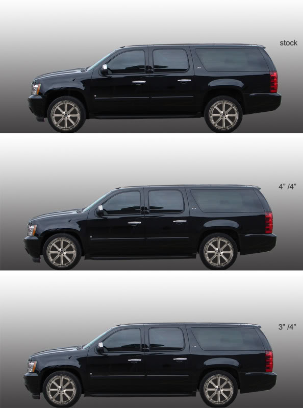

I have the Bell Tech 739SP and have not yet installed the front portion of the kit due to lack of time and indecision of how low to go (and having to take it all apart again to adjust strut ring count
Did your kit come with control arm bushings? The instructions in my kit say to use them if the struts are going to be used at their lowest setting... but are they not needed when at least one spacer is used?
About going lower then 4" in the rear... I went the full 4" in the rear and it is possible to go lower, but probably just not with BellTech products. McGaughy's offers a 5" rear kit that I'm considering, it differs from the BellTech 739SP with parts other than just a lower spring... it does not include bump stops and also has re-locators for the rear axle. At my current height the bumpstops make themselves known quite often... I'd like to find an alternative to the tall ones that came with the kit, or just remove them altogether like the McGaughy's kit.
