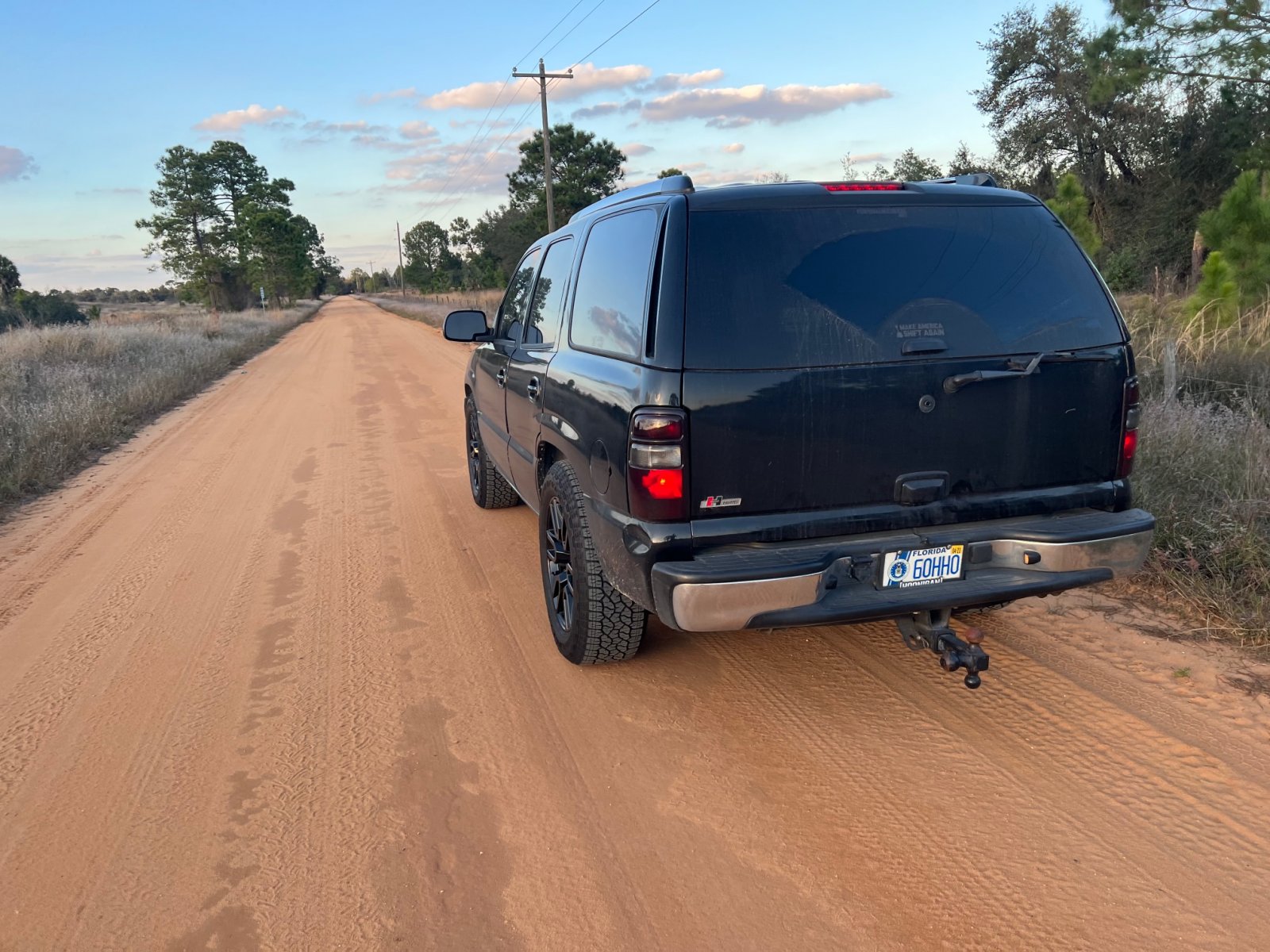

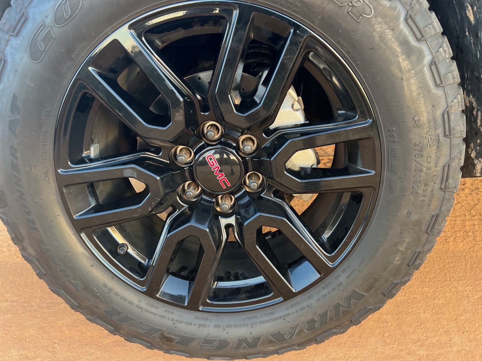

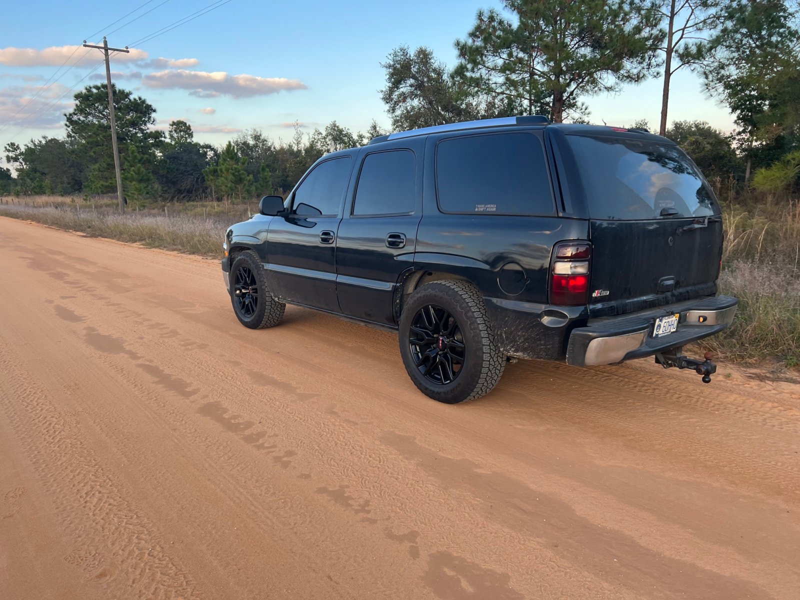

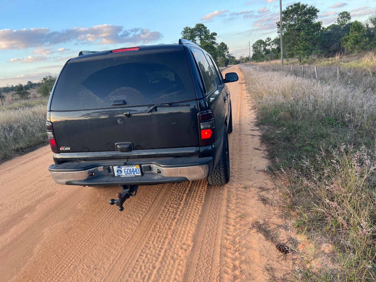

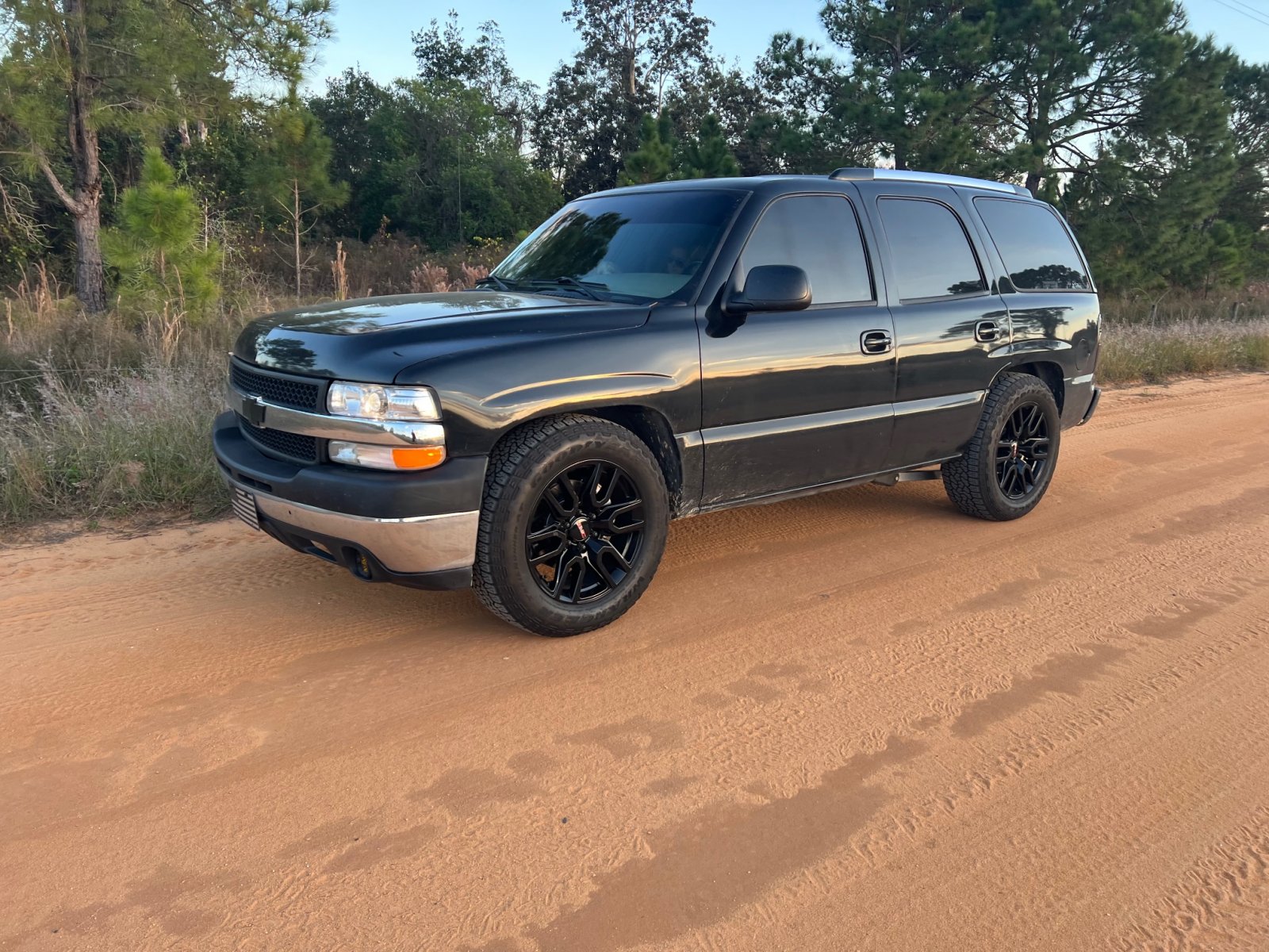

I just put 275/60/20s on yesterday and I have something close to a 2/3 drop maybe a tad more. No rubbing yet but I've only been to work and back no major off-roading or anything crazy to get the suspension to articulate. I think the key is that they are a very sissy tread pattern and on factory offset wheels. If the wheels stuck out further or the tire had an aggressive sidewall I think it would rub very badly. Also worth mentioning is my alignment is well within factory specs which helps keep the wheel centered in the wheel well.

They are Good Year Wrangler Trail runners off a 2021 GMC Sierra, not my first choice but I got a good deal on the entire setup and so far I like them. I am coming from some 285/50/20 Nitto 420s which definitely rode stiffer and were surprisingly louder but that could be because they are getting old (3 years old and 40k miles on them). I was also looking to improve ride quality a bit with a taller sidewall and so far I am very pleased! The Michilens are known to be great tires but I don't think the price is worth it especially when I'm gonna do burnouts and slides to wear these out faster than the average person would.

Thanks again. Your new wheel/tires setup looks great! It appears to me your ride heighth is greater and your wheel well to tire distance is a bit more than my present setup on 275/45/22s, which are not as tall as the wheel/tire combo they replaced. Looks like I need to tryout 60s on my Esky to if they will clear. Thankfully, I have access to 20 inch wheels with 60s profile tires to do that befor I buy.

Yeah I definitely gained an inch or so of ground clearance with the new setup which is a plus since I do more offroading than I should in a lowered 2wd. The ride quality is really a big difference I just went and got lunch and went done an old brick road that usually jars me around and it is considerably more supple now.
