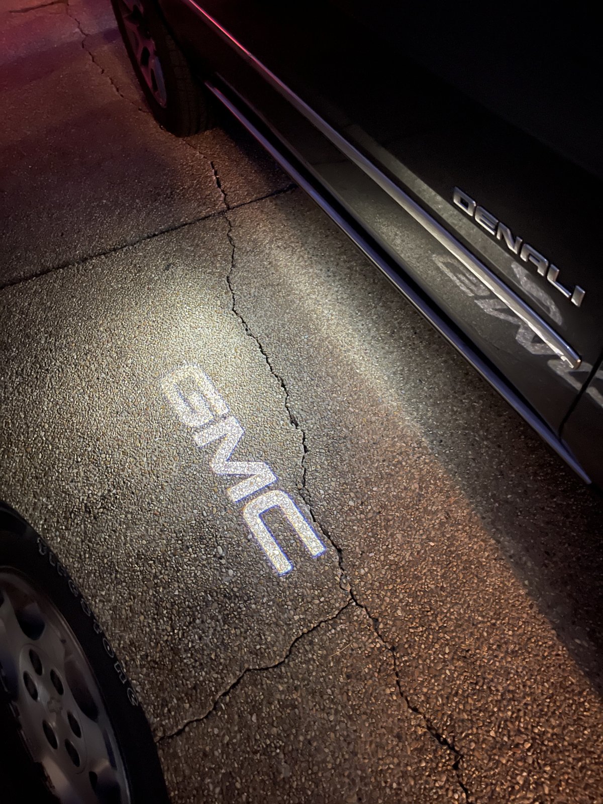

Installed these today (GMC), super easy install. Still too light to really see them well, but they appear to be relatively straight. I will tweak them a little bit, to make them perfect. Really cool little add on. My wife has a new XT4, and her car has the Cadillac crest at the rear passenger side, to show where to wave your foot to open the lift gate. Be great if the new 2021 Yukon has a similar light, that could be retro fitted to our generation Yukons.
Double post and you’re right, it’s so light I can’t even see the pics at all lmao.

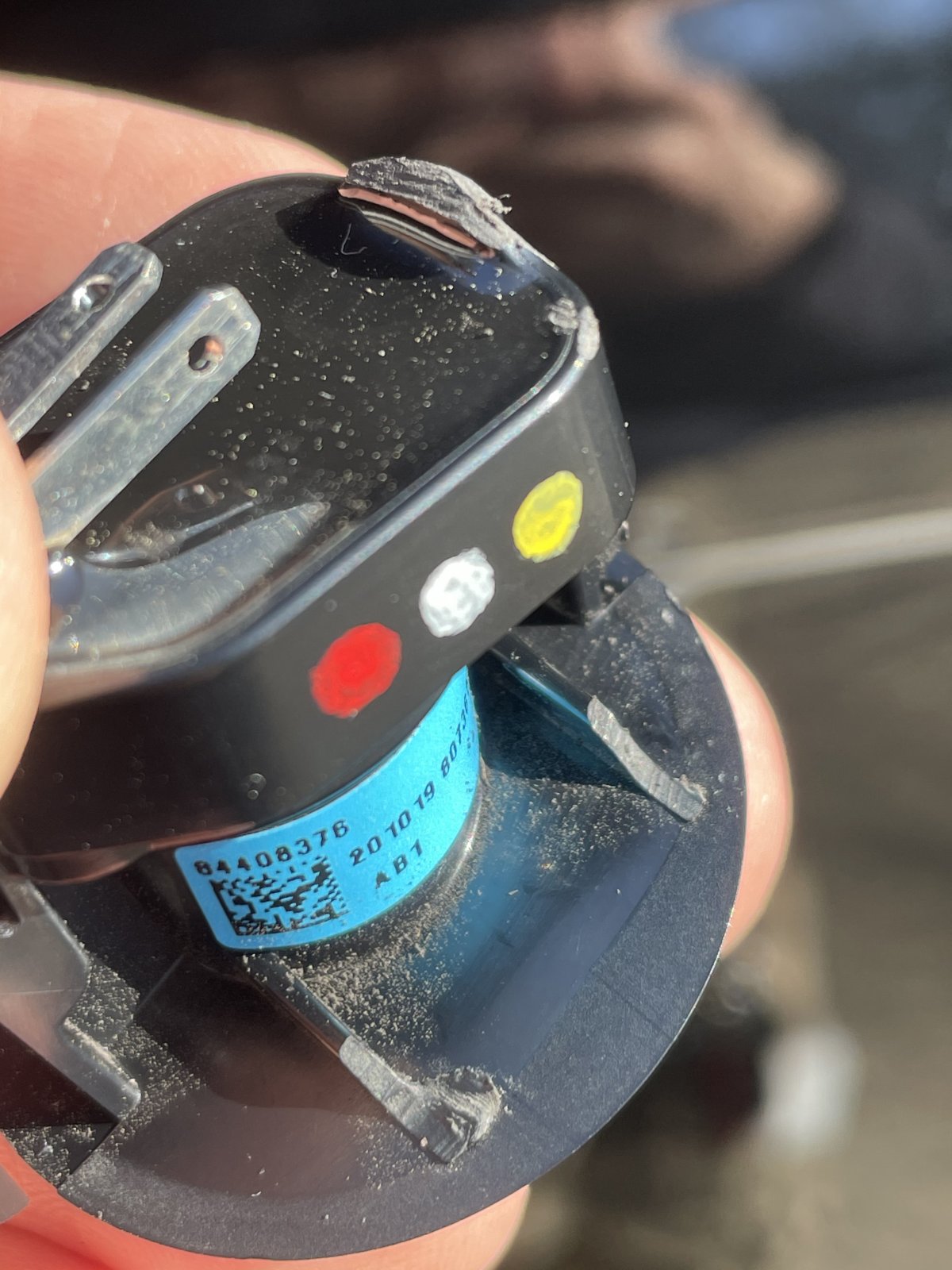

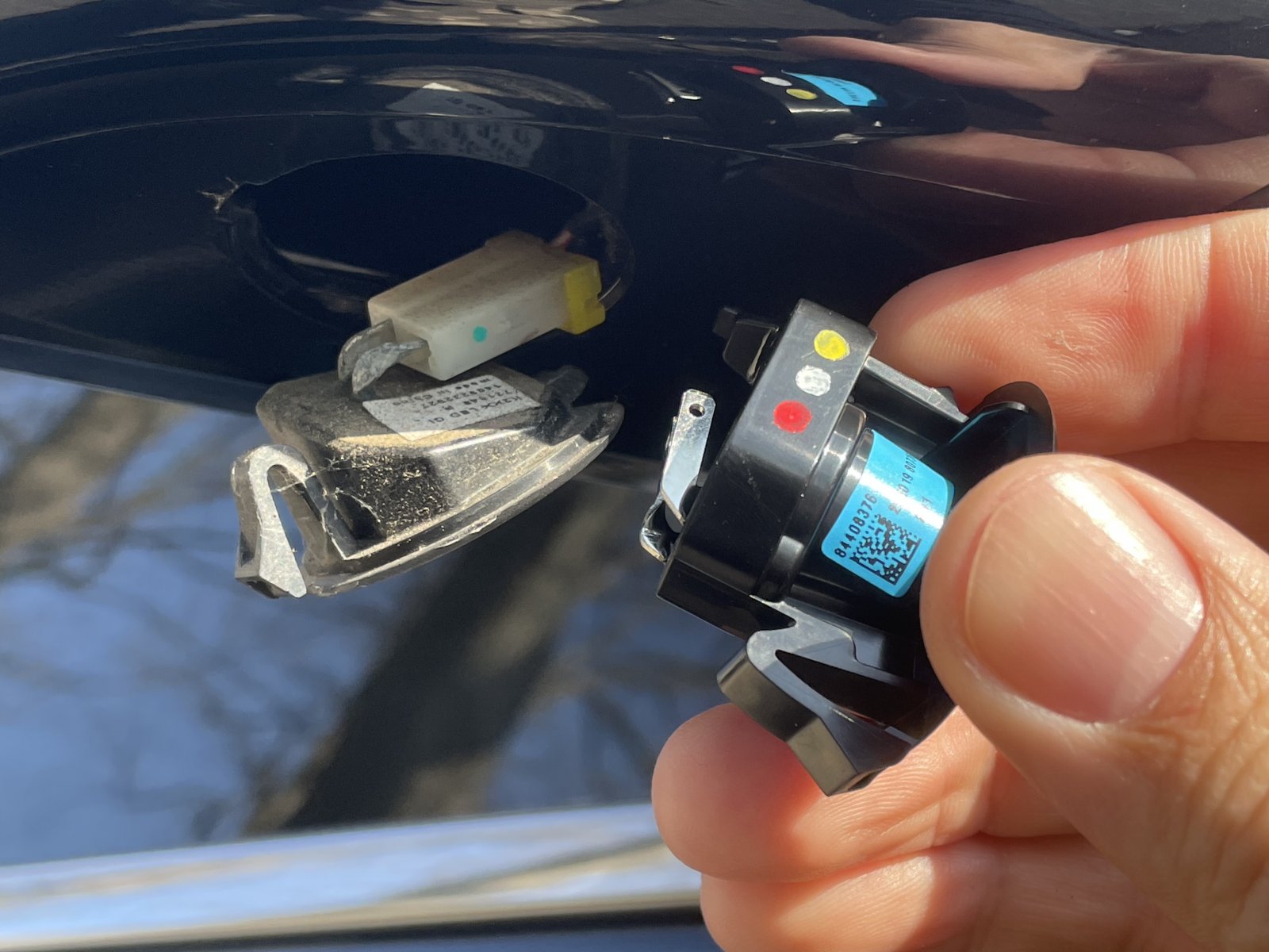

So I just installed these. Will recommend (very carefully) dremeling four points, three of which are captured in the pic below. First, the tab in front of the connector leads is too tall for our connector to fit so I took that down maybe 1/8”, as opposed to bending the tabs upward. Then the two (and one on the other side) other plastic beams on top of the circle. Take those down just a tad and the light assembly pops right in with no pressure or protrusion.
The logo still is at an angle which I don’t like but that will be easily remedied by dremeling a notch in the housing about 1/8 turn from the factory notch. I didn’t do that because I’m going to do the Esky mirror swap in the next few weeks and I don’t feel like doing the notch project twice. Hope this helps.

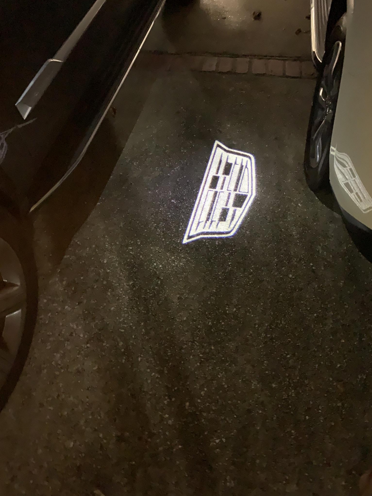

Just got mine in today. Quick install, and the lights will fit either side, so you have to look at the color of the label on the light to know which goes on which side.
Overall I'm happy, but since it has a logo, the "approach" isn't as bright as having an actual light.
Also, on the higher model or new model escalades, the rear bumper has a logo projected to know where to kick for the tailgate. Can that be retrofitted to a model that didn't have it? I have a 2017 escalade luxury, my 2019 premium loaner had it.
I'm looking for the rear projection logo myself. My 2019 Escalade has the light, but not the logo. Can't find one anywhere.
