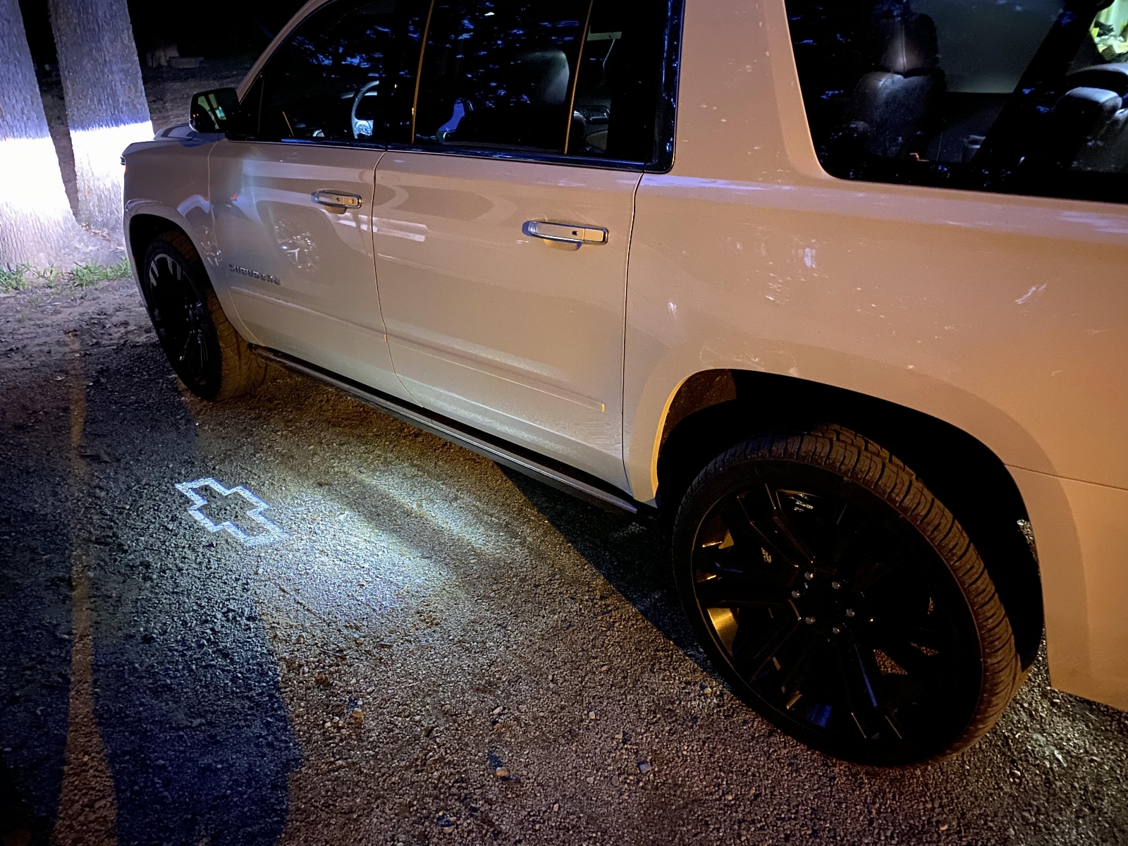

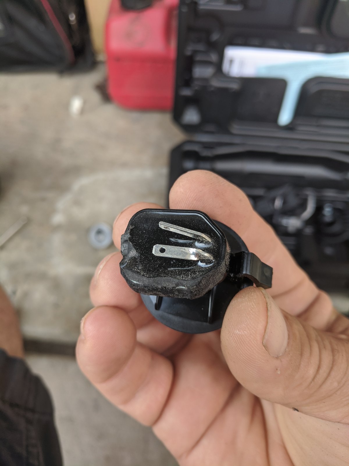

Got mine in the mail today.
The 2017 Suburban was a direct swap. No issues as stated above. They are somewhat washed out by the running board LEDs but still very noticeable.

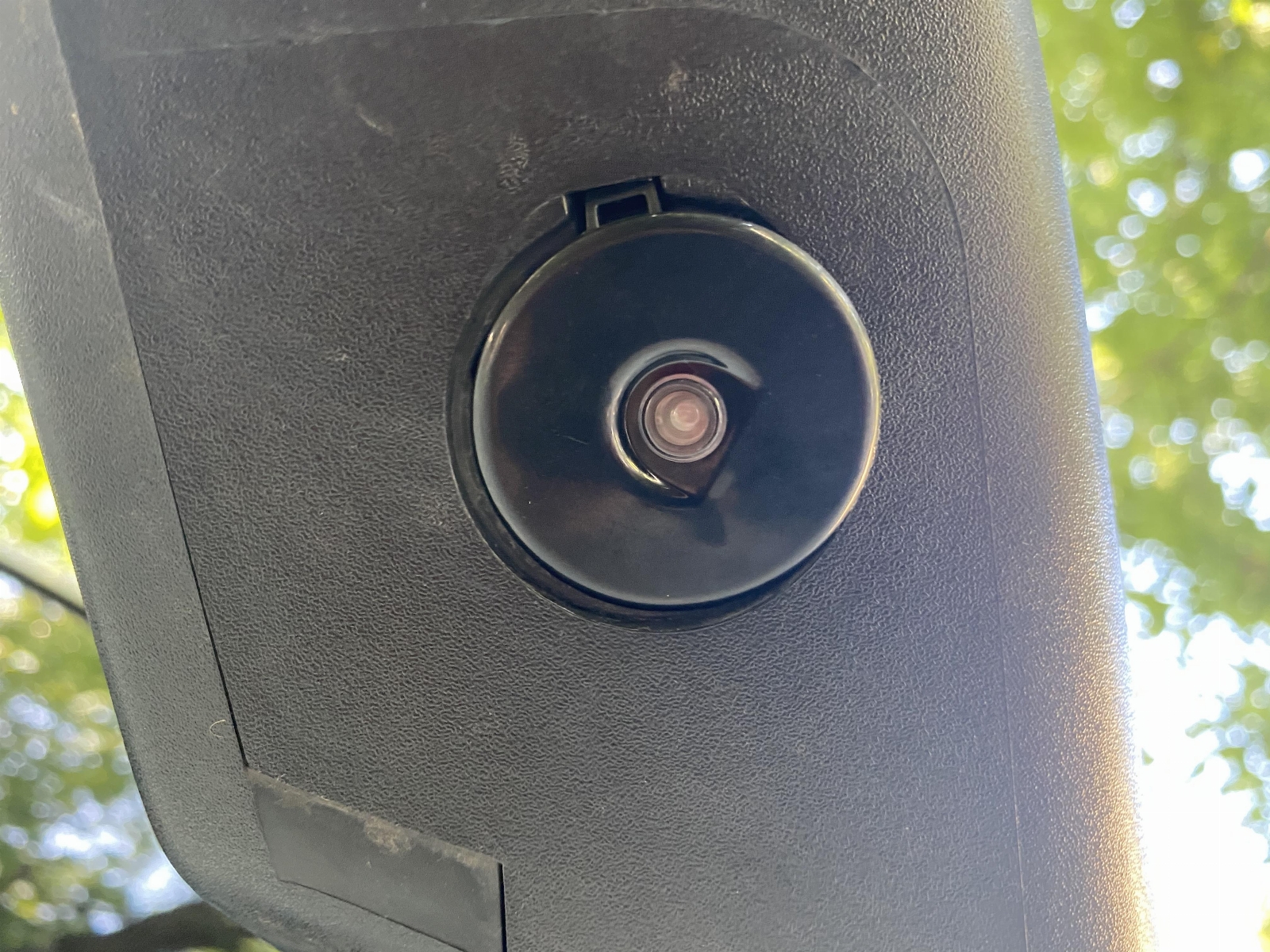

The Sierra lights fit but the hit the mirror frame on the inside. That in return makes the light sit sideways in the mirror and projects a crooked logo. They do not fit flush in the mirror either.

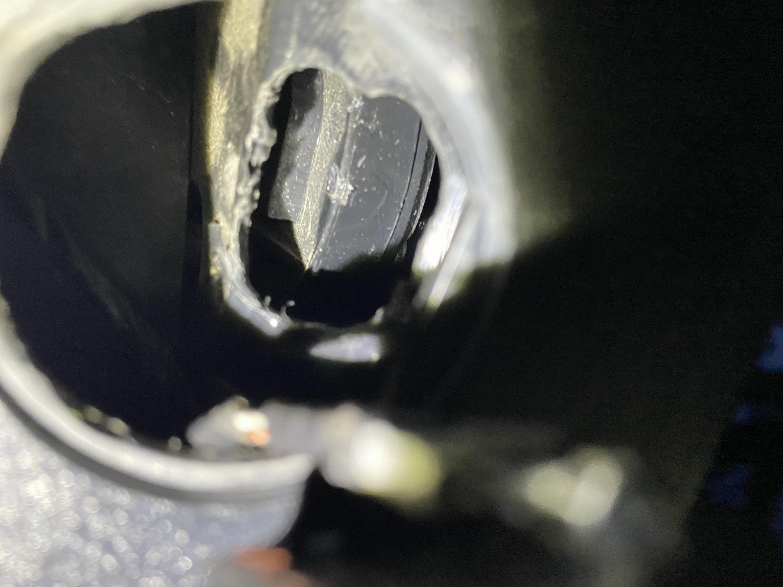

I ended up drilling the mirror frame through the hole. It’s damn sure not the prettiest thing I’ve modified but it worked. I did have to spin the light in the housing to the appropriate angle. Be careful you don’t hit the mirror motor behind the frame like I did.
Done!

nice, mine were out for delivery today but got rescheduled for tomorrow, so I guess I will need the dremel since I am sure the sierra and silverado are identical inside.

Yeah a Dremel would work better. I have one and didn’t think about it. When you install the lights they will leave a scuff on the frame showing where you need to cut.

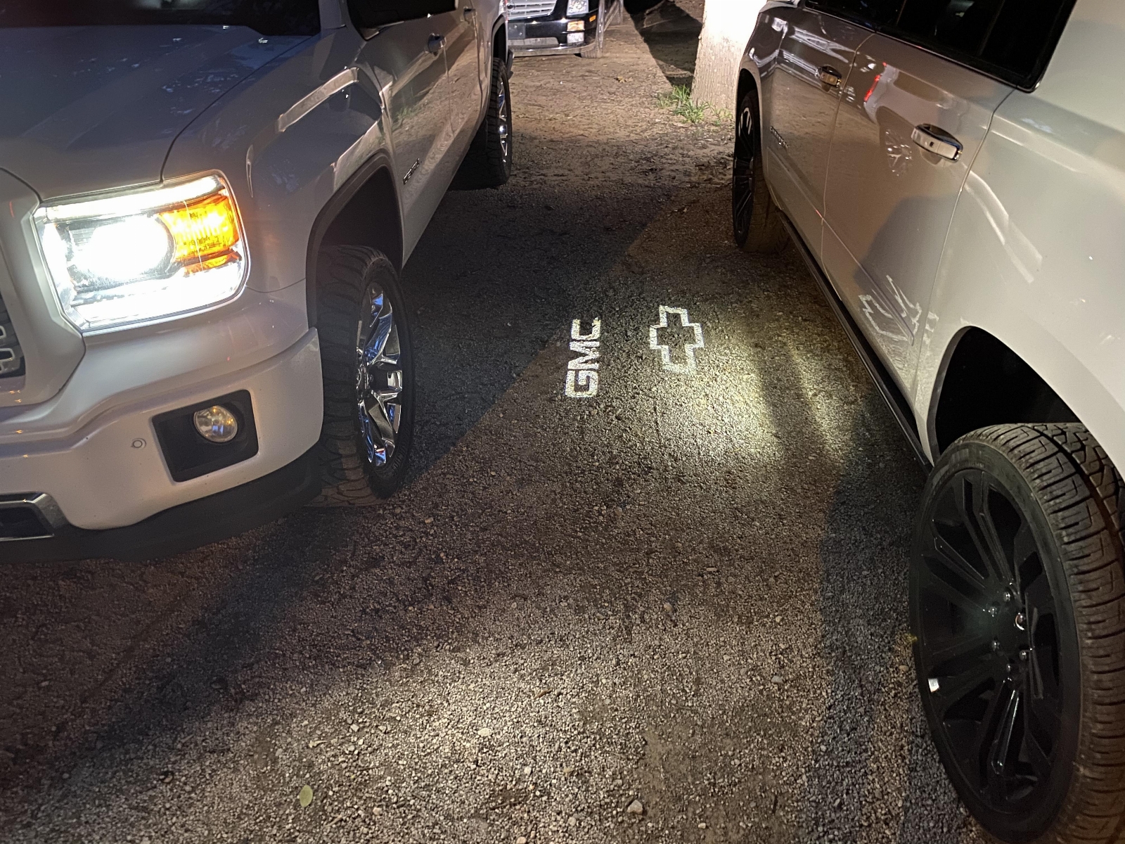

mine showed up yesterday but I was out of town and didn't get back till late so today I took the dremel and shaved a little off of the side of the light and they fit right in the Silverado, then I trimmed the clip hole a hair so I can turn them straight, too bright outside right now to see anything will follow up later this evening
left side wires go the same as oem, right side you have to reverse the wires (polarity)

I started filing down the light itself and got impatient and started drilling. Lol
I do remember having to reverse the polarity on the right side now that you mention it.

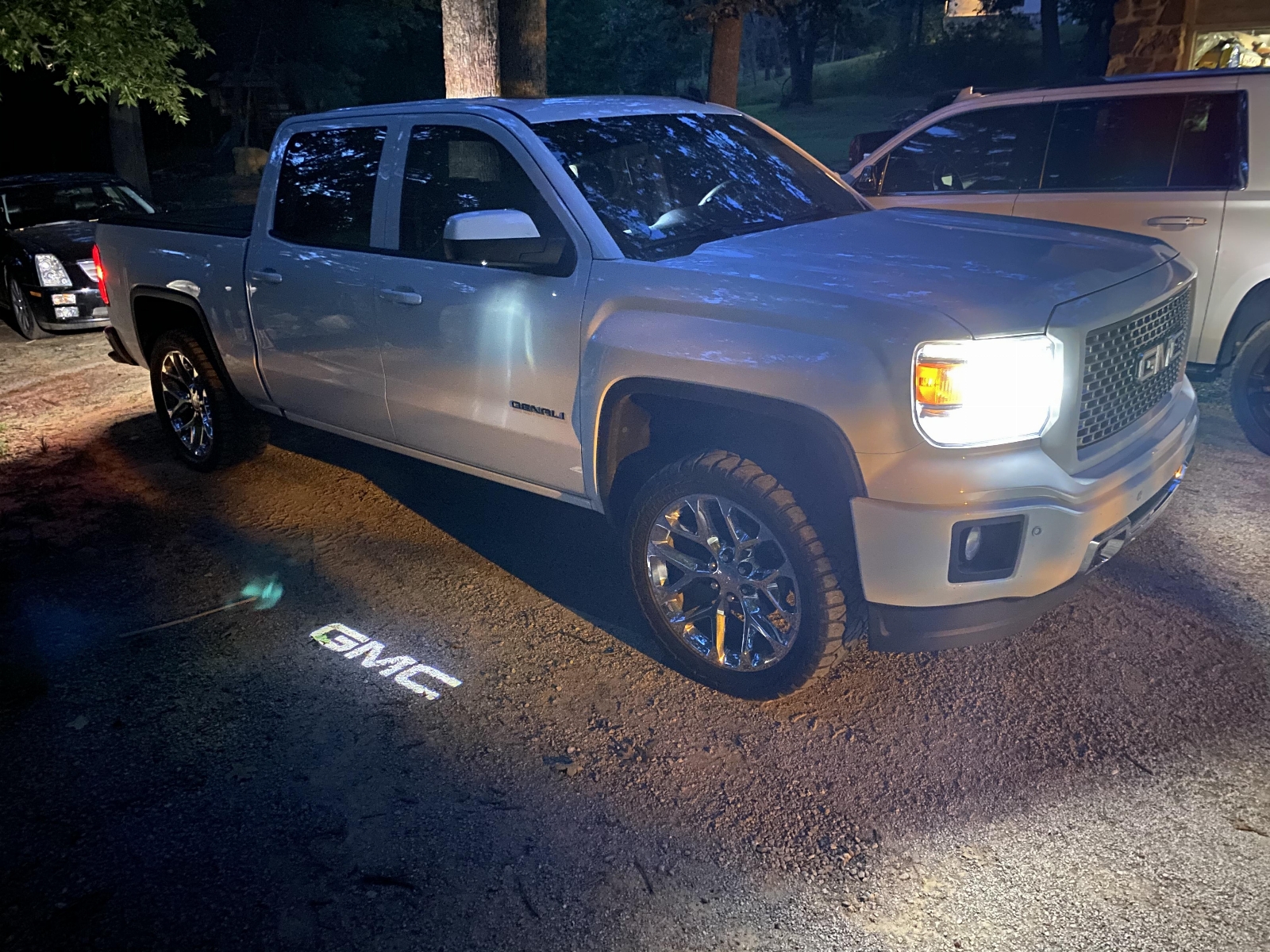

I didn't do anything else to try and correct the angle last night it's been 115 deg here for a few days straight the heat just wears you out. one side is kind of straight the other needs a little more adjustment

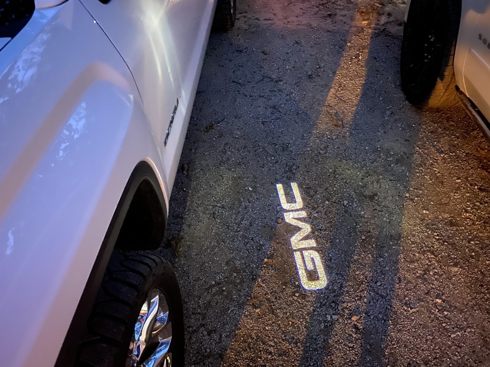

Installed these today (GMC), super easy install. Still too light to really see them well, but they appear to be relatively straight. I will tweak them a little bit, to make them perfect. Really cool little add on. My wife has a new XT4, and her car has the Cadillac crest at the rear passenger side, to show where to wave your foot to open the lift gate. Be great if the new 2021 Yukon has a similar light, that could be retro fitted to our generation Yukons.
