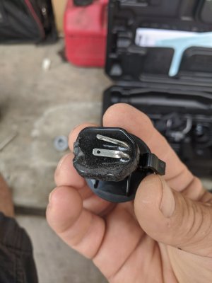

mine showed up yesterday but I was out of town and didn't get back till late so today I took the dremel and shaved a little off of the side of the light and they fit right in the Silverado, then I trimmed the clip hole a hair so I can turn them straight, too bright outside right now to see anything will follow up later this evening
left side wires go the same as oem, right side you have to reverse the wires (polarity)

I started filing down the light itself and got impatient and started drilling. Lol
I do remember having to reverse the polarity on the right side now that you mention it.
