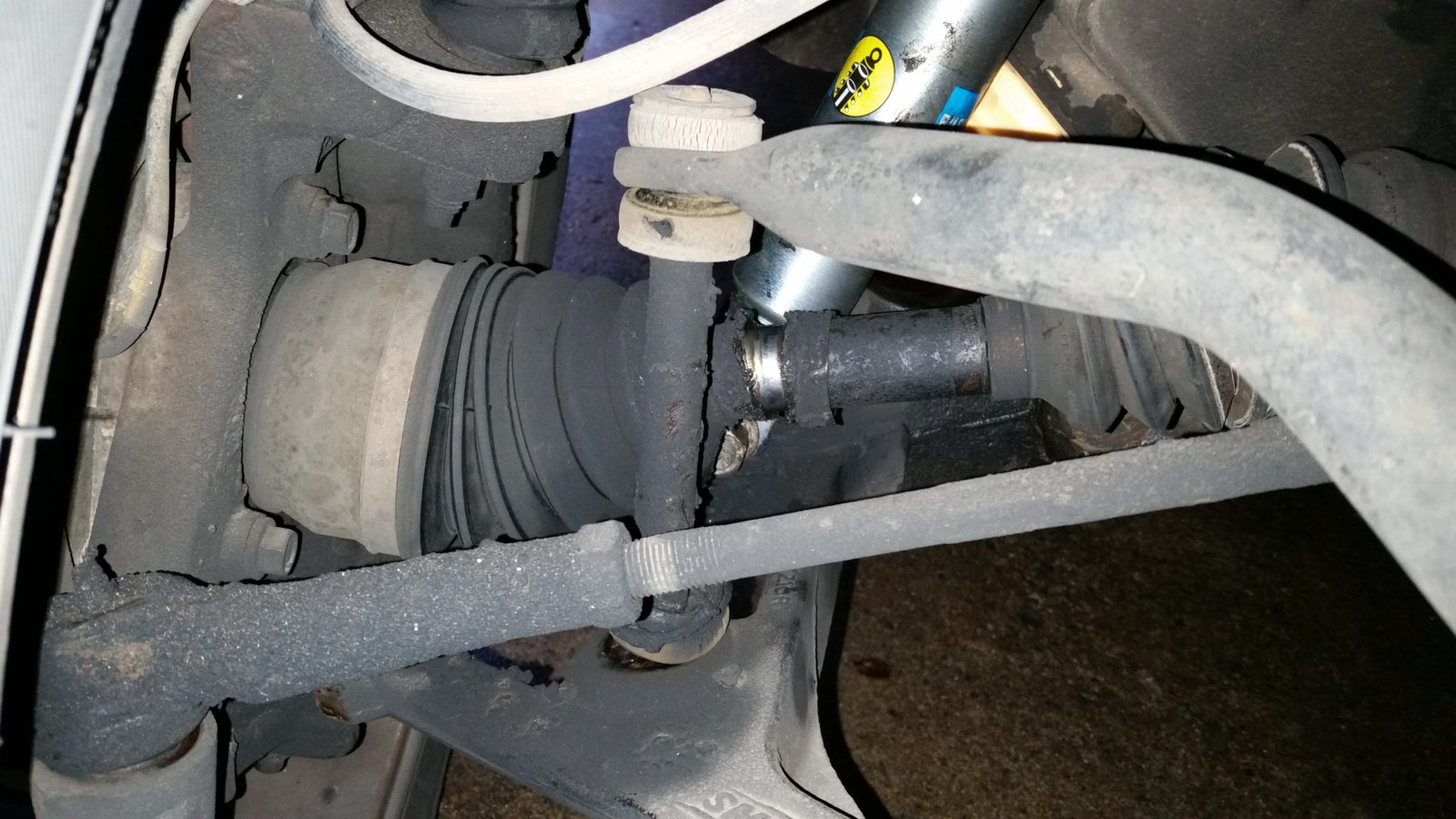

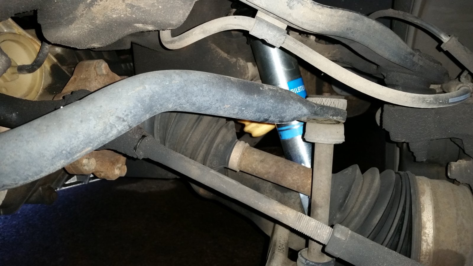

Put some 5100 Bilsteins in the front the other day. Got some Ford keys put on yesterday. Sitting at 40" in the front - thinking I'm gonna crank it down an inch later today or tomorrow. Hoping to get longer end links on in the next few days and get the rear done by this weekend (Moog HD springs, 5100 shocks, 1.5" spacers, and jeep end links). At some point, gotta replace my passenger side half shaft (torn boot since got it a year ago). But how do the angles on my half shafts/cv axles look?

axles are supposed to be level looking, so they are going to wear out faster, maybe even vibrate.

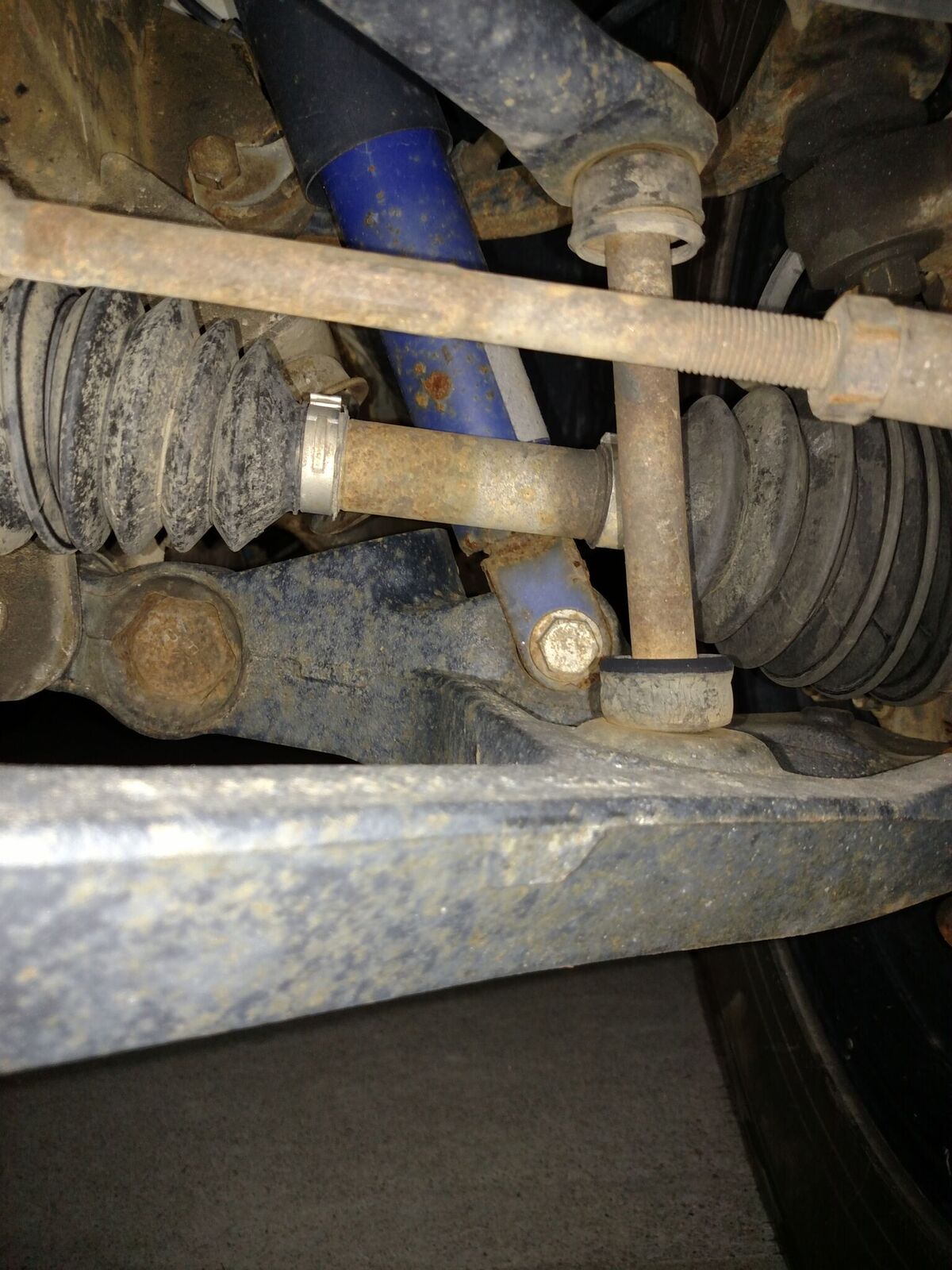

i had my angles about as bad as yours. drop them to around where its level. this is with a little squat and my angles are fine. it rides better and im not scared im gonna break a bj when i go over a bump
