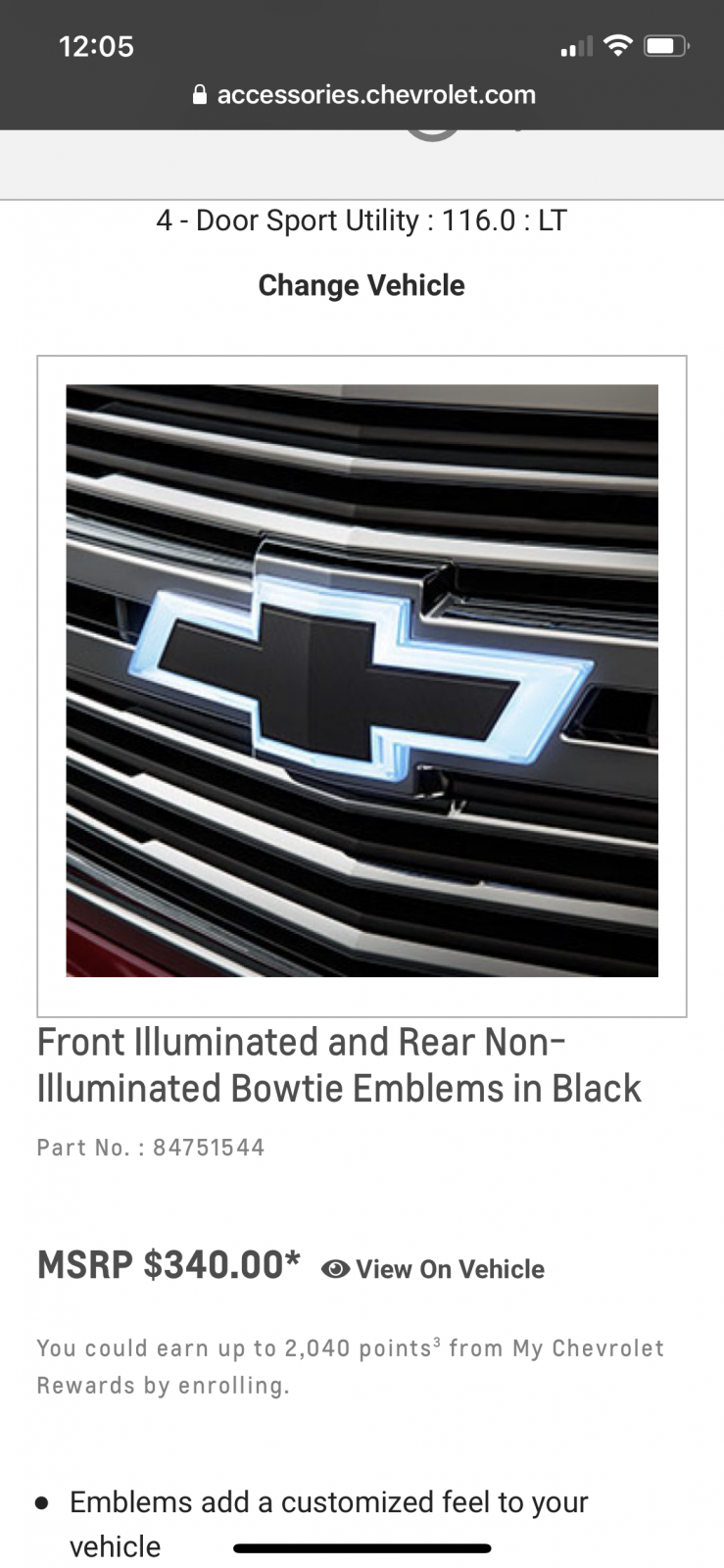

Miss
Lighted emblem available for the 2019 Tahoe. It might fit earlier models. In Gold without the black rear emblem it’s $275. Would love to add it but. Not at that price.
