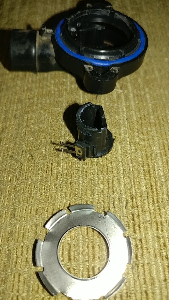

Inside of the Throttle Position Sensor

So, I'm chasing a half throttle issue and I wanted to see what was inside this little booger
Some wear but nothing crazy.. This things as simple as you may imagine

All it takes is one dead spot in the wiping range of the resistor and your PCM sees the problem. On DBW vehicles it will shut you down into reduced engine power mode and engine will do nothing but idle.
