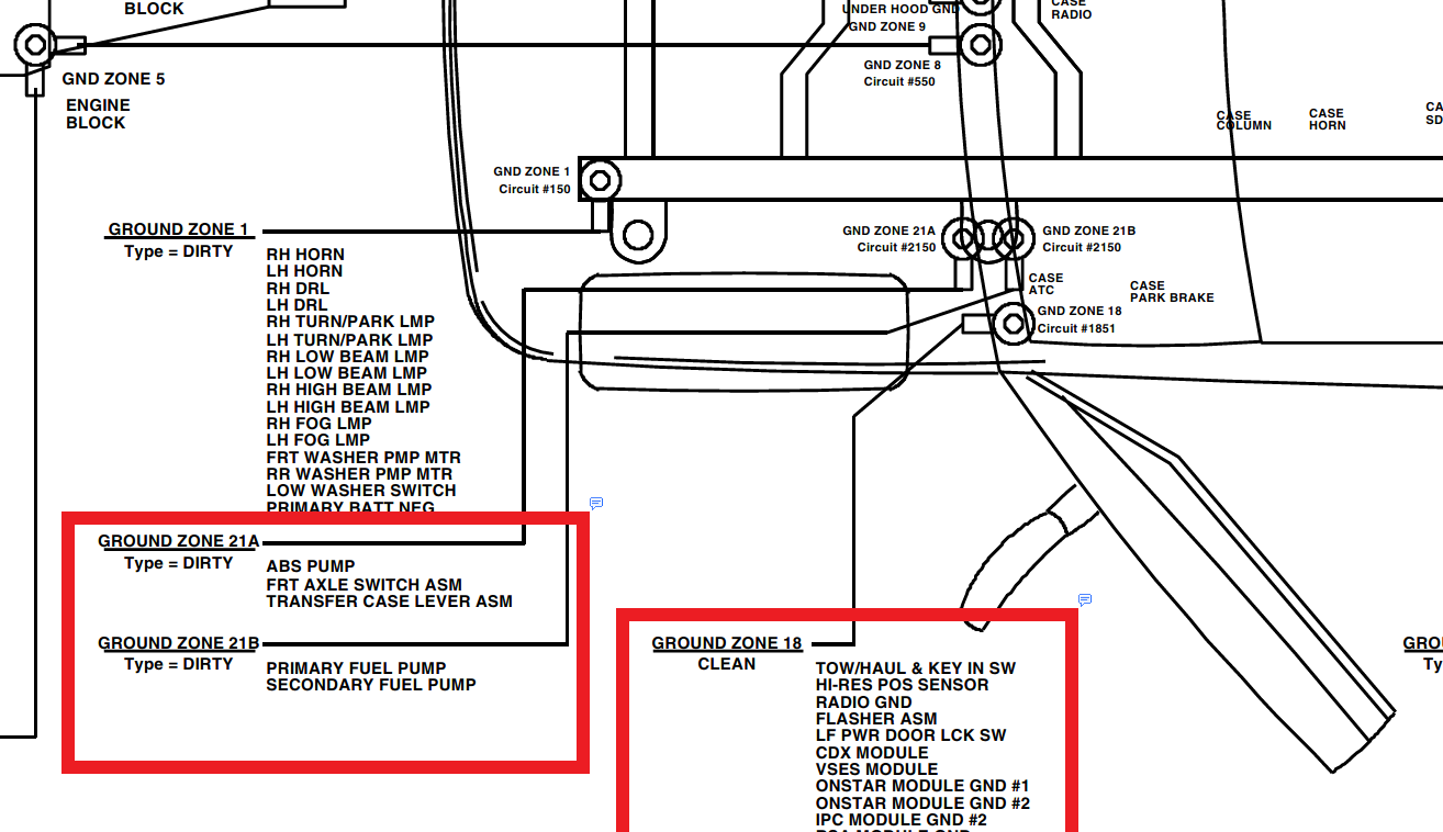

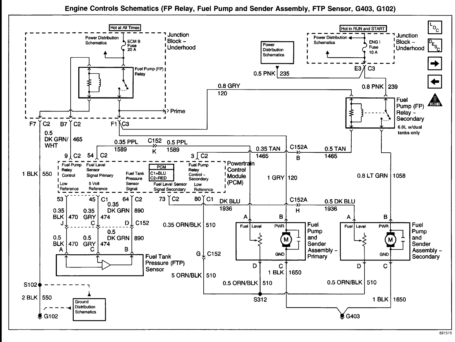

I'm going to see if maybe I have a poor ground that's leading to reduced current to the pump. Pulled this out of the FSM. But cannot find where G102 or G403 are located. Anybody know?

This is what the upfitters guide shows, the fuel pump ground on the body mount underneath the driver's door hinge:
Zoomable PDF attached.
Presumably a high number ground (like G403) would be near the rear of the vehicle, but I'm not sure of that. Alldata would likely show them.

@Fless thanks!!! I dug through AllData for quite a while but couldn't seem to bring up those two grounds. I internet searched them, but seems you're picture is much better than what I found on the internet. Very helpful.

Delphi tech support has me checking circuitry. They said to do voltage drop tests. I'm going to do that now. One across the whole line for starters then break into the positive side then negative side if necessary. Current draw, patching my amp meter in in place of relay was 5AMPS. I think maybe supposed to be 6 AMPS but battery charge was low. Lots of stuff I'm checking... Will update here as I go through whole process. I should have tested the voltage drops when I had the tank dropped. Now I have to drop it again *sigh* all be it only part of the way to access top of pump.

Not a single electrical fault. Positive side voltage drop 0.6mV negative side voltage drop 115mV tested against all three chassis grounds on driver side.

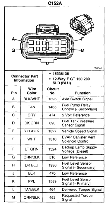

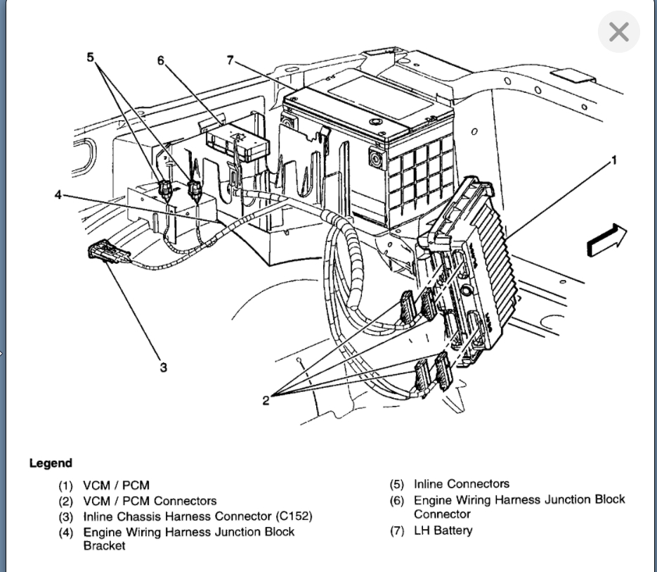

I would think that Alldata would have that. Found this, though (#3 on diagram):
Thanks! I ended up testing and found out there's no electrical issues in my fuel pump circuit. I maybe dense... I cannot figure out a great way to search AllData (at least the old version). I search for connector numbers and nothing comes up. Then I went to connectors by number and it didn't list C152. Thanks for finding that!

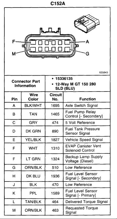

There is a connector, C152A (also C152? connector on wiring diagram but not listed in FSM)... I cannot locate it? Anybody know where it is?
I believe these are inside the fuse box. Pop the the little tab and the fuse panel swings up/out.
