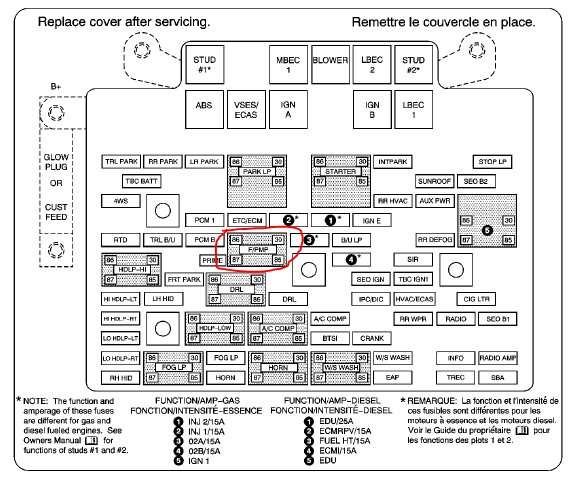

This is for a 2004 GMC Yukon 5.3 (Flex fuel). Working on what was thought to be a bad fuel pump. Vehicle was purchased, then driven 120+ miles to destination. It was parked then not touched again until now. Sat for a couple weeks. After all the ok driving and no issues, now it won't start. Diagnosed (from others) as a bad fuel pump. Have been through 3 brands of pumps, and no matter what none of them will prime or turn on at all. Have checked female adapter multiple times. Getting around 12V. Relay is good. Ground seems to be good. Everything has power until hooked up. Nothing is working. It's becoming a headache. Anyone else with this issue? Also, sometimes it will turn over and start to run then dies immediately (fuel pump still doesn't cut on)

If the fuel pump does not turn on for a second when the key is turned on (not cranked) then you might swap the fuel pump relay with another one that is the same (some of the others in the underhood fusebox are identical).

Swapped the fuel pump relay with another as a test? Pick another identical one and swap it in the fusebox. EDIT The DRL relay right next to the fuel pump relay is the same; could swap those two.

We have swapped relays. All are in good working condition. Nothing of this makes sense. Like I mentioned, everything has power. Relays, harnesses, ect. Primary problem is basically the power to the pump disappears once connected to the power supply harnesses.

Just out of curiosity have you checked the PCM-B fuse that is next to the fuel pump relay? Pull it out and make sure both legs are intact and it's not blown and has good tension on the blades.
