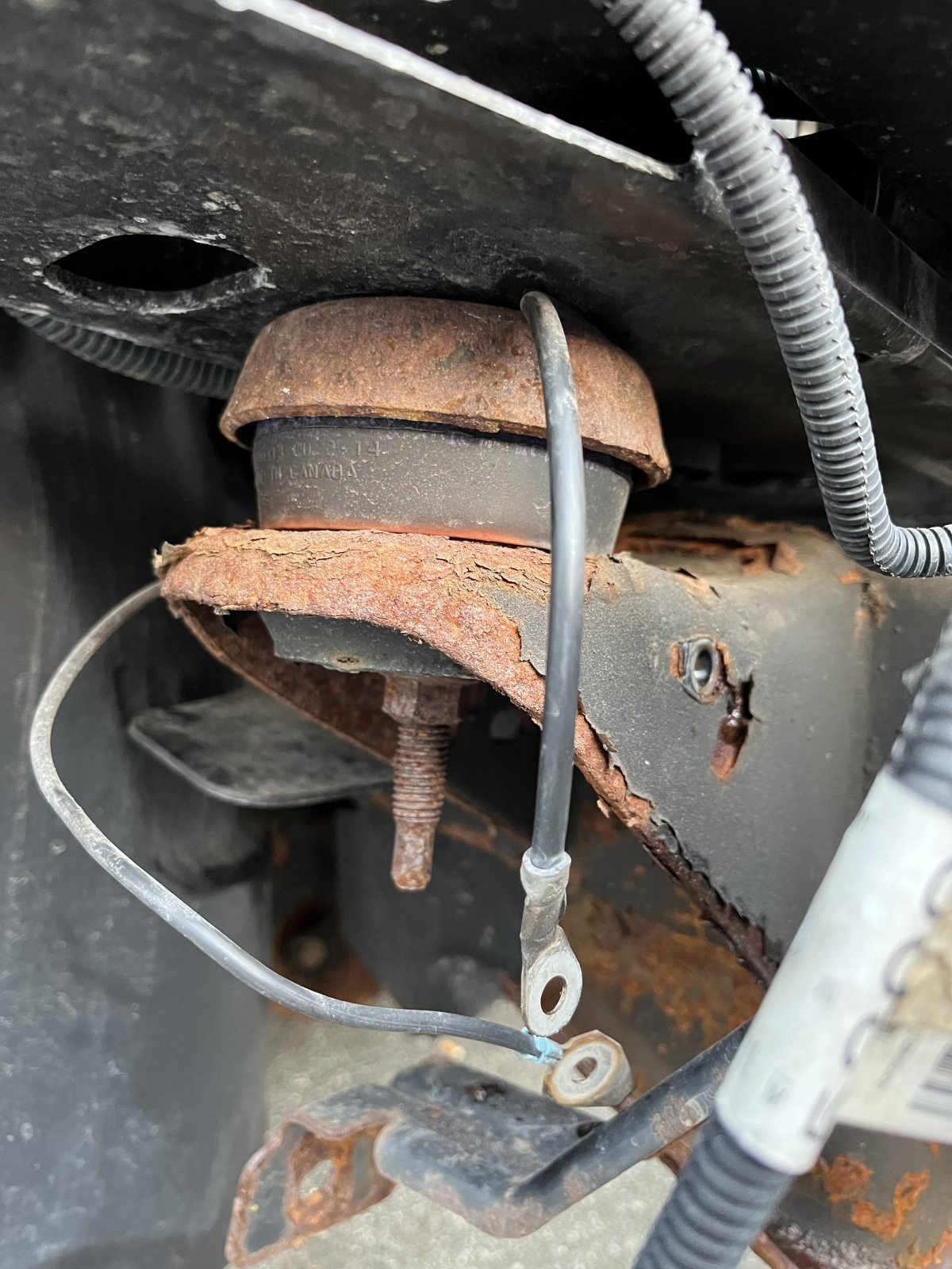

We first got the truck in March, three days later truck would not start all lights on the dash showing up but no cranking check voltage had power, tried to use the key fob would only unlock doors no trunk would work no remote start, car had an accident from previous owner front end right side. First thing I replaced was battery ground with original replacement. Removing bumper realize that someone had crimped the secondary part of the ground on the sub frame one front end was fixed.
Didn’t solve the issue. Got a new ECM flash from flash masters did not fix the issue. Just recently replaced body control module also flash by the same company didn’t fix issue. Before I bought vehicle as well the car dealership admitted to me that they could not keep this thing going past a few days after paperwork was finalized, they’re are the ones that replace the battery and the alternator.

Based off of what you have said, pics supplied and that it was wrecked, I would start and concentrate on what @Geotrash has said. In the future, never be afraid of too much info supplied. The info about a wreck is likely the key here and we can also see the rust likely related to salt on roads where this rig lived before. Corrosion can be a PITA to these rigs.

We first got the truck in March, three days later truck would not start all lights on the dash showing up but no cranking check voltage had power, tried to use the key fob would only unlock doors no trunk would work no remote start, car had an accident from previous owner front end right side. First thing I replaced was battery ground with original replacement. Removing bumper realize that someone had crimped the secondary part of the ground on the sub frame one front end was fixed.View attachment 379084
