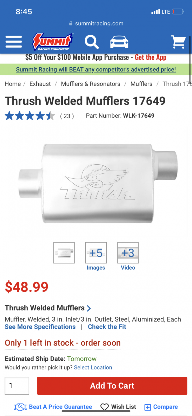

Pic from last night but I’m gonna end up going with this and if it’s too loud or quiet change it I’m gonna clamp it on and put a aftermarket 3” tailpipe so I can have a exhaust tip

I have one of these (single in, dual out) and it's a tad loud for me but not horrible. I'm 43 now and long gone are my 19 year old LS1 with headers/no cats/true duals. Went with it due to reports of no drone and can confirm. I may just get the larger 300 series and see.
Edit: Video of start/idle:

A lot of folks run with those. Seem to be really popular. With it clamped in place, you could always get something else and sell off the Thrush on Craigslist, Ebay or Marketplace, if it is not right for you.

That’s why I wanted to clamp it eventually I wanted to weld it if it’ll weld I was gonna give the noise level a test spin and if it’s suitable and the wee woos don’t go off on me I’m gonna stick with it
