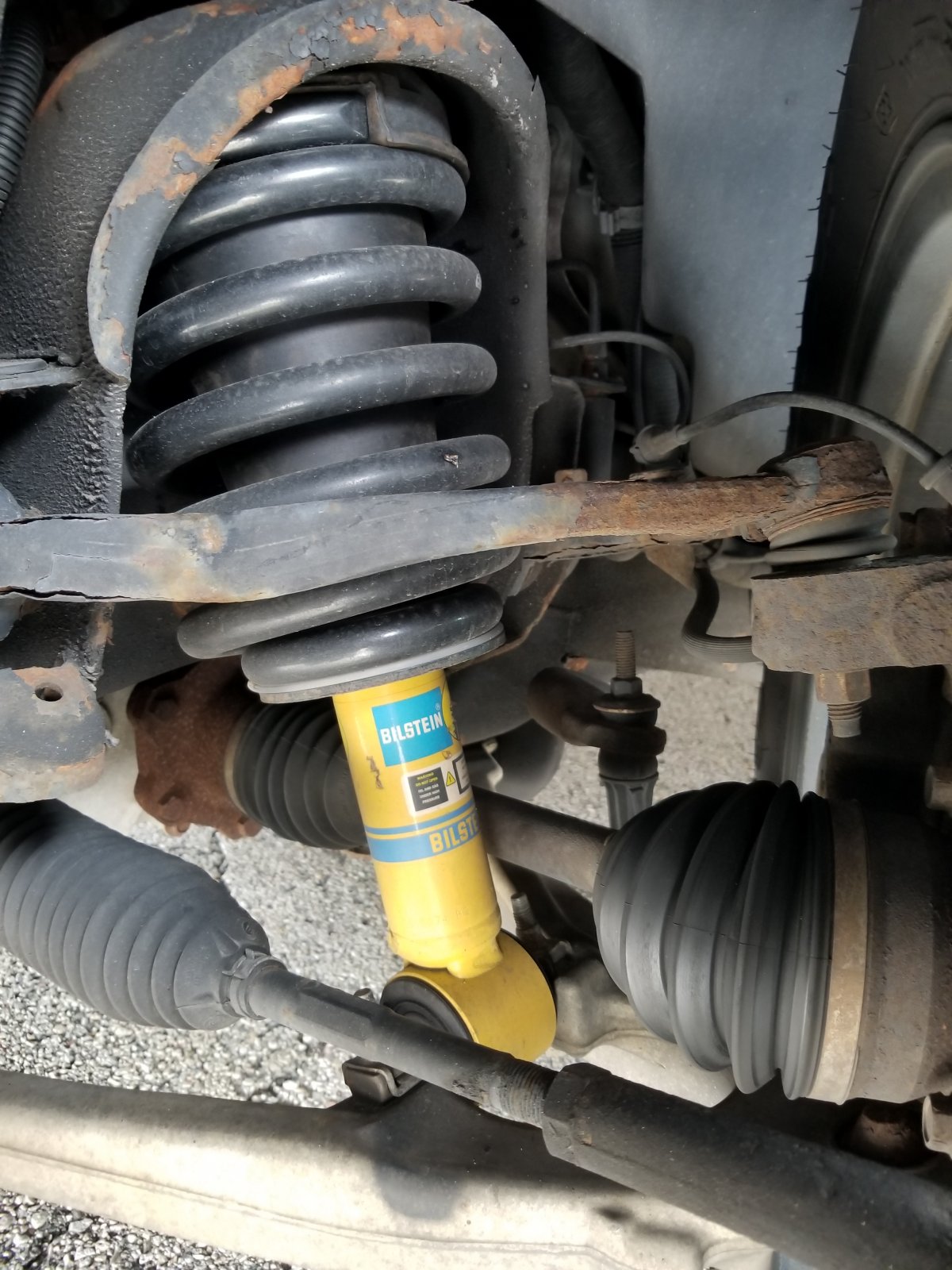

I have Eibach/bilstein all around ride is a little bouncy but not bad at all.
