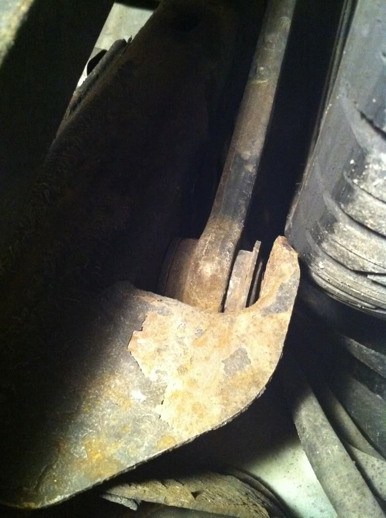

Well I used a grinder and trimmed a few things down this morning. I think it's good for now.

Ah......looks familiar. You're gonna have to run thinner tires. I run 285/40/24's and it's still REAL tight. I also have an adjustable pan which helps but it's still REAL tight when I am aired our to like 40psi. The next step is the Spohn adjustable LTA/UTA to center the axle in the wheel well. Mine is more like a 7'' drop in the rear though so you might want to get the trailing arm relocators if you don't have them, probably the least expensive place to start

So even with the the trailing arm relocators it'll still rub?
NORCAL SS
SUV SUSPENSION GURU
Jun 9, 2009
8,744
610
nope will push it back to clear front portion
