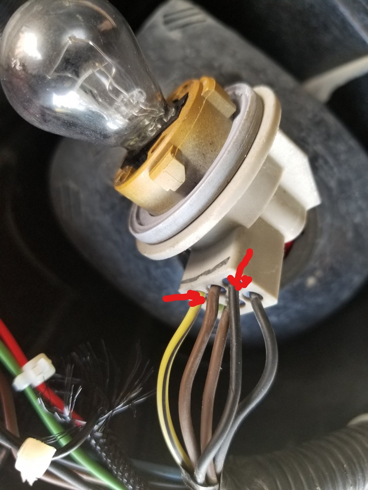

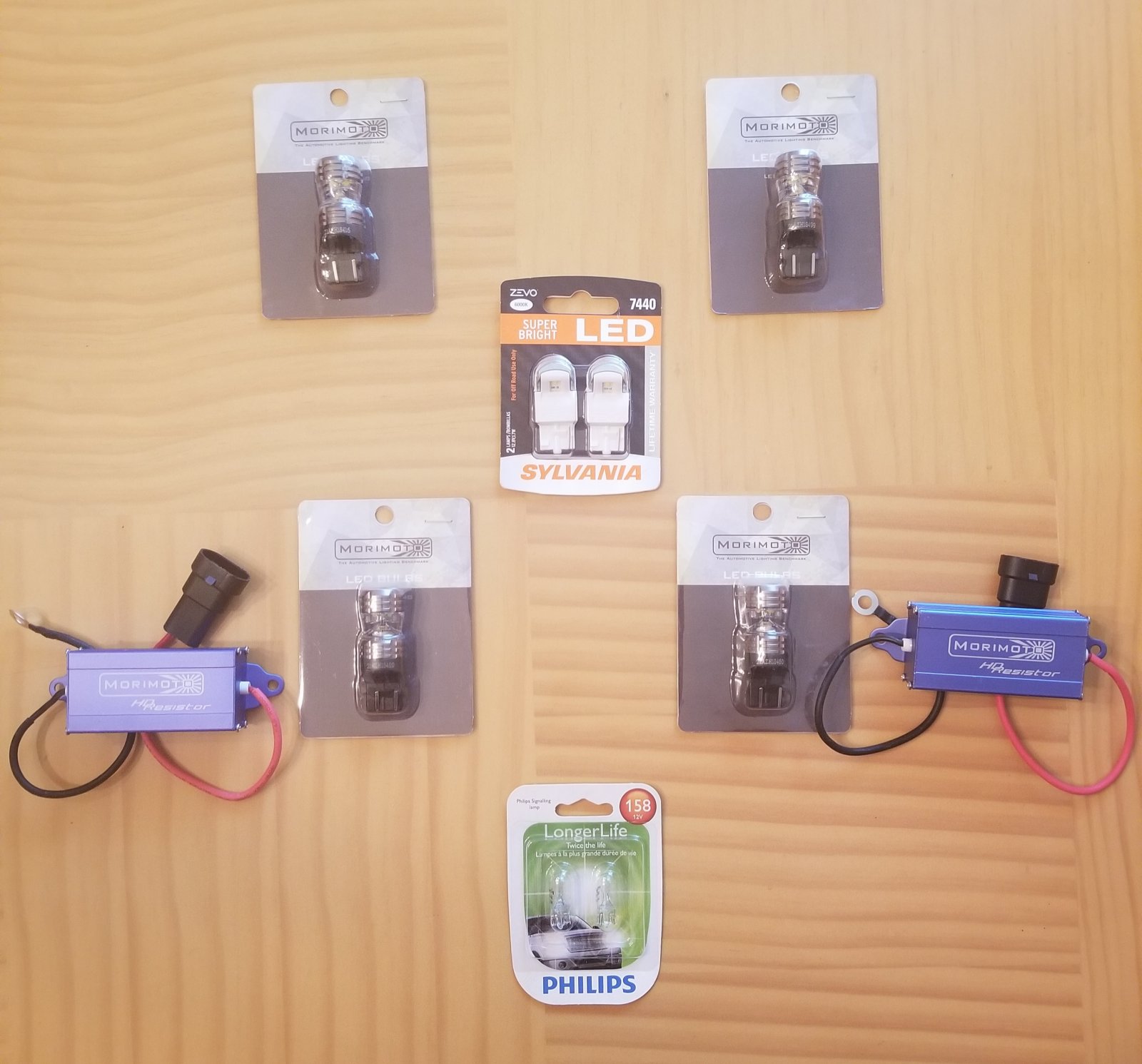

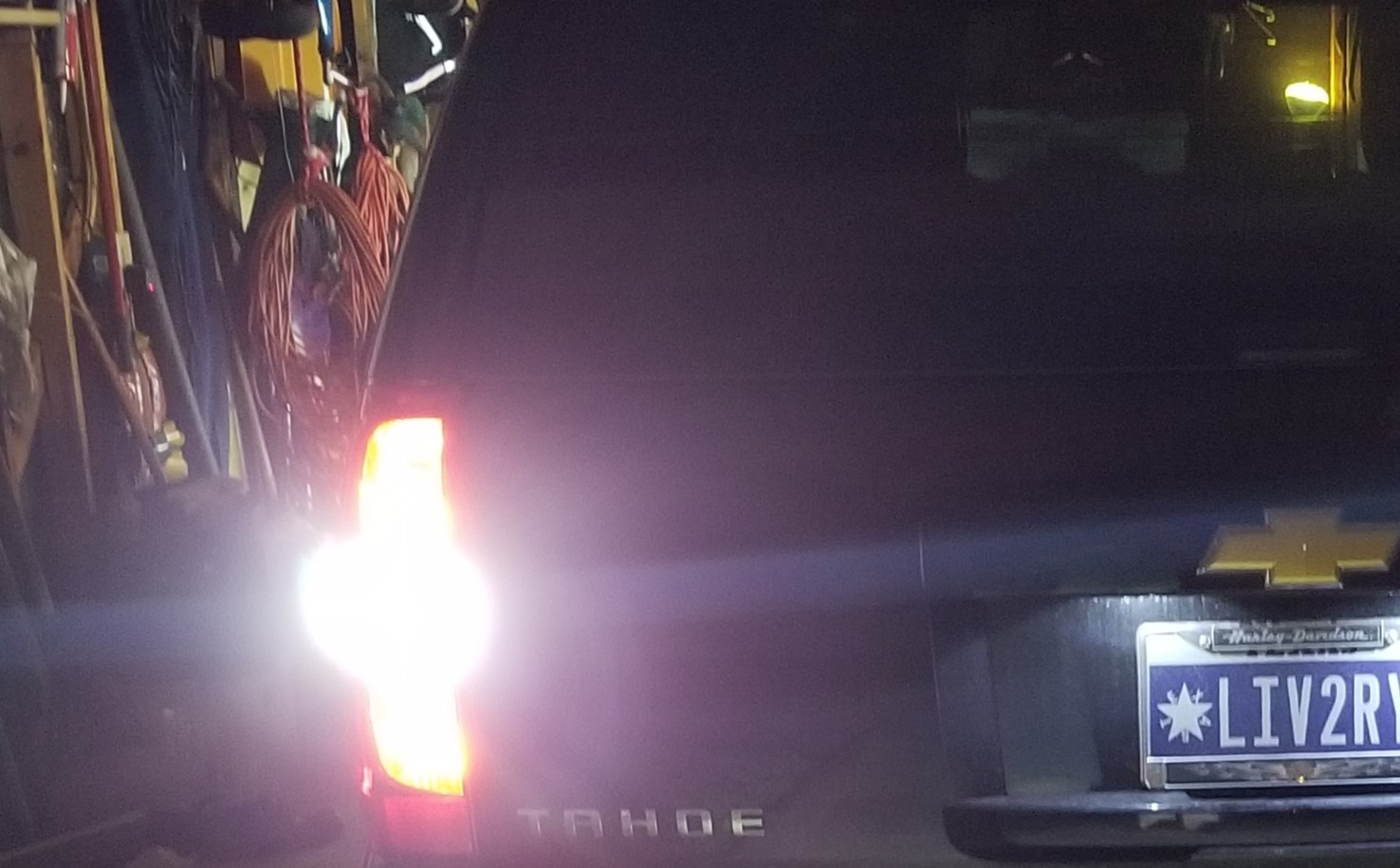

The install is completed, I went with the Morimoto 40w 7.5 resisters instead of a LED flasher, I used Sylvania 7440 ZEVO's for backup lights (much brighter that GTR, Morimoto and GREE lights because the ZEVO LED is aimed back towards the reflector in the backup light socket. The 2013 Tahoe's have two tail lights on each side but only the bottom lights has the turn signal so in wiring the resister to that socket use the top row of wires that has YELLOW , BROWN and BLACK wires. The YELLOW and BLACK in that row are the ones you need to tap into for the resister , the bottom row of that socket are the BROWN and BLACK wires that go to the other tail light in that tail light assembly and if you tap into those you will not correct the Hyperflashing... I am pleased with the results and with the addition of the Rough Country slimline off-road LEDs used as back-up supplemental I can now see where the hell I am backing.
