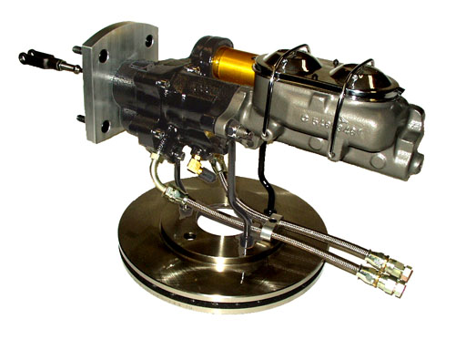

I don’t think pictures from my truck would help much. I could not use a stock power steering pump because it had to be in an inaccessible place. My power steering pump has no reservoir on it. I have a stand alone reservoir that was from a chev van.
I did find a picture of the unit I used. Same bolt holes on as the vacuum power brake. Just plug and play……… Hope this helps...
