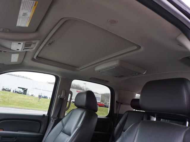

Well, an LTZ Tahoe ought to have 1 or 2 of those little vents right above the driver's head and to the side of the moonroof. 2 if the engine is an L9H.
I definitely have an LTZ and I don't have that vent. Perhaps the headliner was redone and they covered it. Also makes me wonder if mine is near the instrument cluster.
Thank you for the photo - I will double check that area. Even with no vent, maybe there is one up there.

I definitely have an LTZ and I don't have that vent. This makes me wonder if mine is near the instrument cluster.
How long have you had the truck and was the headliner ever replaced? I've never seen without at least one but admittedly doubt I've seen them all!
