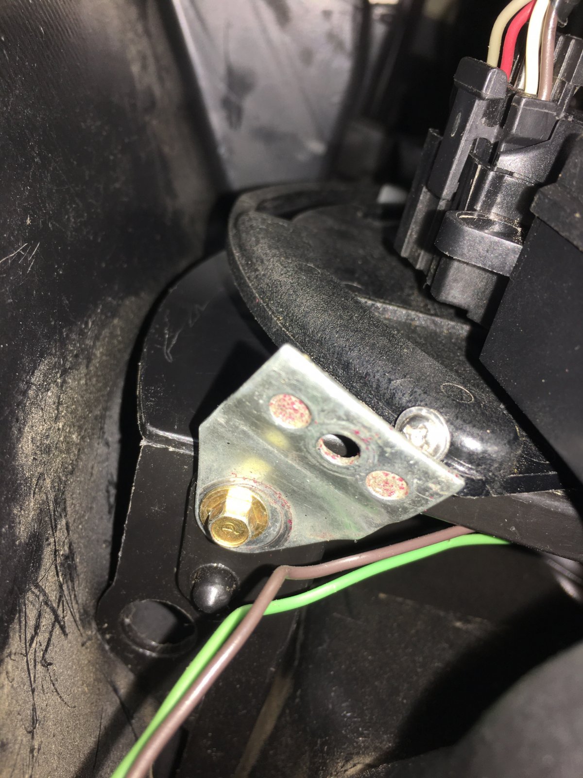

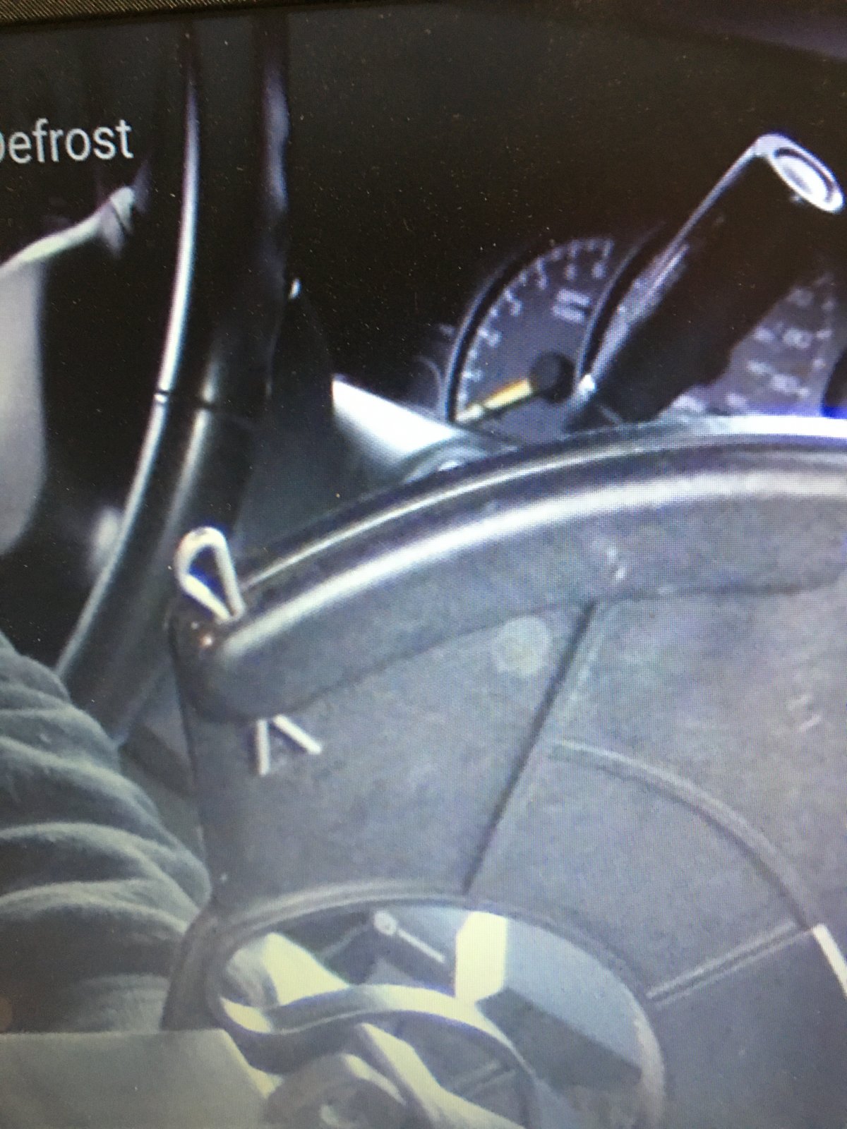

When I checked the Mode Actuator at the same terminals, I got 5.0 volts in defrost mode and 0.0 volts in Panel mode. The problem with this voltage it is outside the calibration mode range. So, to correct the issue when I install a small screw into the Actuator Damper wheel for the defrost travel stop and a stop bracket for the travel for Panel/Dash/Floor Air. I rechecked the voltage on Terminals #7 to #9 voltage as follows.
1: 3.71 Volts in defrost mode.
2: 0.27 Volts in Dash mode.
3: 2.44 Volts in Floor mode.
With the correction to the travel of the Mode Actuator which is the one located above the gas pedal. The HVAC system worked as it should, also the Rec. / Outside damper started working again. I believed the problem developed from the sealing foam on the Defrost Damper and the Dash Damper going bad, which caused the Actuator to travel outside its range. When I turn the HVAC fan on small pieces of foam would come out the defrost onto the top of the dash, the Yukon has 180,000 miles on it.
