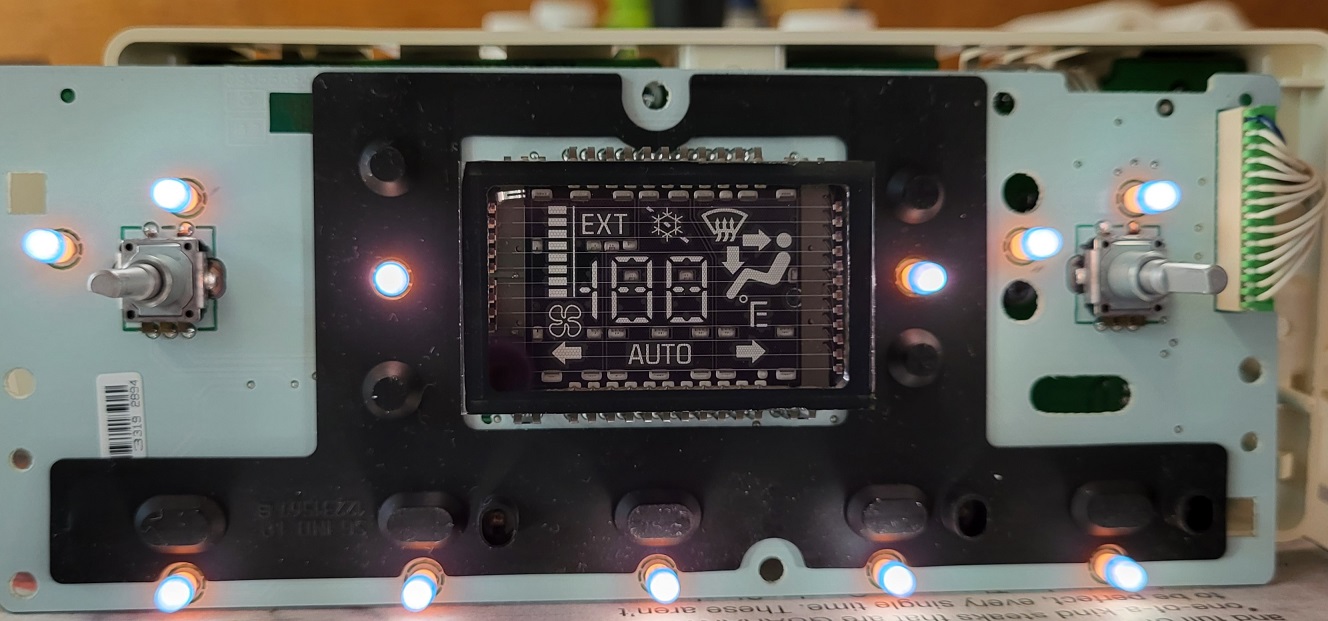

They're not that difficult to disassemble and clean. I had my AUTO one apart, cleaned the buttons and the two temperature pots, and replaced the bulbs (from www.carradiobulbs.com).
