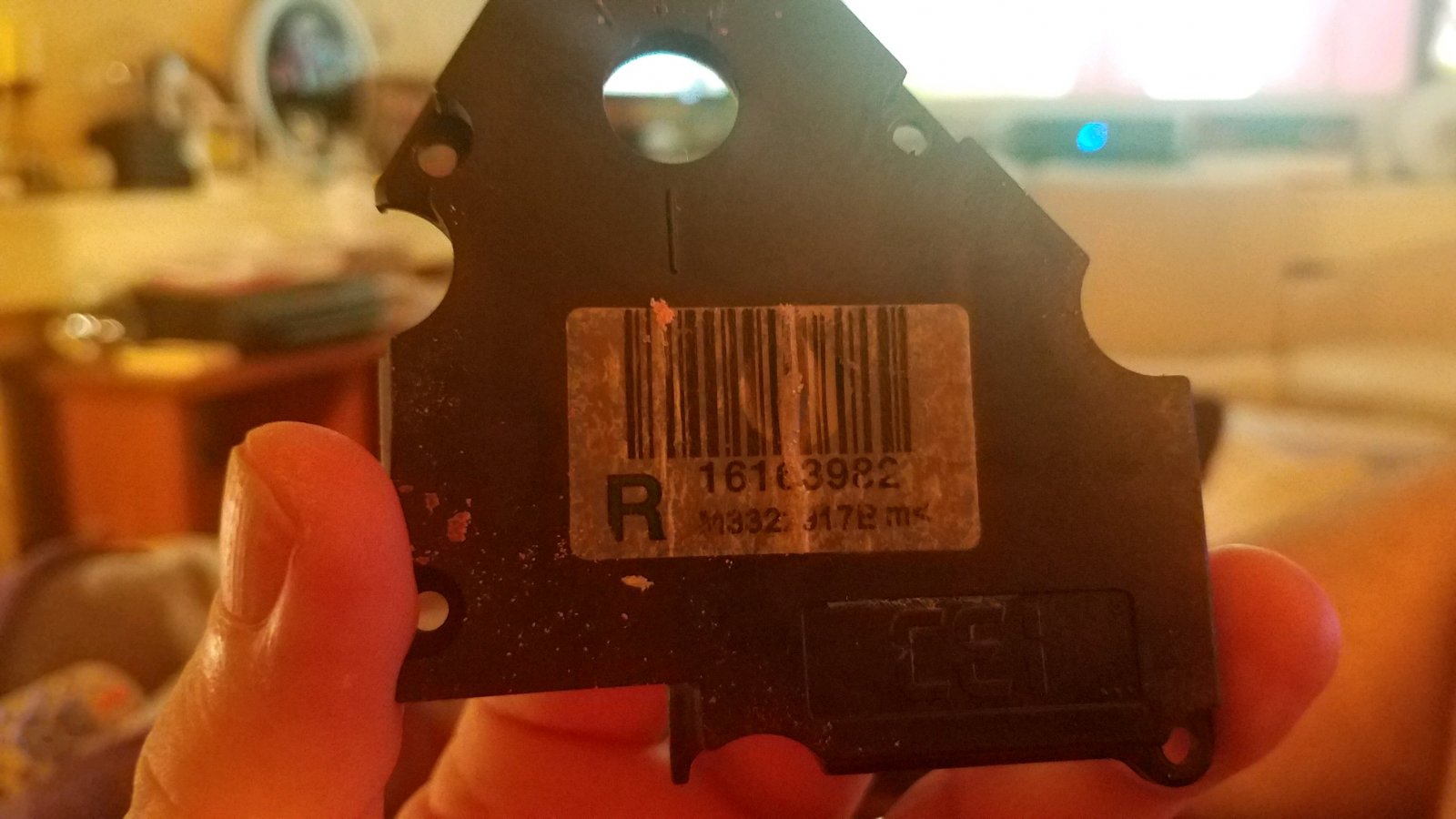

Found a pic I took of the original...
mattbta
Jun 19, 2012
1,185
2,217
Frisco, TX
The part number in your pic was replaced by 89018365, which is what I replaced my bad original (52402588) with in my 04 with auto climate.
