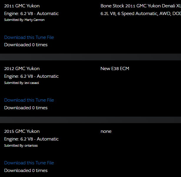

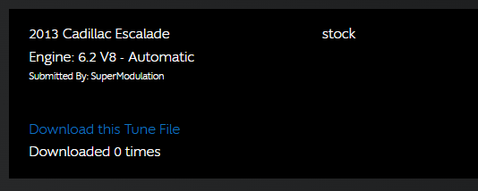

Create an account at hp tuners and sign in.
They have a tune repository.
Go to My account, and then you should see a button for it.
If you want, I could help you.
You don't want to just straight apply a tune from another vehicle.
What you want to do is to load up your current tune, then load up the "Stock" reference tune to see differences.
then copy paste values.
You want to find a bunch of different tunes ensuring you have a backup of the current "working" tune saved somewhere safe.
Compare differences, make sure you find one that's as close as possible...
Then when writing it, do a "Write entire"
If you were boosted, some of the differences might be in the "FSCM" option/third pull option.
I would say do a pull with all 3 checked, and then another pull leaving the "FSCM" option unchecked.
I don't see the exact year available, but I do see this.
Let me know if you need help with it, I'm pretty good at copy pasting in hptuners. :peace:
