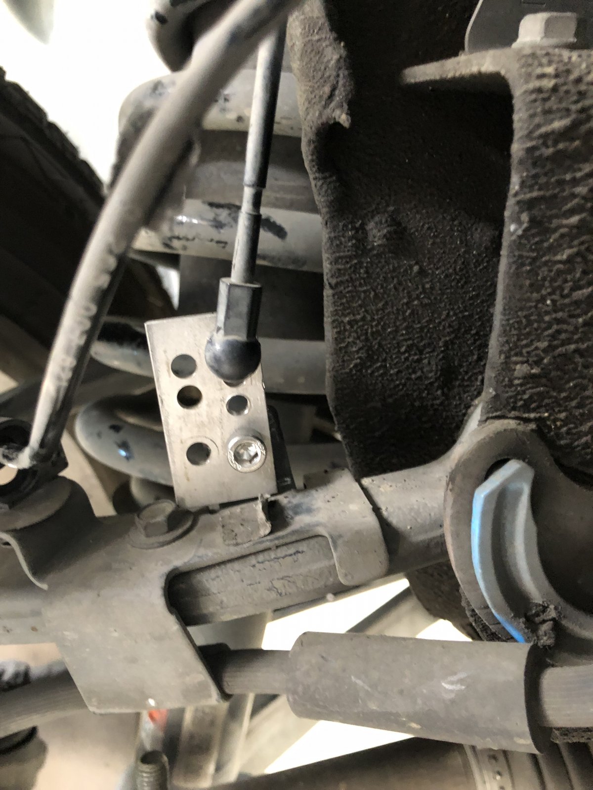

ok, i will go do that right now thank you! also here are some pictures of the brackets for the autoride. do they look correct?

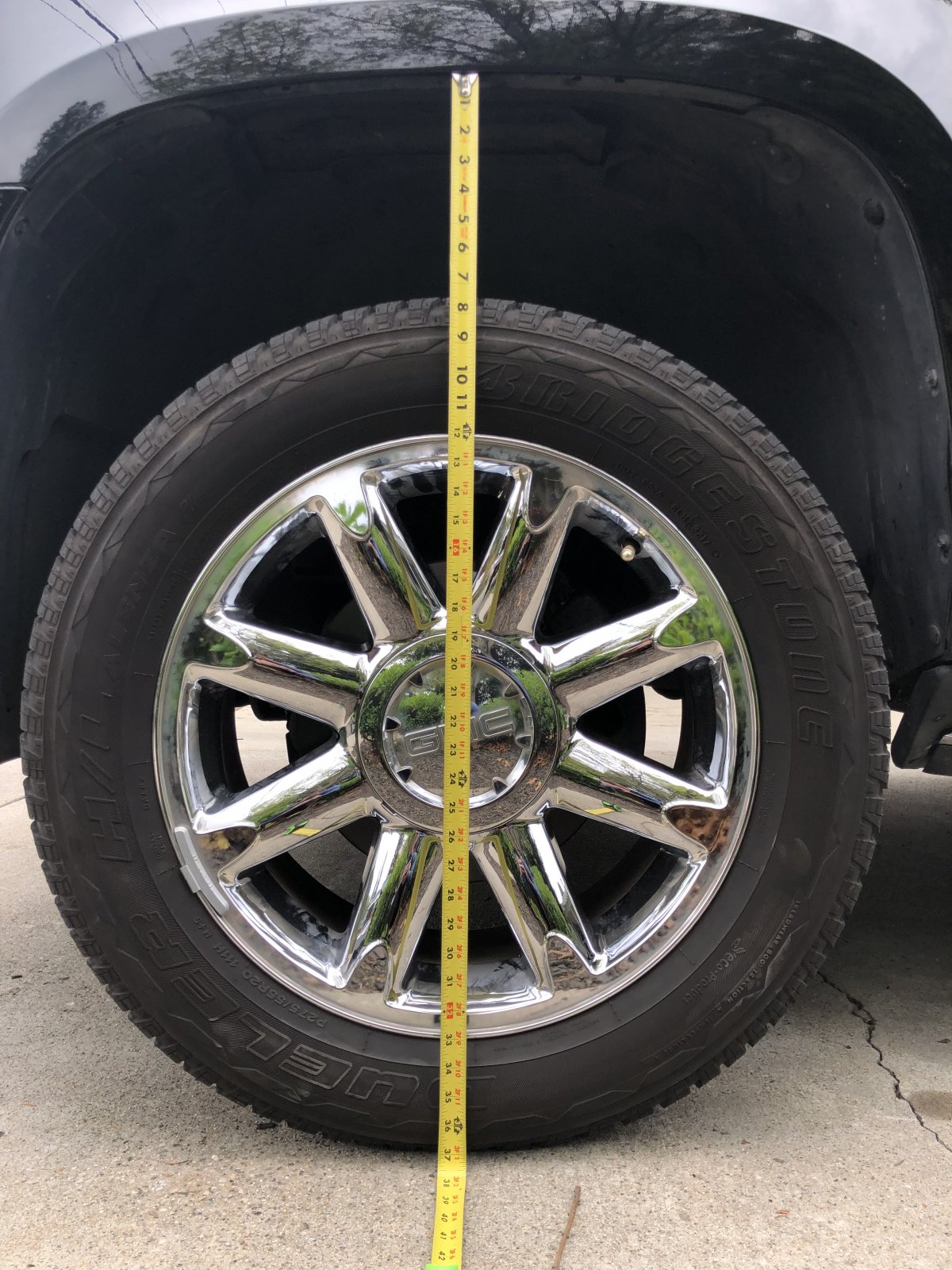

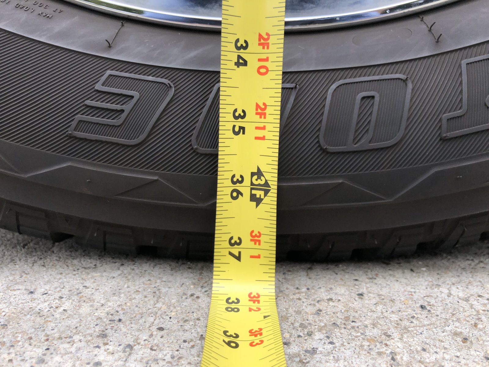

just measured both front and rear and got damn near the same height. both are measuring about 37" 1/4

Brackets look right. Maybe I’m mistaken on fender heights but thought most levels are 39”. That also depends on tire size. Most are 33s. The front fender is cut higher than rear so it looks like the rear sags when truly level.

tires are 275/55/20. Thank you for all the help.

That looks right for the tire size. You will gain an 1” off tires swapping to a 275/60R20. If you want to push the tire size and go up in weight then a 295/60R20. You will probably have to trim to clear the but will fit on stock wheels.
