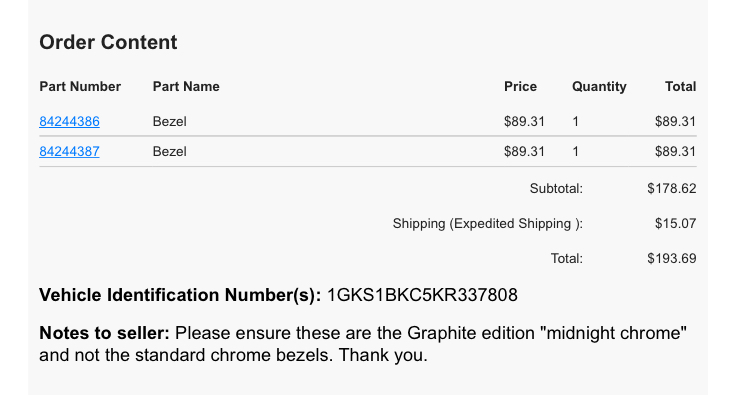

Good write up. Where did you get the Graphite edition Fog light bezels? I already have the Graphite edition grill so the Bezels are the last thing I need.
See screen shot of part numbers. You can use that vin too, I pulled it off a graphite edition from the dealership.
