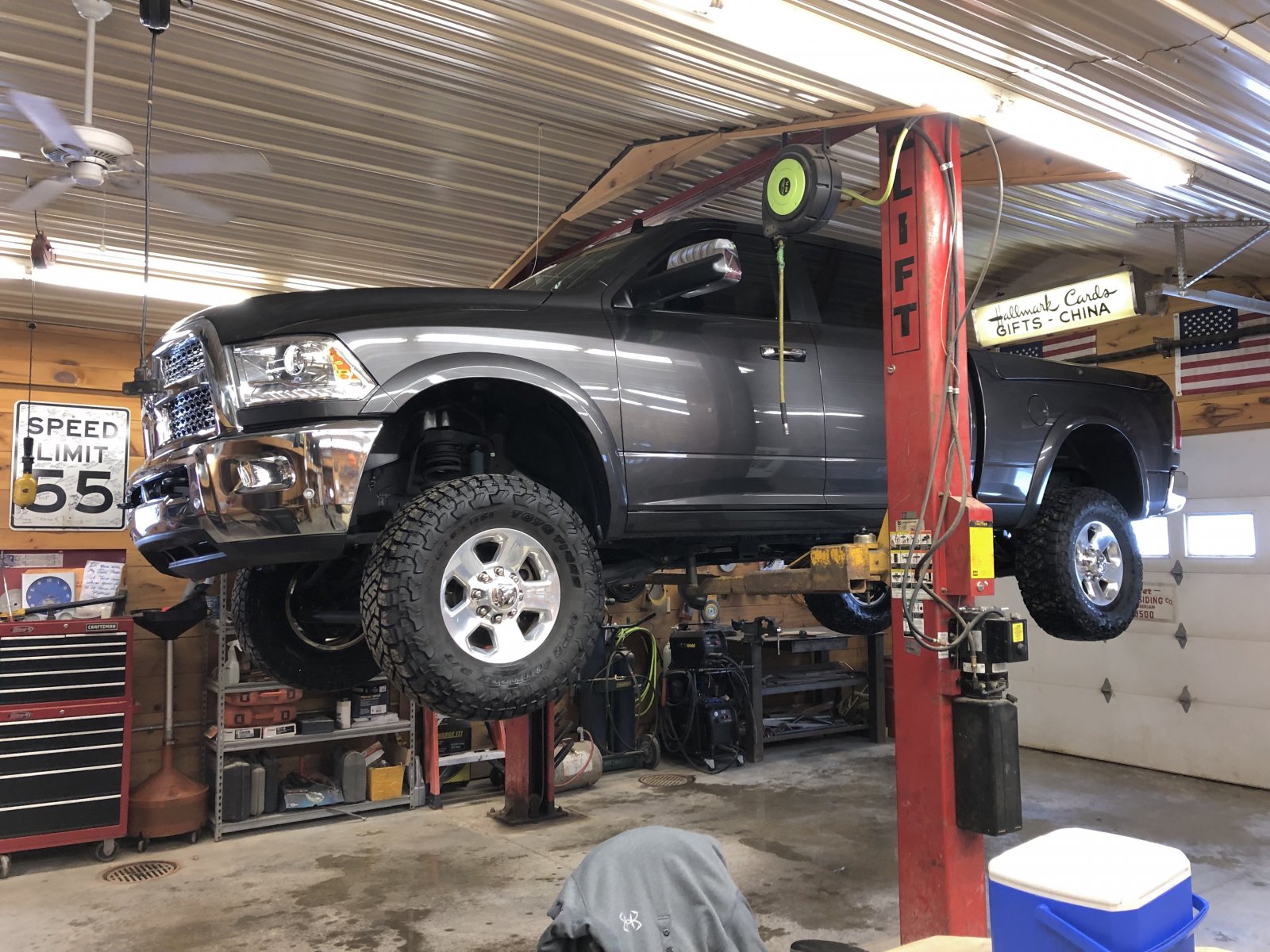

Yep. True rust issues start from the inside of the body panels…rockers, fenders, doors, rear hatch, and cab corners of trucks etc. Salt water from driving on the roads gets in all those nooks and crannies and never gets washed out, no matter how much you go through the car wash or spray the underbody.

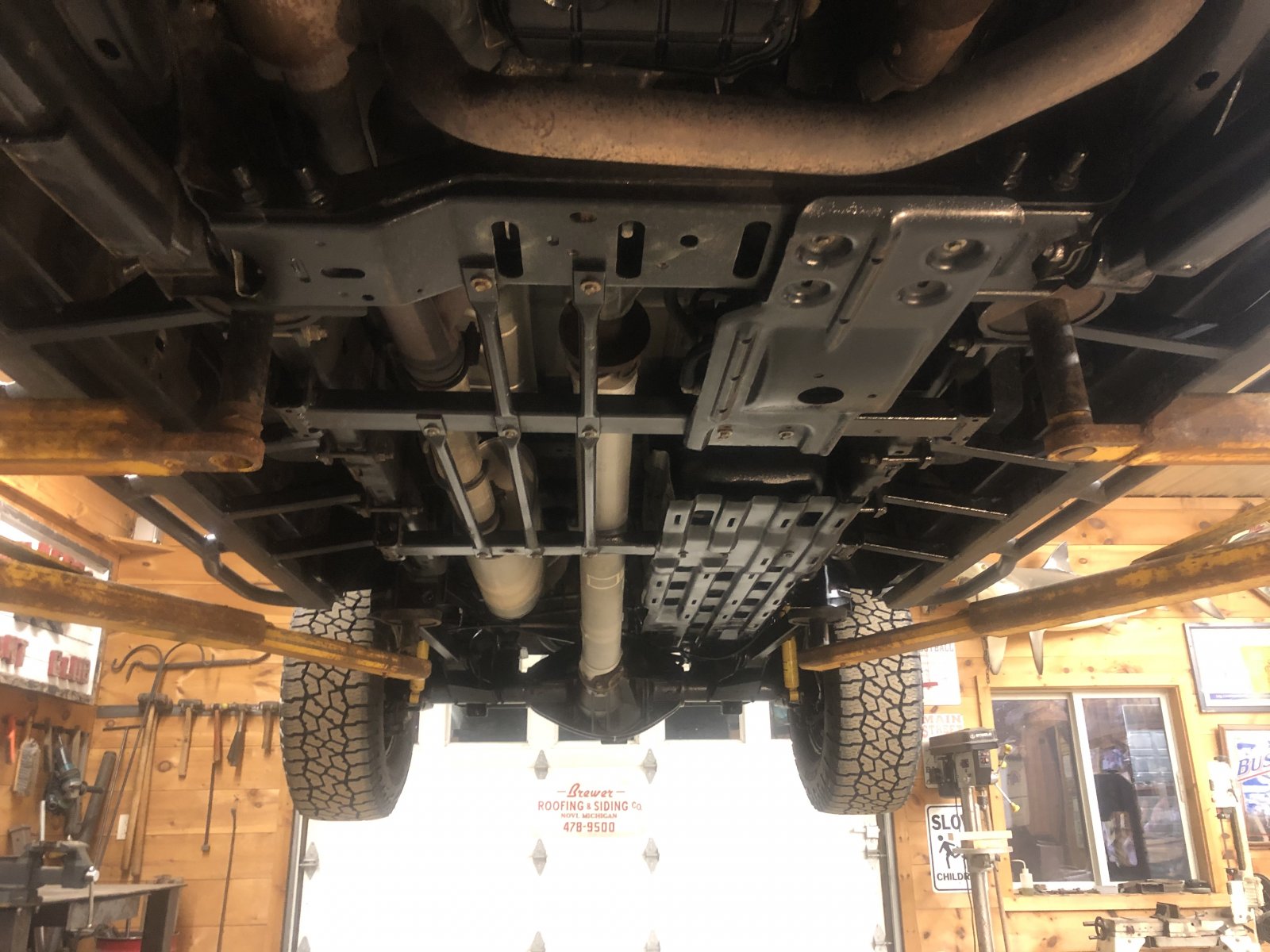

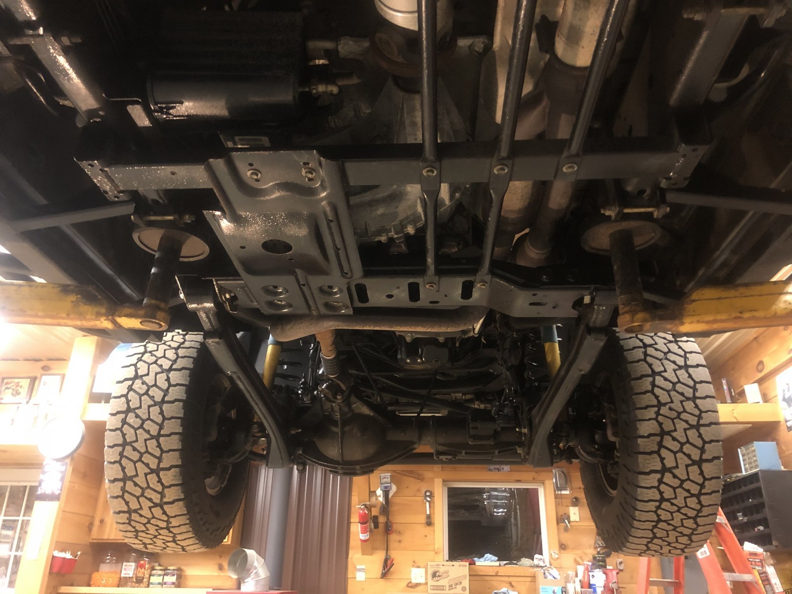

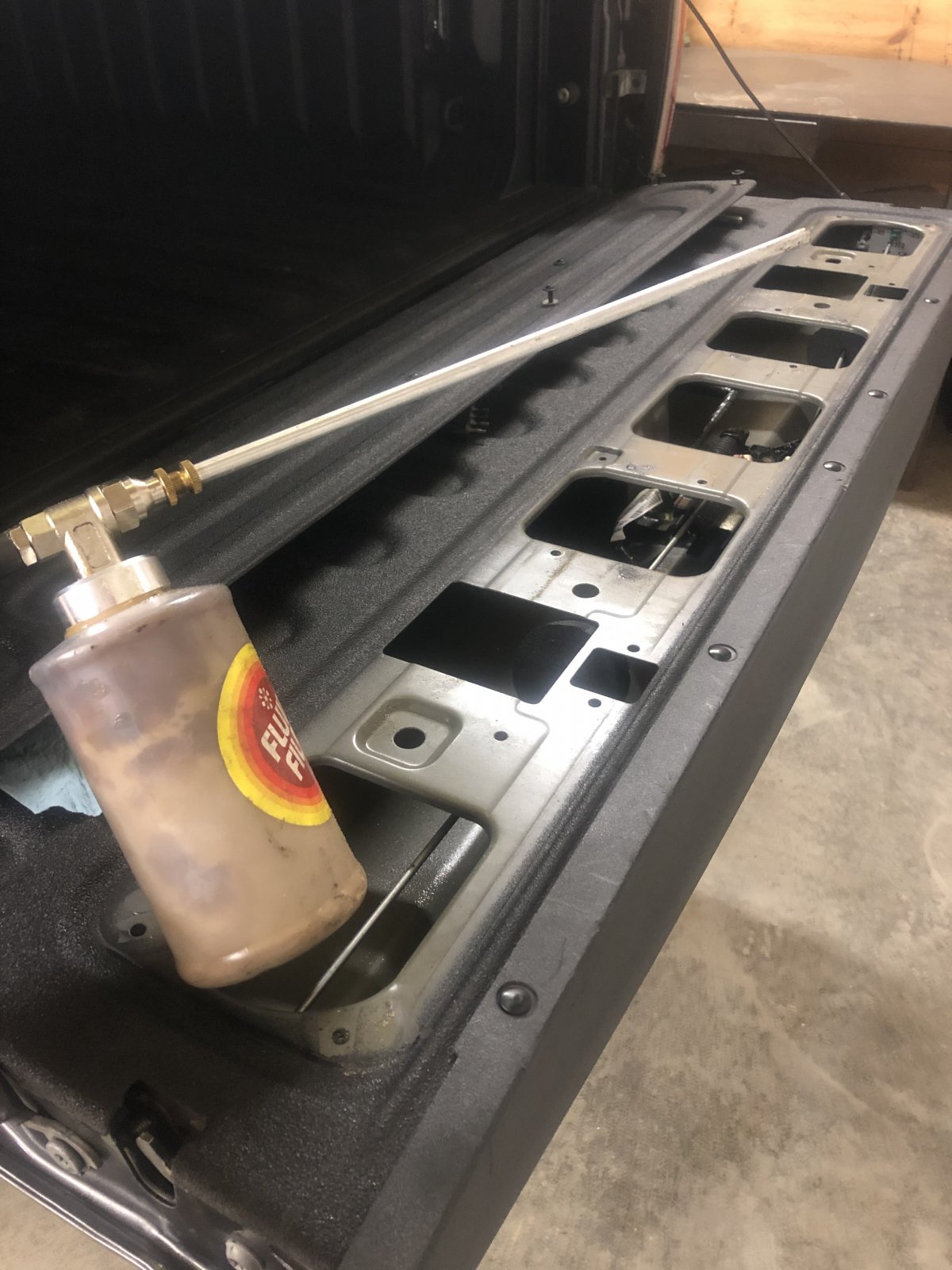

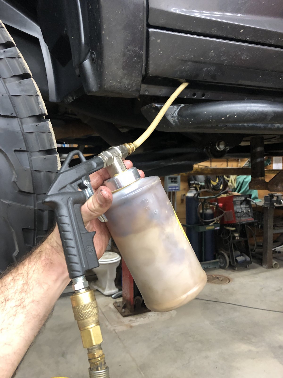

I bought my power wagon brand new, and have applied fluid film to the entire underbody, as well as inside the the rockers/cabcorners/fenders/doors etc. using a small flexible wand/spray gun that i purchased online. She just went through her 8th northern michigan winter…no signs of rust yet!!!! Put her up on the hoist and spray away!!!
I do this once a year in the frame, door drain holes, rocker panels everything every fall

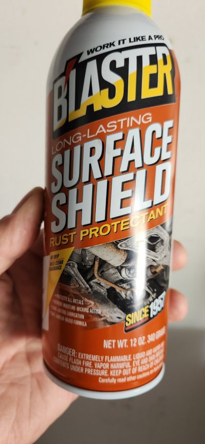

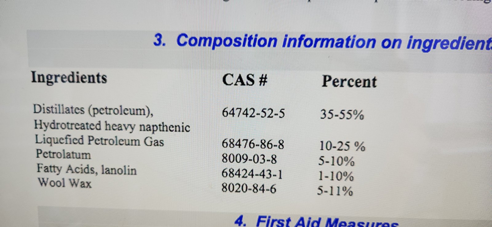

PB Blaster Surface Shield.
It's a lot like Fluid Film, but a different composition which I can't remember off the top of my head. It stays on longer then Fluid Film and doesn't wash off as easily by road spray or car washes

If this is a photo after 8 winters, then why do the untreated bolts not rust?
Some of those pics were from this last winter, and some were from the winter before.
What do you mean untreated bolts? I spray EVERYTHING (except do my best to stay away from the exhaust and brakes). That being said, after several months most of the high spray areas get kinda worn off. So there are many areas of my undercarriage which do have typical surface rust. But as far as in the body panels (which is what i care about the most), at the time of application each year the stuff from the year before is still sopping/saturated inside.

I see in the photo the processed parts of the frame and underbody of the car. and here are the bolts. They look like new and untreated. There's not even dirt. Well, this is strange for me.
Because the material is different? Frame parts are probably painted and screws are electrolytically protected.
In addition, screw heads protrude and can dry more easily.
It often rusts where sand and mud collect. Because this keeps the sheet metal or steel moist.
You can easily test this by taking an untreated sheet of metal and wetting it with a water hose. If it hangs so that it can drip and dry, you can do this again and again for decades without the sheet metal rusting through. It will form surface rust but will not rust through.
On the other hand, take a painted metal sheet and put a pile of mud on it and leave the metal sheet outside. Despite the paint, the sheet metal will have rusted through in a few years, because the mud constantly retains moisture on the surface.
That's why it's important, among other things, to clean the cars underneath regularly with a high-pressure cleaner, especially the places where mud settles in the whell housings.
And it is very important to protect the cavities, because water draws in there simply through condensation, but it has difficulty drying out and as a result cavities often remain moist for a long time. Cars usually rust in places where mud gets in, or from the inside to the outside where there are cavities.
Nope, can tell you for a fact those bolts are original to the truck. I bought it brand new. No, not much dirt…I definitely keep my stuff as clean as i can haaaaaa.
