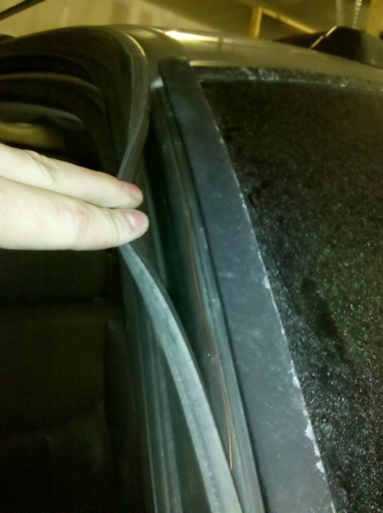

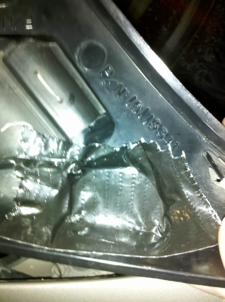

I wraped some copper wire around the base and ran it up through the weather seal to get better reception. I get better reception than with the original antenna! Esky piece is on order...for now i put duct tape over the hole

I did this mod a while back (with the Esky cowl corner) and did the same as what 05nali did with the wire in the A-pillar gutter, but with insulated wire...perfect!

Did this awhile back, and loved the look. Reception got real bad so had to put the antenna back. like previous,hated that antenna, so i got some wire wrapped it around the base and ran it up the weather seal. just used regular speaker wire i had laying around. now sounds better than stock. Great mod
I did this yesterday, but I used some light ga. speaker wire I had layin' around. When I would "seek", only two radio stations were in tune enough for the radio to stop "seeking".
Do you think if I used a heavier ga. wire it would help? I ran it up the molding and left 1/8-1/4" sticking out of the weather strip. Any suggestions?

Did you put a wire on the antenna ground, because when i did it, stations did not come in clear. I crimped terminals on the two ends and put them on the antenna with a nut. Then I stripped the other ends and joined them making a loop. Stuck them in the weather seal and works good. Even AM comes in clear. Just dont ground the wires, and you should be good.
All I did was put an eyelet on the wire I was using and put it on the stud that the antenna screws on to and held it on with a nut. Then ran it up the door seal like 05Nali did.

I would use maybe thicker wire and make sure you have a good connection. Mine was bad without a good connection, but its working great on mine still. I couldn't be happier
