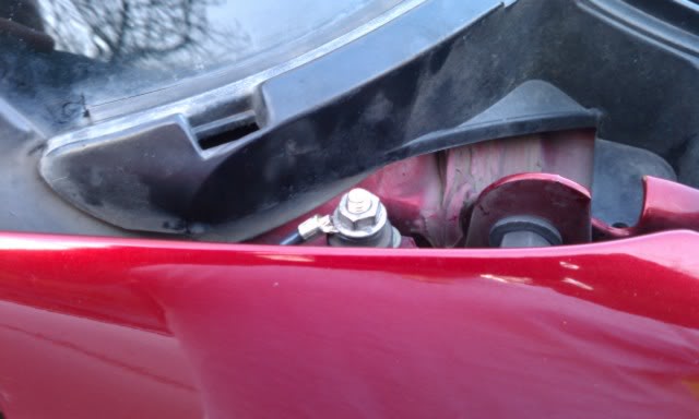

Does the copper really work, and how can you protect it from getting rusty?
I just pulled that one out of the blue. Makes sense though. Or some conductor. Insulate it? Paint it the non-contact surfaces?

I just soldered a ring terminal onto a 10ga stranded wire...I'm not sure it'll really matter how the wire is connected but I like to solder everything...lol...
Morgan Hill reception is crap even with a stock antenna in the stock location. I pick up everything now...
Larger gauge wire seems to help a little. I did try speaker wire first & it was about as good as the stock antenna.

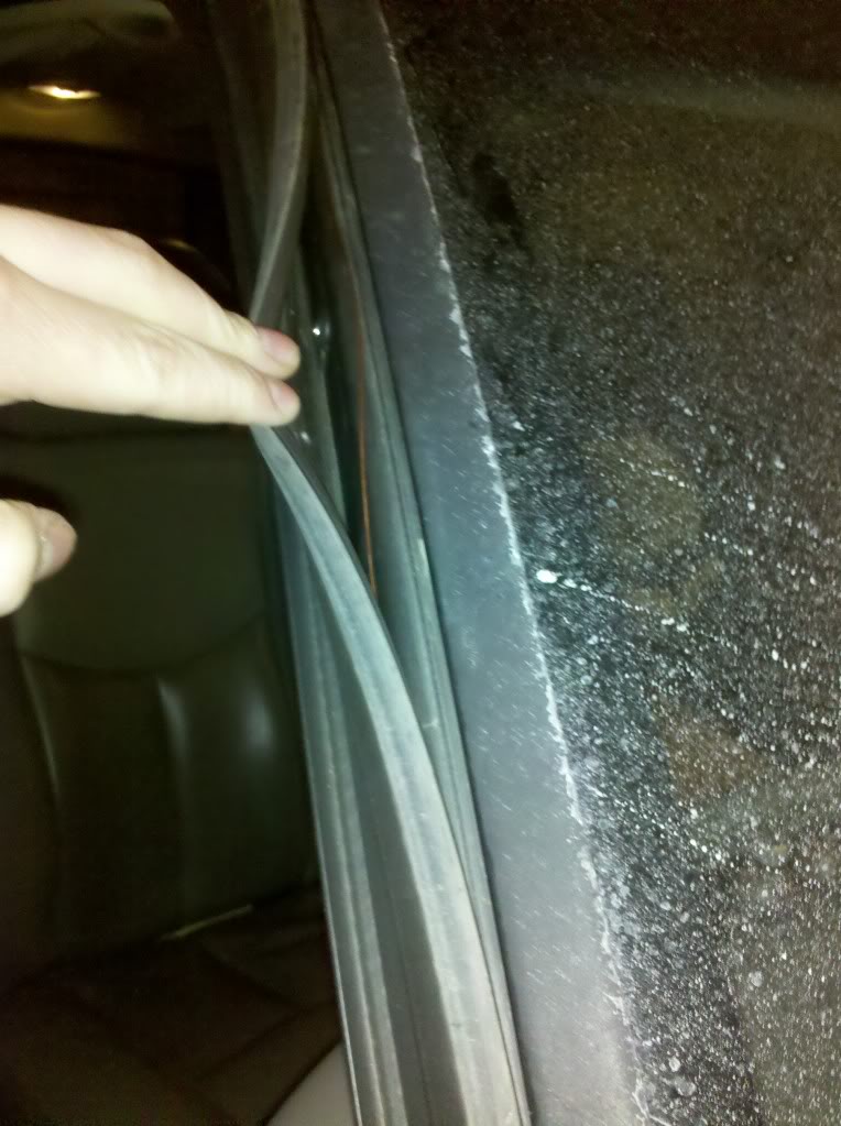

I went this route. Just because of the chunk of old wire I had, I ran it along the weatherstrip to the end of the door. A buddy that's an amateur radio guy said that it would work fine even if it was shorter. And it does!

I wraped some copper wire around the base and ran it up through the weather seal to get better reception. I get better reception than with the original antenna! Esky piece is on order...for now i put duct tape over the hole
