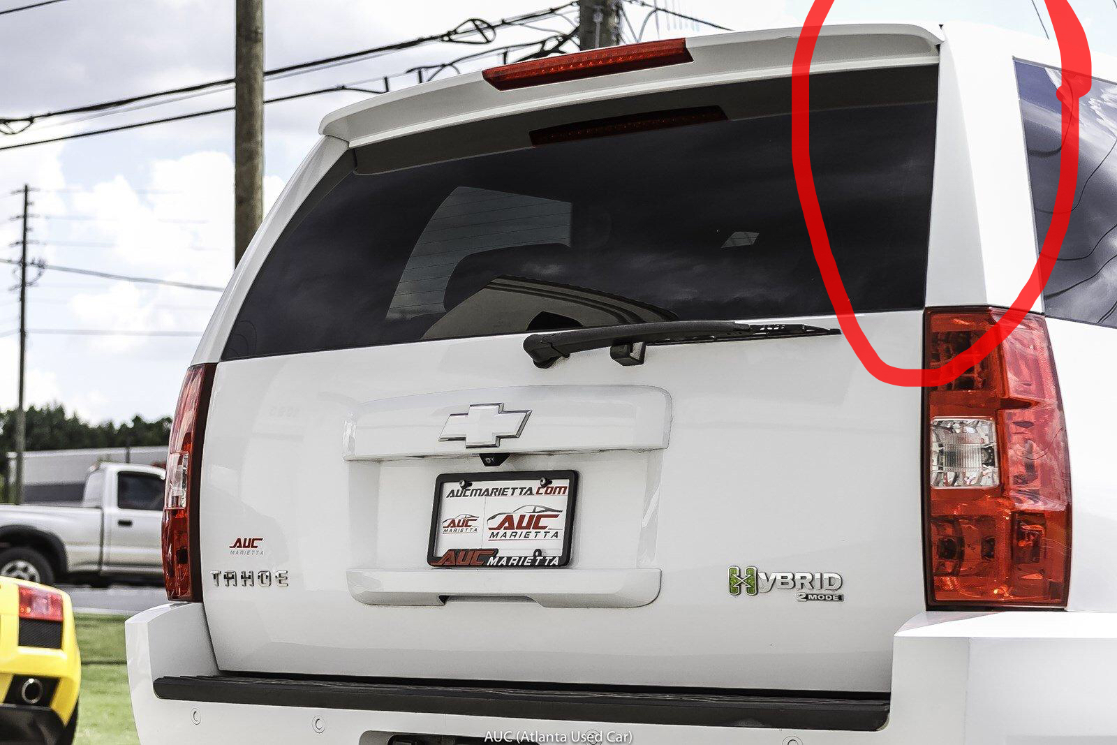

You’d be in the same situation. You’d have to swap both the hybrid lights as well as the upper appliqués and I think the third brake light too

looks like the hybrids have a different shape than the standard tahoes and require the upper appliques to fit right. if not they are still just as ugly as the oem ones. id rather buy some aftermarket led lights over the hybrid ones.

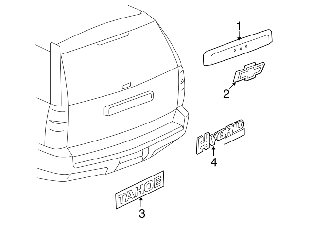

what does the applique have to do with the tail lights
you referring to part#1 on the image correct?
No sir I was talking about the piece above the tail. It’s got a hard body line that starts in the light and runs upward into it. Makes sense about the leds and all. I like the smoother clean look of the Escalades and think the oems looks lumpy.

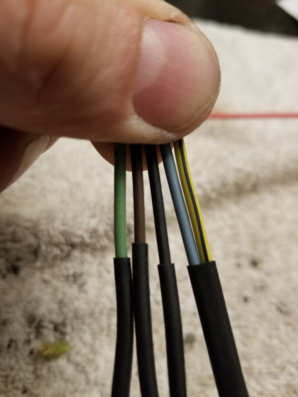

I just built the harness too... And had the same problem...
Fix :
I removed the 5 pin to 4 pin harness compatibility and matched the wires accordingly...
I left the two stated wires disconnected (per diagram) but attached the Brea and tail together...
I do have the hyperflash at the moment but it's bc I have led everywhere and have not tackled the resistor issues yet.... The lights however work flawlessly...

The only change I found to make this all work with ease is the yellow and blue wire... Tied together...
I can take more pix if anyone needs further help

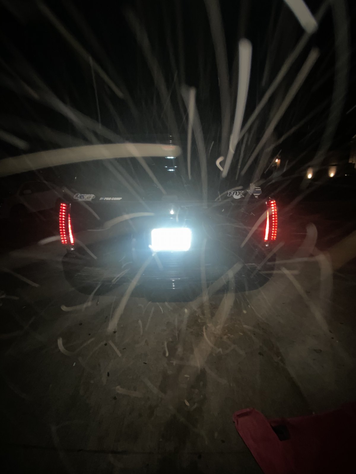

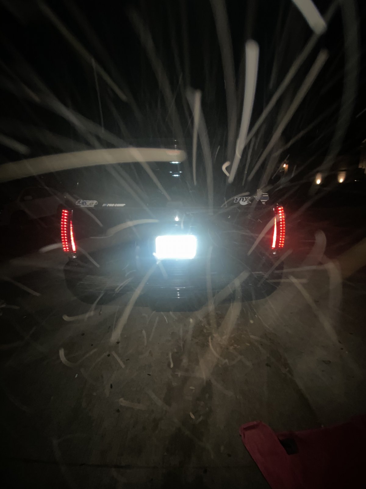

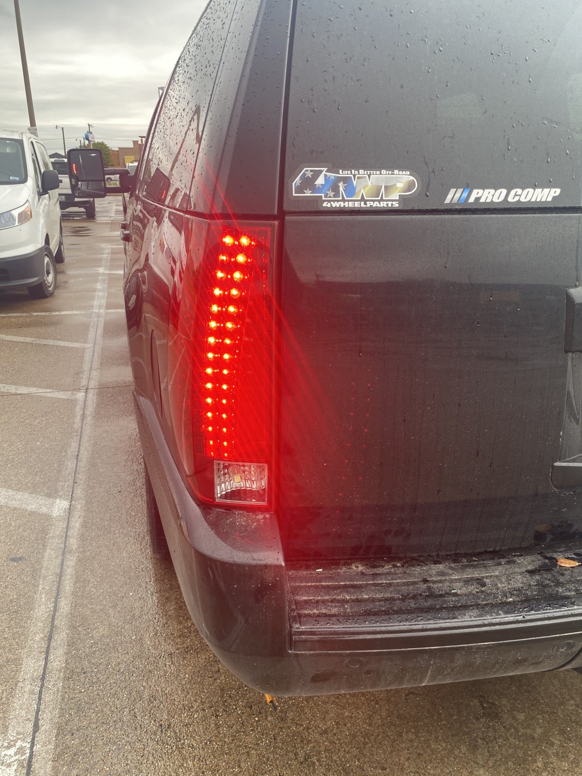

Finally did mine. Used the 48895 and the one resister doesn’t far , it all works just fine
I’ll get more pictures tomorrow
Looks good, I think.
What’s up with all the streaks in the picture? It looks like you either have a bunch of paranormal activity going on or your jumping to hyperspace.;)
