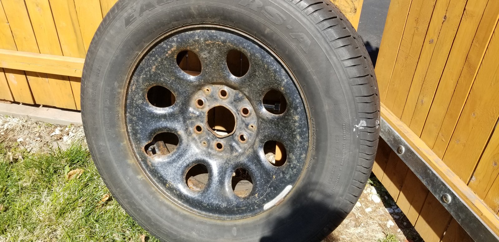

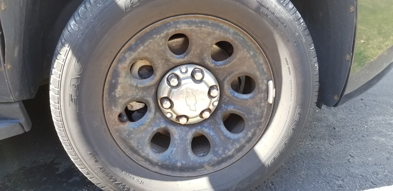

Please see the attachment.

In all honesty, just from the pictures. I'm not sure a cleaner will do the trick.
It looks like they are rusting through faded and peeling.
My wheels looked similar to yours, there was too much loose debris and bare metal exposed for me to even try to clean them.
As for what to use. I have some Chemical Guys Honeydew, VSS and Jetseal. Haven't tried it on my wheels, will give it a whirl after I repaint them. Basically set up like your washing your car. Clean thoroughly with good foam and bristle brush, clay bar, clean again, rinse and dry (quick version). You can compound them, then polish then wax.
You could try some 3m compound to see what it does. Use a hand applicator and try it out.

Yeah those are years past a clean and be done.
Like the others have said those will need to be prep'ed and painted
The Dorman replacement wheels are on RA for $78 ea
