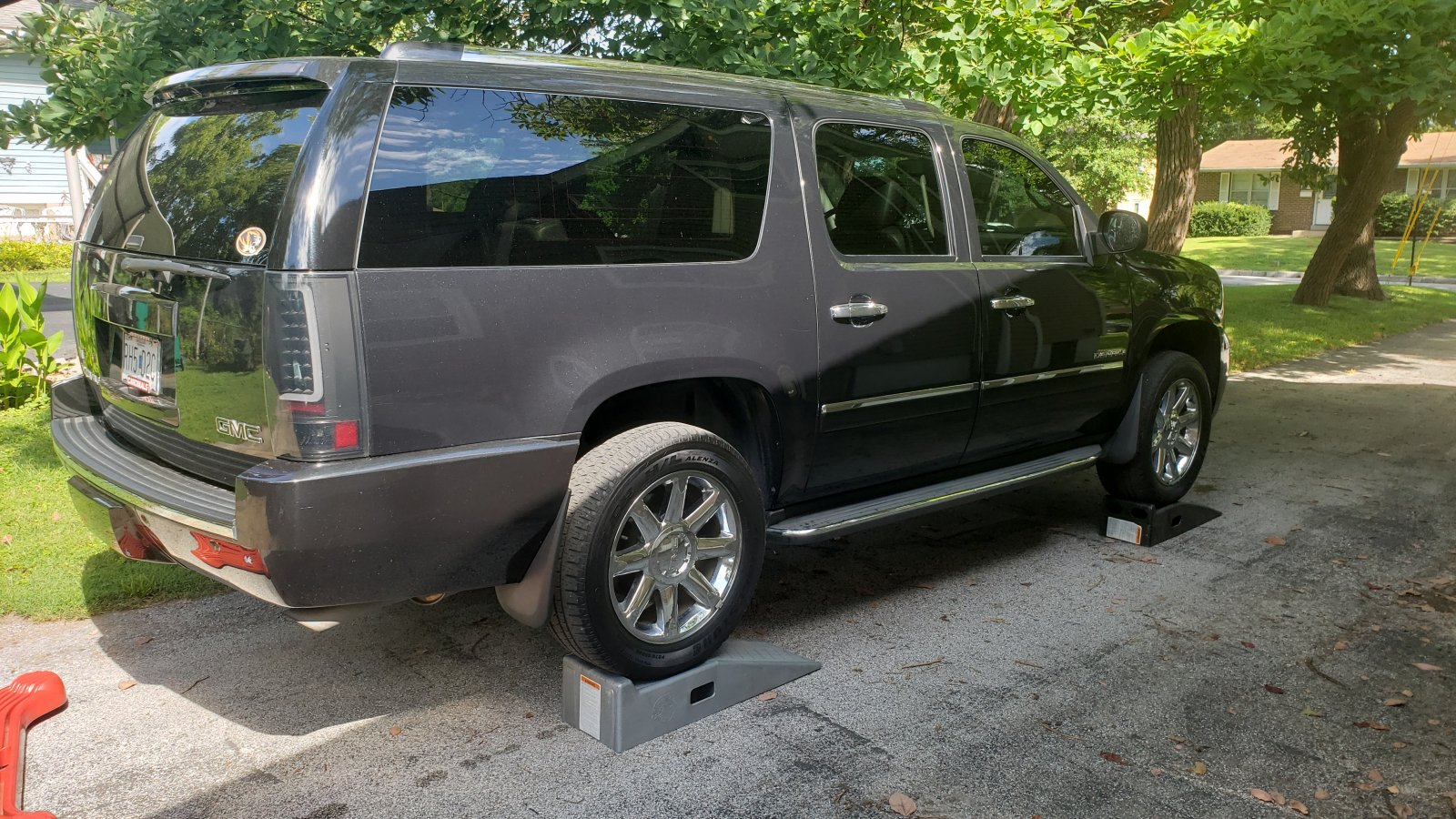

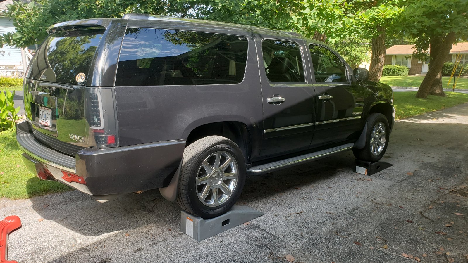

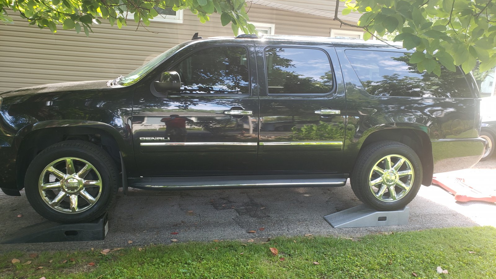

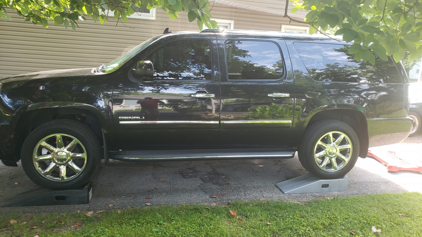

I don't use a floor jack for anything I'm going to be under and jackstands just get in the way. Get a good quality set of car ramps. You'll have more room and never worry about anything being suspended or held up.
