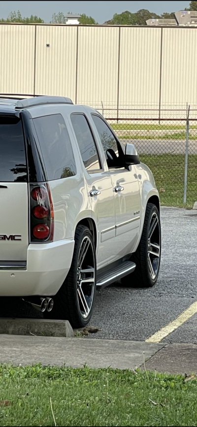

2/3 would be about as low as I’d go with a 295/35/24 to avoid having to trim fender liners, fenders, etc. You might have a slight rub if you hit a dip at full lock but it won’t be anything major

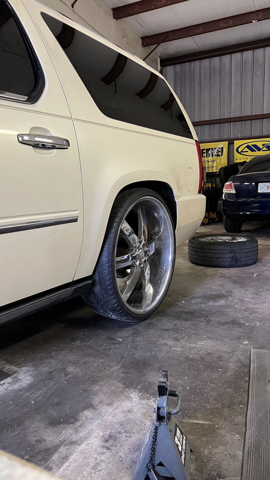

This is a 3” drop with a 28” wheel. Its 1” taller than what you want to run and it rubbed slightly at the front of the quarter panel so you should have plenty of space with a 295/35/24

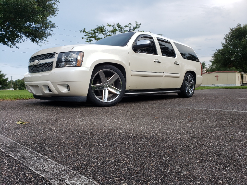

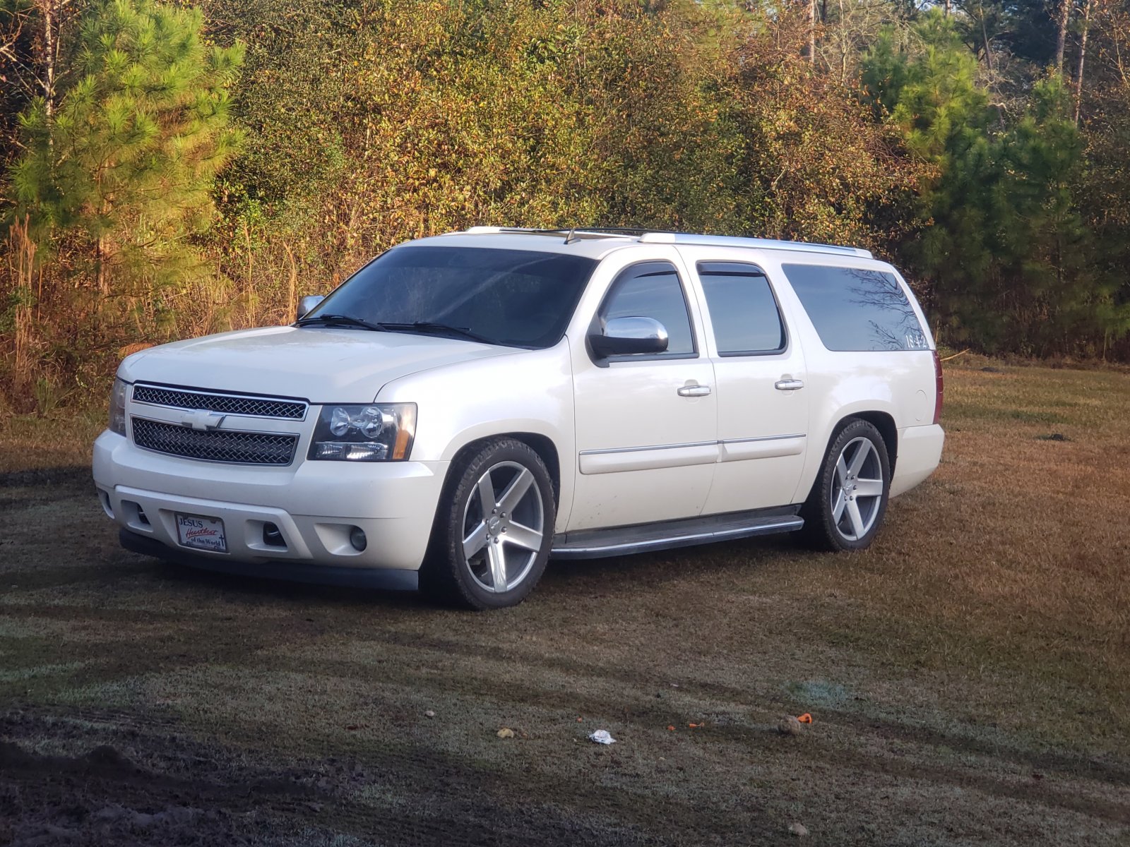

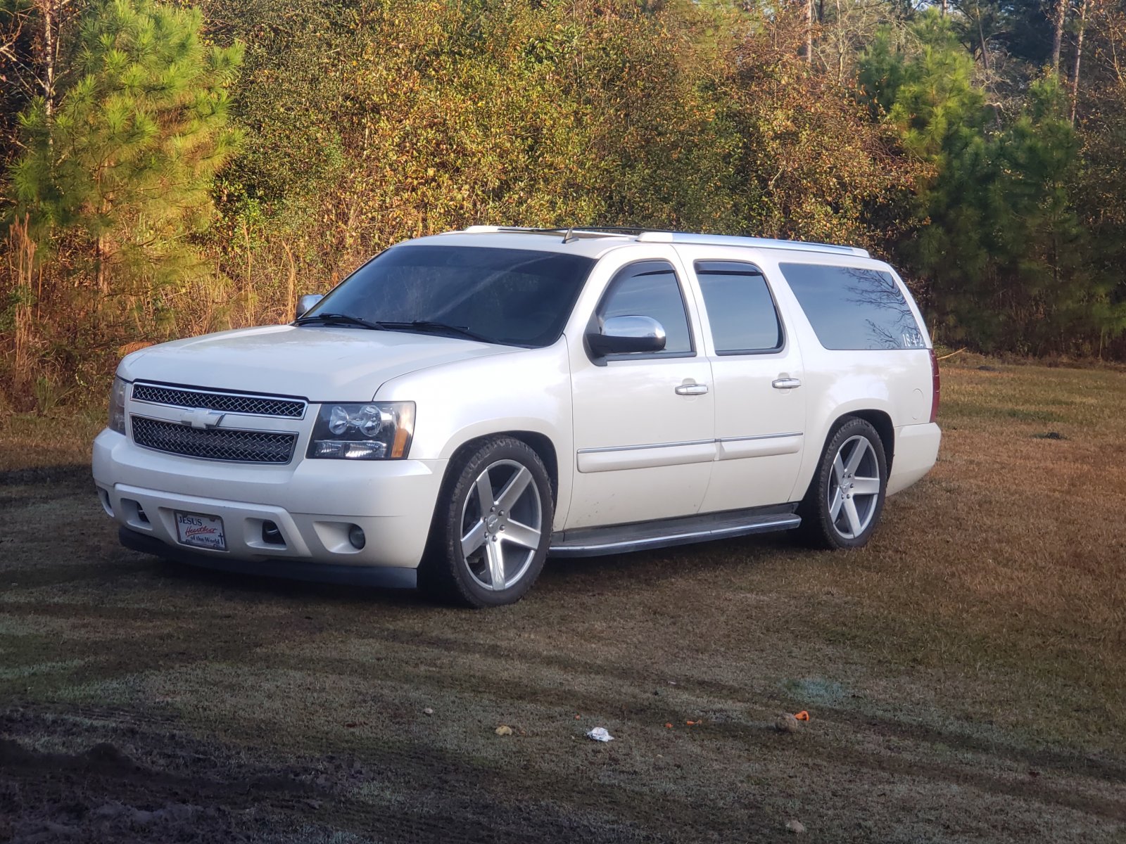

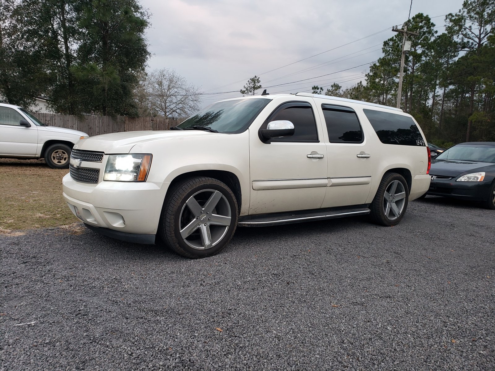

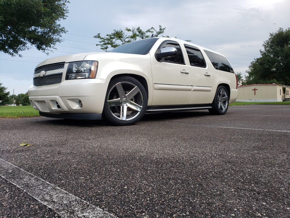

I have never ran 24s, only 22s.
I was running a 4/6 drop on 285/40/22 tires with zero rubbing. I did do the "Norcal" mod to the front.
After swapping tires out to a 305/40/22 it rubbed horribly so I lifted the truck up 2" all the way around and am now at 2/4 with no rubbing.
I am not certain how all of this may relate to your wheels and drop BUT I was tagged so I figured I better respond so I don't end up in trouble with the boss... @89Suburban .... lol
2/4 on 305/40/22s
4/6 on 305/40/22s right before being lifted 2"
4/6 on 285/40/22s
I loved the 4/6 drop. The only reason I changed to the 305/40s is because I wanted to try the Michelin tires and they didn't offer them in a 285/40. They did have a 295/40 but the cost was literally twice as much as the 305s. 305 = $232 each and 295 = $465 each... crazy.
After these wear out I will probably try to find some 285s and go back to the 4/6.

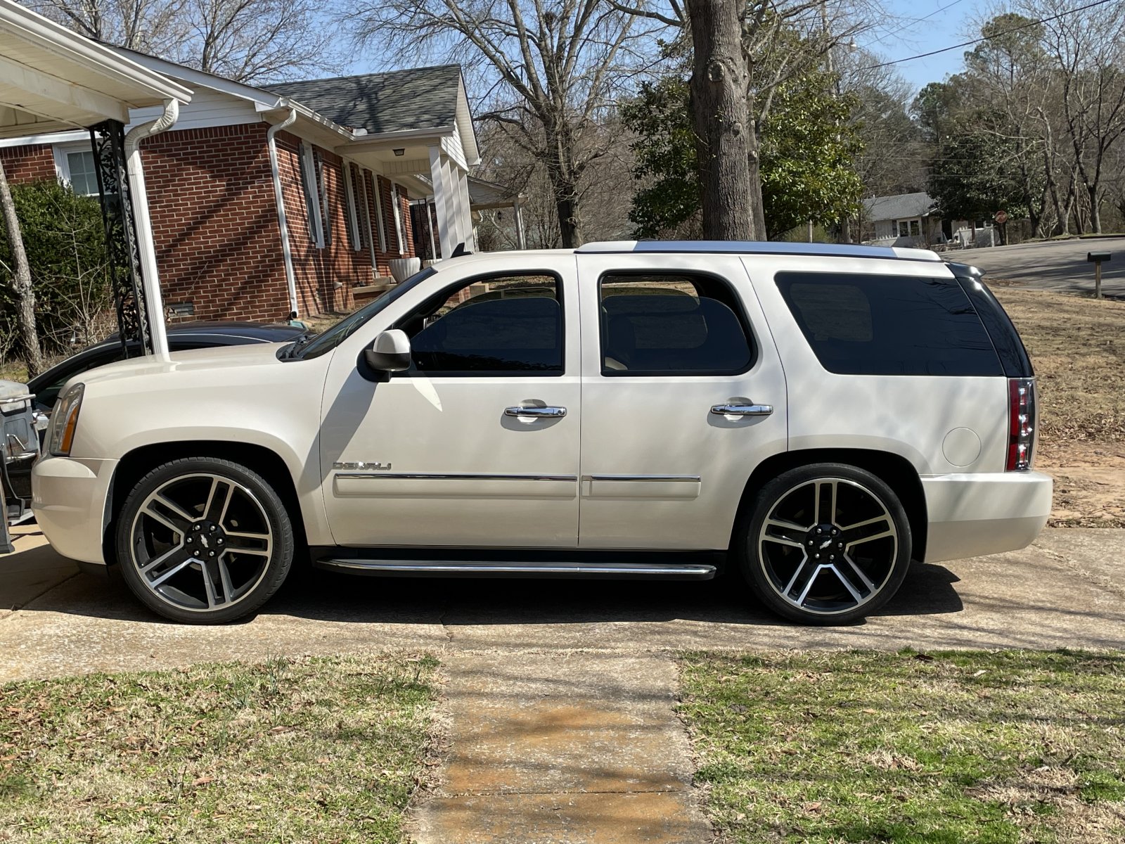

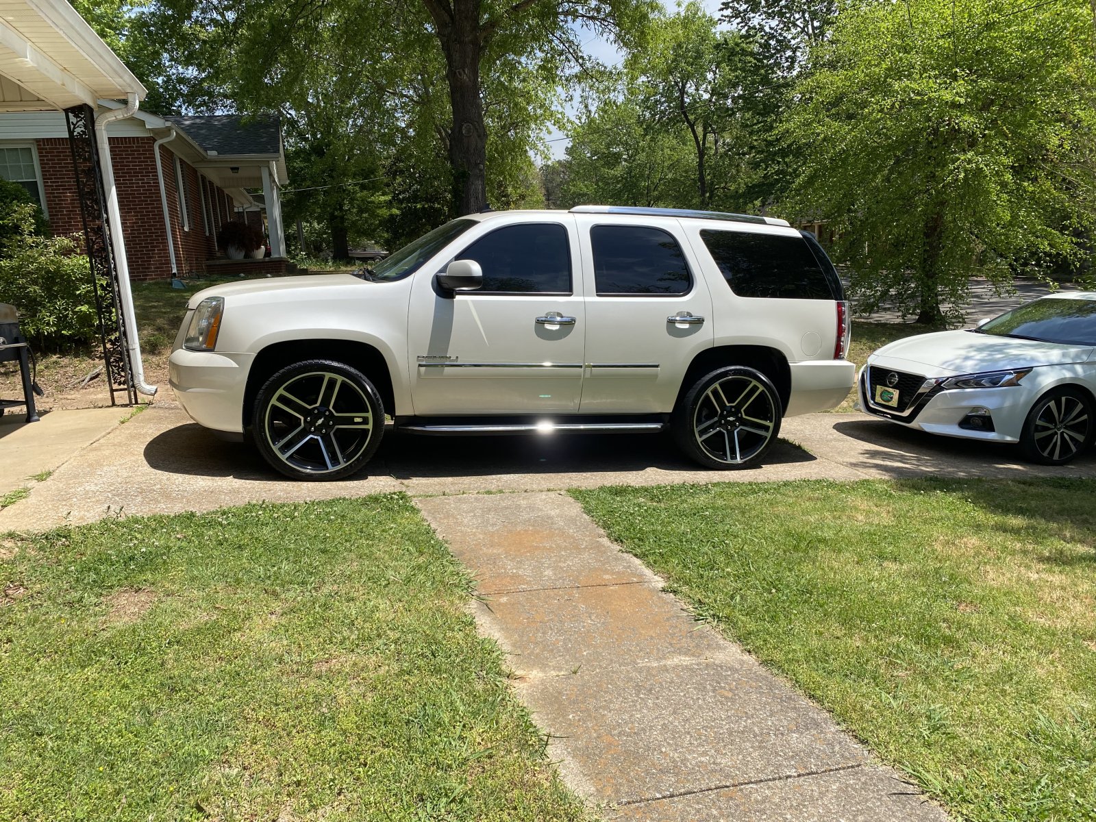

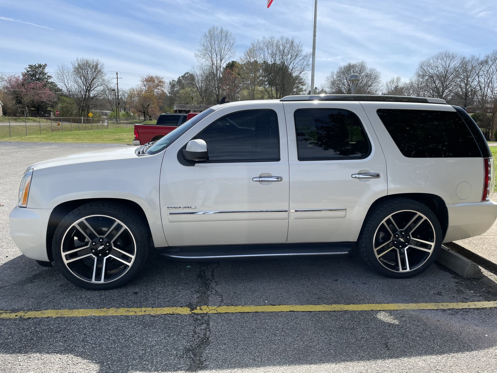

Here is mine. Belltech 753 kit.2/4 drop on 305/35 24. Rubbed bad in front until I heated and pushed the liners in some. Now only rubs if I turn to far. Not a big deal. Back rubbed some so I trimmed a little and installed 1/4 spacers. I had 295/35 that were wore when I did the drop and had plenty of clearance in the front. Here is a before and after. First 2 are 295/35. Last 2 are 305/35

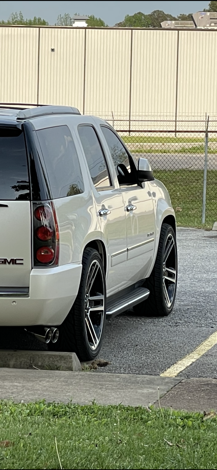

I'm on 305/35/24 with 24x10 +31, dropped 2/4. Front rubs only on lock to lock.
If you are dropping for looks, drop spindles are the way to go. If you are lowering for performance reasons, the DO NOT get drop spindles. Look at DJM suspension for lowering front A-arms. Tubular and includes poly bushings.
I'm on my racing wheels at the moment so she is showing her gaps (285/30/ZR22)
