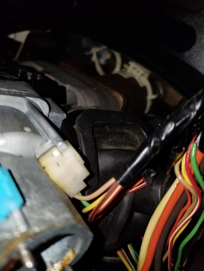

I'm having to remove all the wiring around the steering column so I can replace my clockspring harness. I'm down to the last item but I can't figure out how to get it out. It's got a plastic pin that drops into the ignition cylinder and I'm afriad to break it. Is there an easy way to get it out?

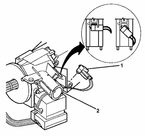

Ok, I figured it out for anyone that needs it.
Remove the key alarm connector (1) from the lock module assembly (2) in the following way:
1. Rotate the key alarm connector (1) 90 degrees.
2. Pull the key alarm connector (1) out of the lock module assembly (2).
Also, note that you need to put a little flat screwdriver on the left side to push in a clip before you twist 90 degrees. You can't just twist it.
