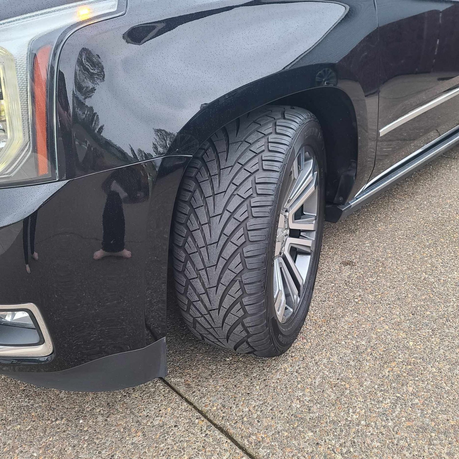

Interesting. I'd have to check the specs on the LS, but i find it highly unlikely the results would truly be the same if the tires are wider and have shorter sidewalls and the dampers are upgraded.
Maybe different days, different weather, rubber build up, moisture... I can drive awfully stupid with our RST and have plenty of control. Heck, even with the trailer it's super solid.
*Ohhh... 2018. That's previous generation. You are only going to do so much with a solid axle. But that doesn't necessarily correlate to a stiffer ride.
** Wandered out of latest gen forum. Mea culpa! Closest i got is going to 16 inch wheels from 15 on Astro took out a lot of roll...
