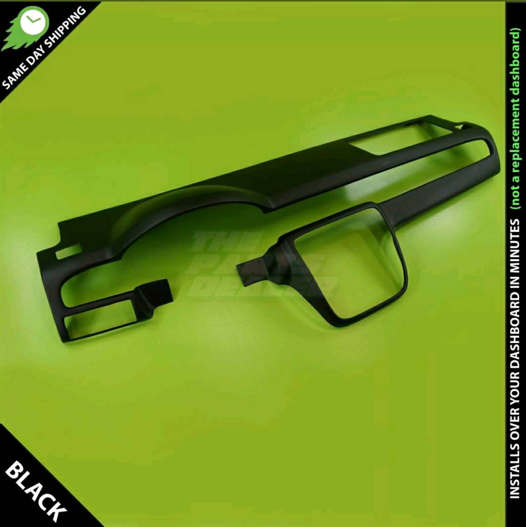

Hi all, new to the TahoeYukon forums. My Tahoe has a cracked dash board. It looks like this is a fairly common problem. How did everyone else address this? I see that there are several different CAPS available. It doesn't appear that there is any real fix for it. What is the best manufacturer for the caps and why?

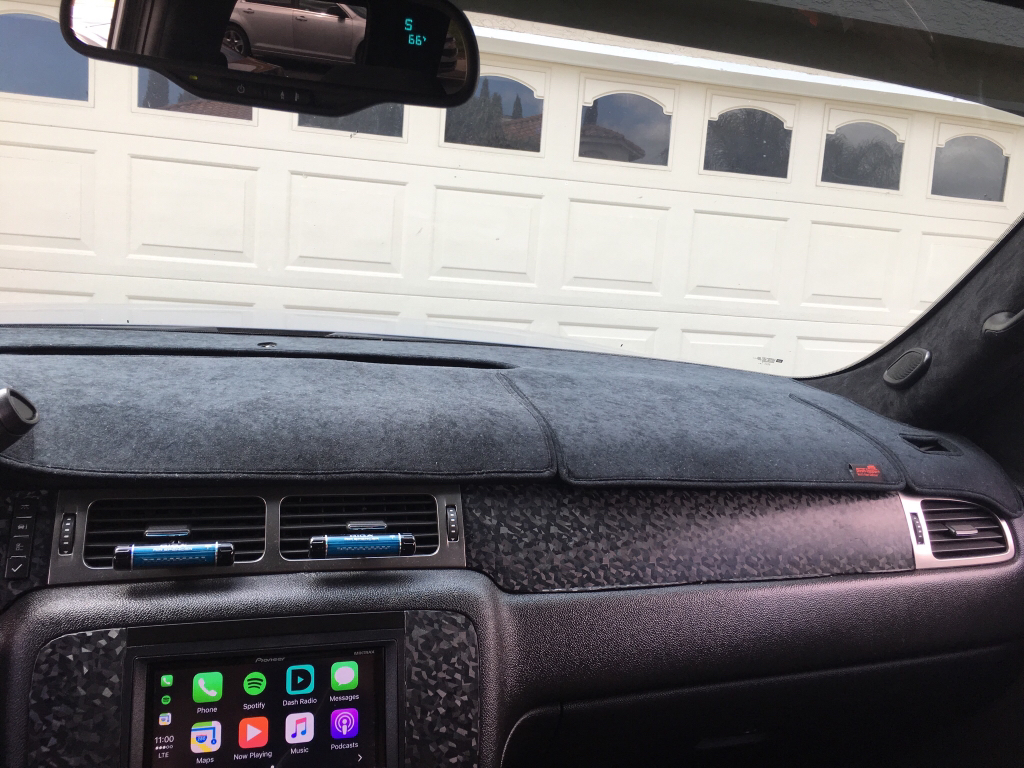

i just put a dash mat on top of the dash to cover the crack and its good to go

I've been looking at this as an option. Every time I look at the dash, I feel like there's a new crack. They have it on eBay for $148 plus $30 for shipping. There's also one where it only cover the top. Just search dash cap or plastic skin cover.
Idk I feel with those dash caps once it's on you'll be able to tell the dash really has a cap on it because of the fitment with all the other dash trim..
I agree, but I guess it's better than nothing. I think it looks a bit better than those carpet covers.
