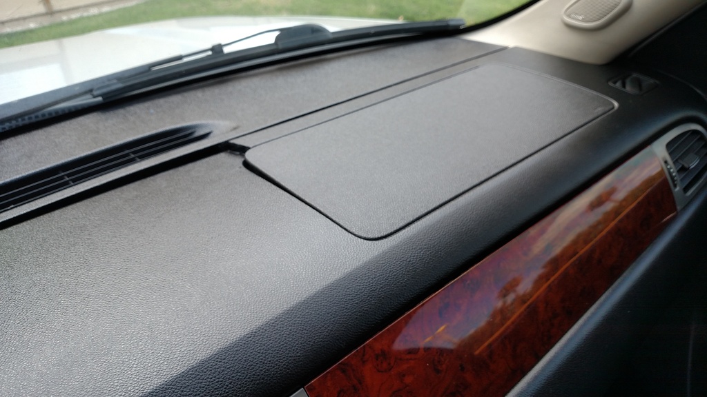

started off as a little crack and now its starting to sag FML

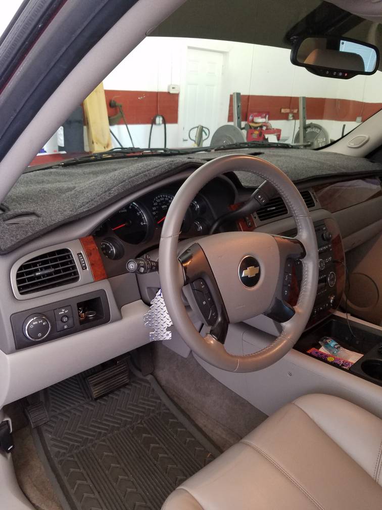

Here you go. Better than a cracked up dash. Only wish it was a little lighter in color
