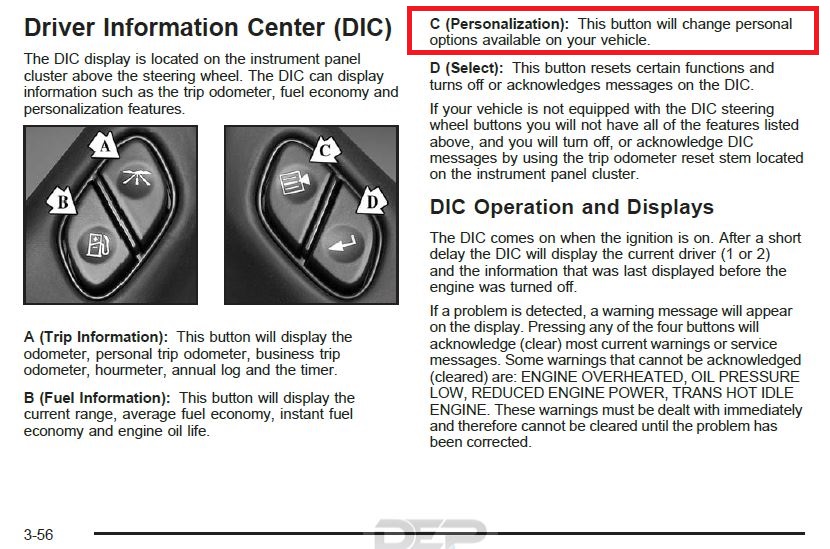

Tell us what year you have, and download your owner's manual from the GM site.
If you have the DIC and steering wheel controls, the manual shows this:

The vehicle in question is an '05 Avalanche with steering wheel controls.
