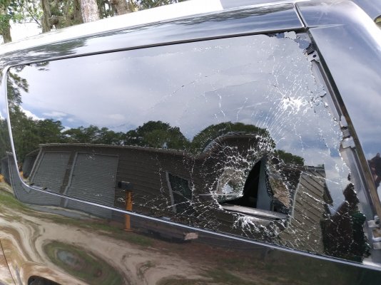

Someone a-hole decided to throw sonething through my long rear window on my driver's side (haven't figured out what yet). What are my options to replace this and about how much is this going to cost (gulp) It's tinted as well, but I guess I will worry about that later. :(
Please help. Thank you

Go to an auto glass shop unless you’re experienced in urethane glass installation. It’s not easy like old school rigs. It’s installed the same way as your windshield, glued in with structural urethane.

It’s not like a windshield in the respect that there’s no sensors or anything that need to be recalibrated so any local auto glass shop should be fine, Safelite or others. Safelite is more expensive around here, I use small shops and get a better price. As far as insurance, I have no idea what the cost is so I would call a few shops or even look online, some places let you get a quote that way. Get 2-3 quotes and then decide if it’s worth filing a claim.
