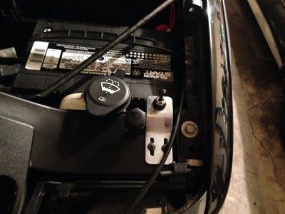

Where’d you guys mount your hood pin switch, putting one in for some under hood lights and just want to see where you guys put yours for remote start etc.

I mounted mine on that curved metal fender brace that bolts to the fender and to the wiper cowl. Just pay attention if you mount it there, I messed up and drilled a hole to mount it, but it lined up DIRECTLY with a hole in the hood, so it didn't press the switch down. I had to move it and now I have an extra hole drilled in my brace. DOH!

Thanks for the responses, definitely have options on where to put it.
